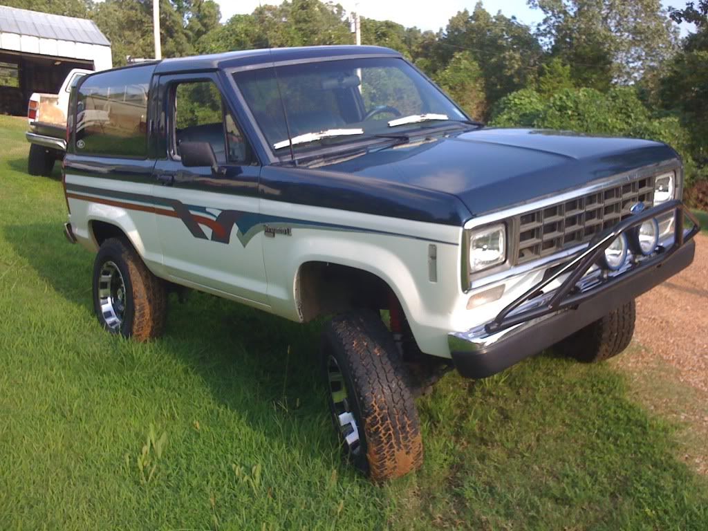

Mall Crawler Right? Gotta have a mall pic...

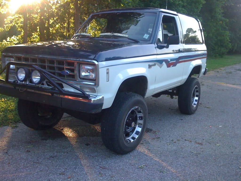

Poser Pic for a game on another forum before hitting the trails:

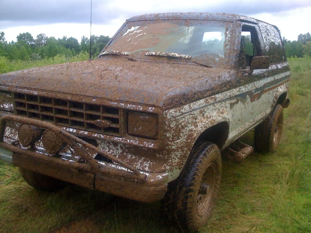

then we hit trails...

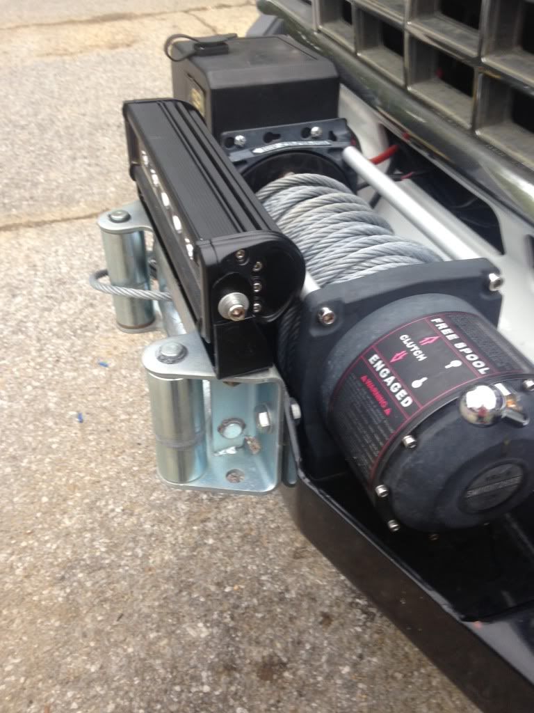

SSR-10" Installed on Winch Fair Roller

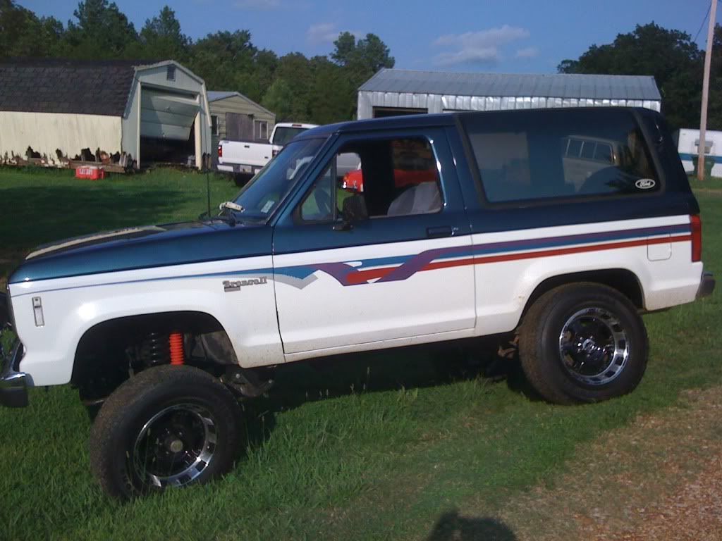

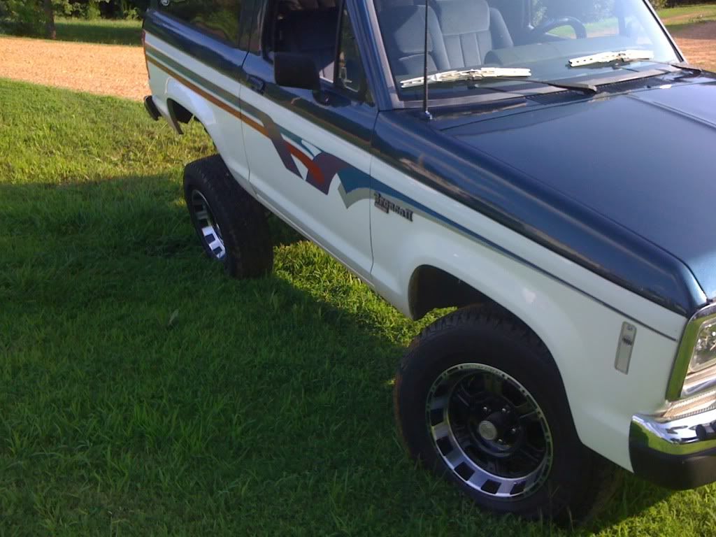

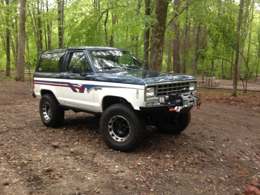

my love for the b2 started when my dad had an 86 when i was YOUNG, well it burnt due to an electrical fire. he replaced it with this 88. when he bought a ford f150 he sold it to my uncle. when i was 13 or 14 we bought it back for me, paid $500 for it. the trans was messed up. i'll try to dig up some pics of when we bought it. it had a custom paint job then, but all stock with the 2.9 and all. first lift was a homemade 2 inch body lift, when i could afford the RC i took the body lift out. Any pics with the EX's bullet hole rims are the stage one of my personal build with the body lift and others..
let me know your comments, no matter how big or small.
