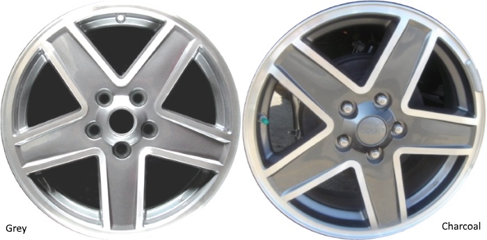

The offsets seem a bit too "flat" to me, but Jeep Patriots had the proper 5 x114.3 bolt circle too:
I agree with your opinion there.

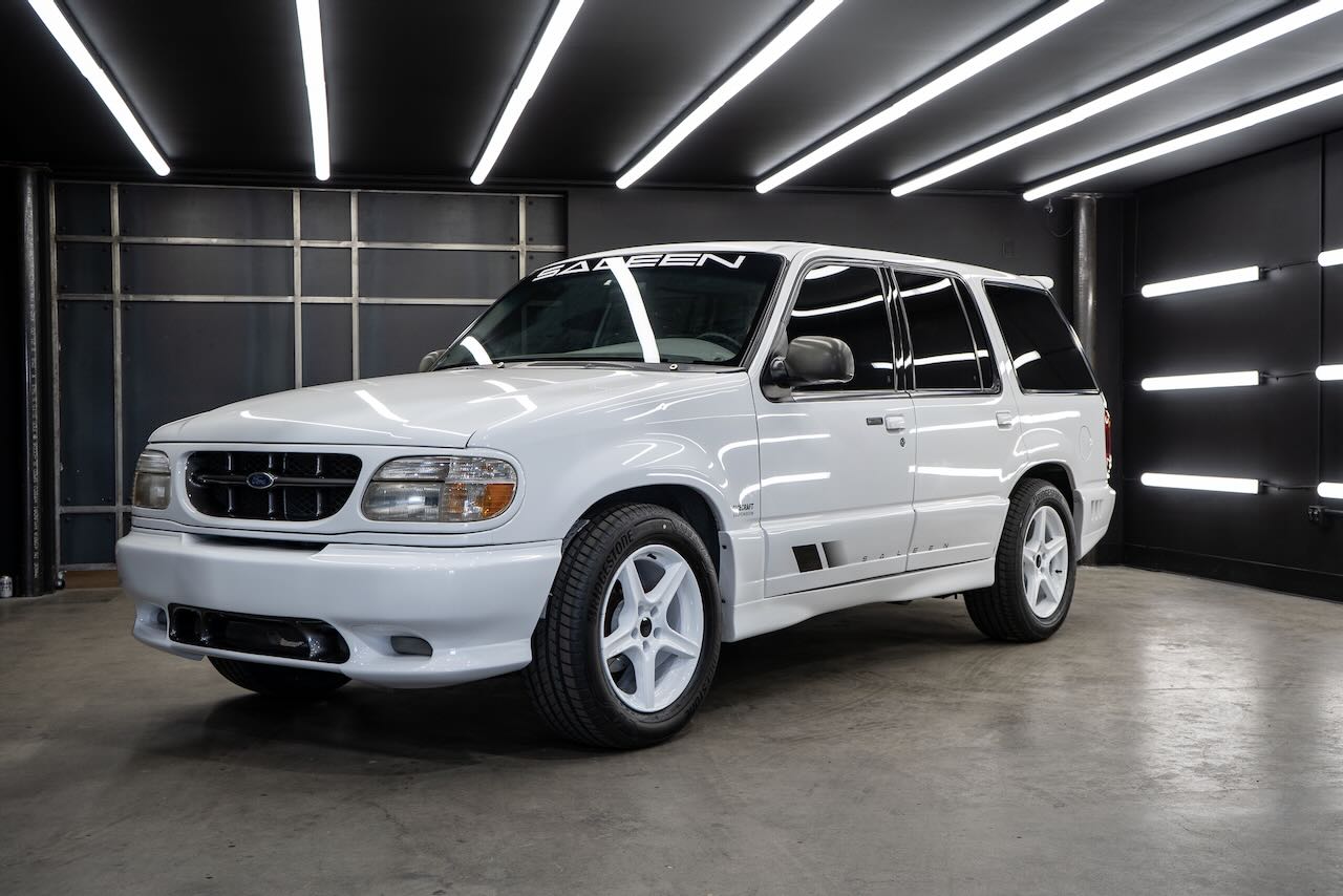

For transparency, another of the inspriration vehicles formy build is the Saleen XP8. Those were lowered slightly (1-2" from stock) and wearing 18" Saleen wheels with 255/55R18 tires (about 29" diameter). Of course, those originally came with aftermarket 4 pot calipers and larger rotors to fill that wheel opening, where my truck will eventually get the "sport trac" upgrade when it needs brakes again. And a photo for reference:
