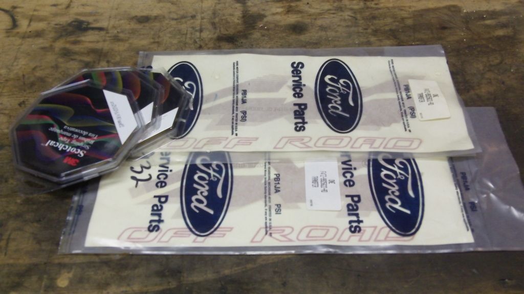

Already collected are new fenders, bumper, & door pins from Jeff's Bronco Graveyard, lund visor, spare tire cover, 4x4 Off Road decals ($70 each direct from Ford and I almost cried), and pinstriping. Ford OEM pinstriping has long since been discontinued but 3M makes a large variety of sizes and colors. The closest match for the high double stripe is 3/16" Elite Tan (72017). The lower one has to be made from 2 stripes: 1/4" Bright Gold (72699) and 1/2" Bright Gold (72799). They come in 150' rolls so I'll have extra in case the truck needs bodywork in the future. (edit: The 1/2" striping could not make the turns around the wheels so I ended up using 1/4" for both.)
The 4x4 Off Road and Eddie Bauer decals actually aren't stock per the original sales brochure (they were added by a previous owner) but I like them so much that they'll be incorporated into the restoration. I would highly recommend that anyone interested in restoring their B2 try to source a sales brochure. It's got loads of useful information like color swatches, factory options, etc.

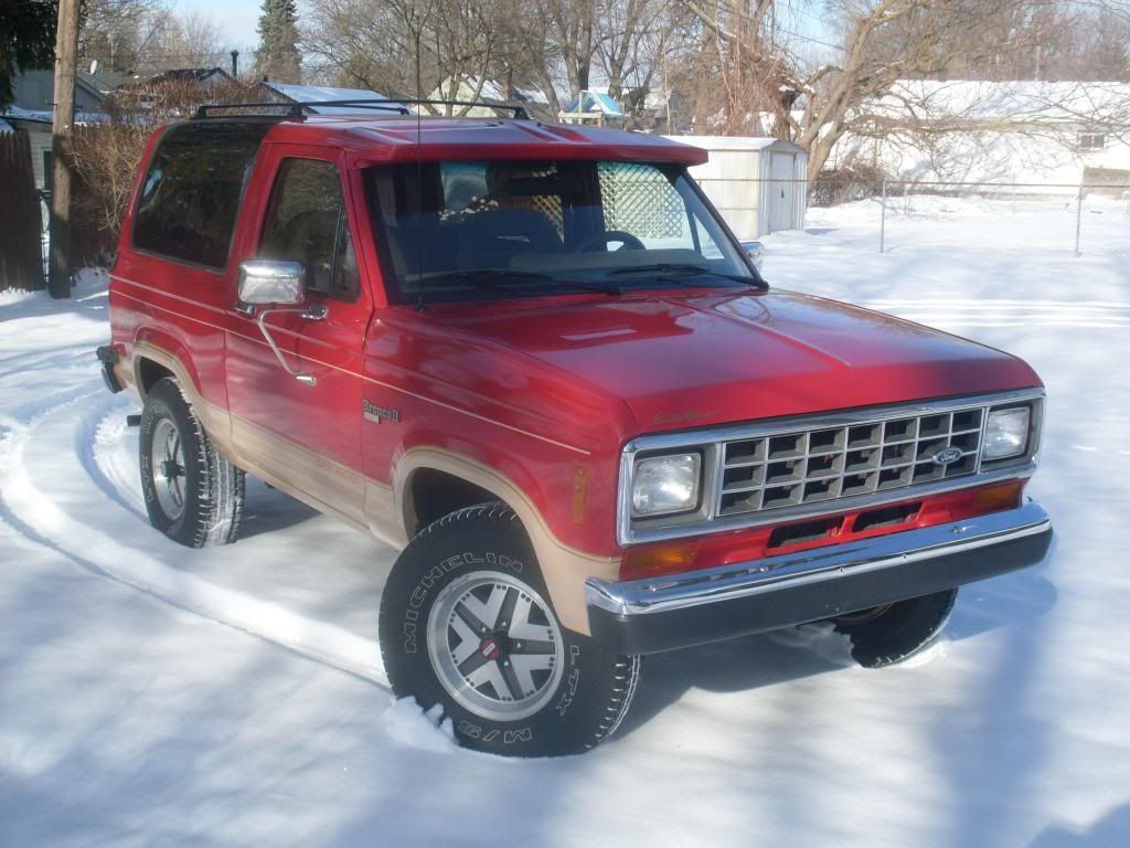

Update: 6 months later and it's all finished!
Here's the list of what I did:
- Complete body restoration
- New bumper and fenders from Jeff's Bronco Graveyard
- New emblems/decals/pinstriping
- Added Lund Visor
- Added luggage rack
- Fuel sending unit
- Battery
- Trailer wiring package
- Reconditioned interior
- Rebuilt original driver seat
- Pioneer sound system

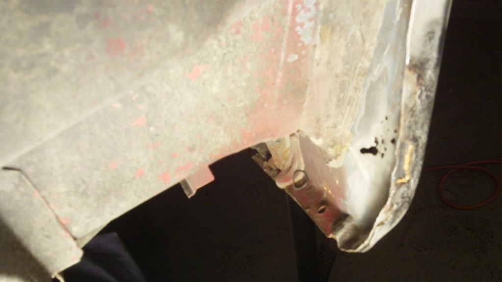

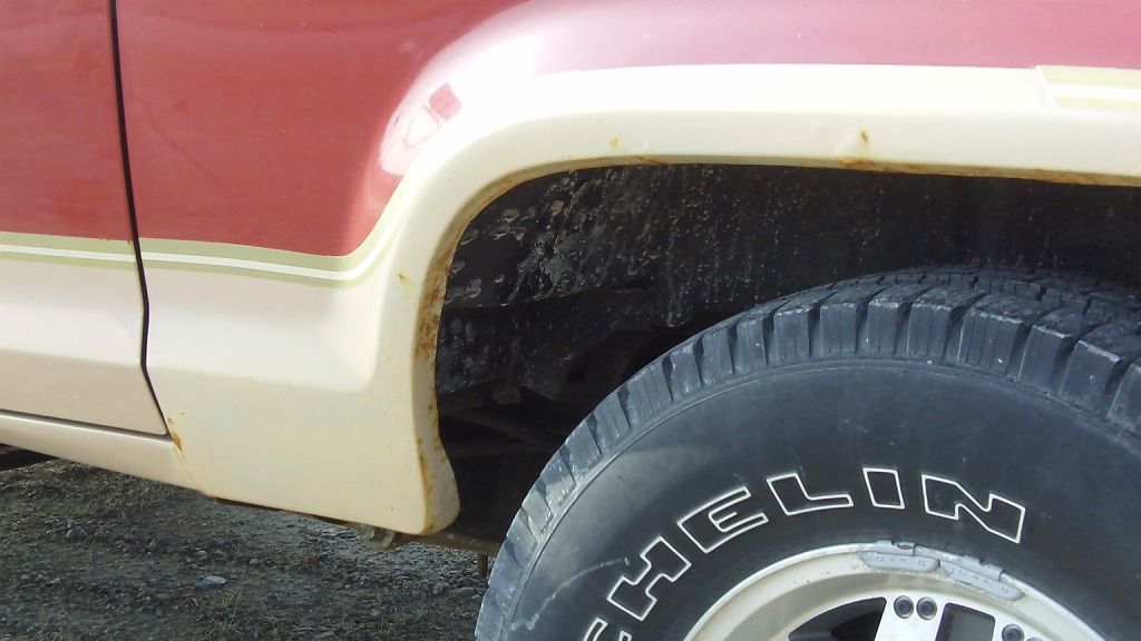

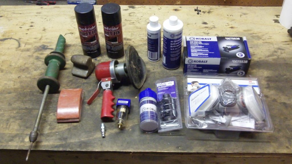

2nd installment: New tools! I went out yesterday and bought a die grinder, sanding discs, respirator, in-line air filter, and some other misc tools that will be needed. The used tools shown I borrowed from my dad and haven't been used since he was younger than I am now! Their last project was the family's gen1 Dodge Caravan if that helps date it. Anyway they're free and every bit helps.

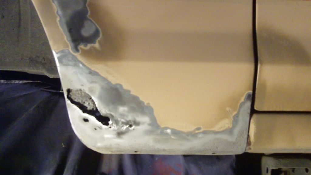

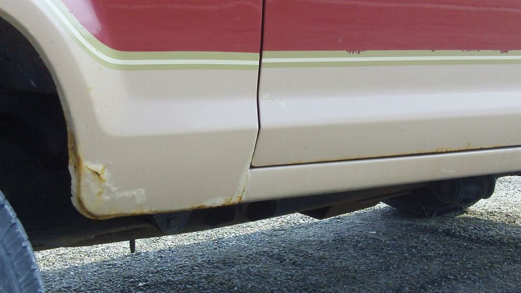

All the pinstriping has been removed and the surface cleaned with goo-gone and I was able to remove the rust from the rear passenger side wheel well's front area. The sand blaster works magic on rust but not so much on stripping paint which is where the die grinder really comes in handy.

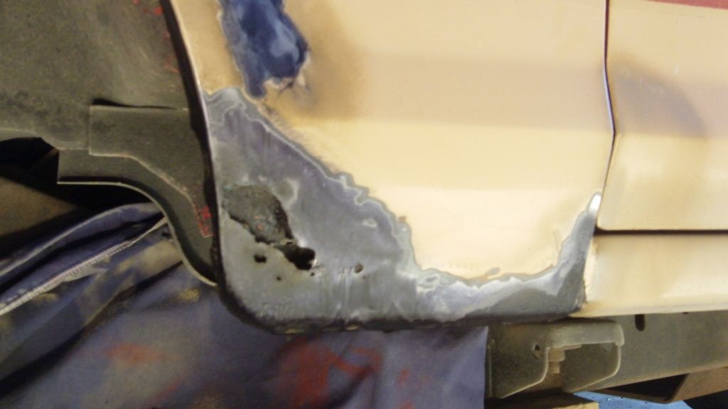

I think I'm still in a bit of denial that I'll need to have a shop weld in some new panels. I would REALLY prefer to use fiberglass/resin and fiber reinforced filler. Doing it right is important though and the general rule is if there's a hole it's got to be cut out, right? Thoughts welcome as I'm still a bit undecided.
Here's a shot of the area sprayed with "Duplicolor Rust Fix". I'll be making my way around the body removing the rust and spraying this to protect the bare surfaces as I go. Once done I'll sand it smooth to prep for the surface filler.
Thanks guys for the comments. Keep em comin! Just a warning too, I work SLOW. I have a full time job and 10 month old twins that don't allow me much time in the garage.

Just remember to clean the back of the panel up and apply the fiberglass mat there. Cut the mat, hold it in place, and apply the resin with a brush over the mat. If you apply it to the outside you'll end up building up the surface and it'll be noticeable. Tap those edges in so and it will allow the bondo-glass (filler with strands of fiberglass in it that you'll apply to the outside to fill in the spot) to overlay the metal so it sticks, but not bulge out from the surface. Sort of like filling in the low spot from a dent. The final coat should be a thin coat of regular filler to smooth it all out.
Here you can see where I applied it to the back side:
Used Bondo-Glass on the front side:
Added regular filler:
Sanded with a long sanding board:
You can see in the lower right of the panel in that last pic where it still needed a little more filler.
Remember, if you apply regular filler more than 1/8" thick, it may crack over time.
