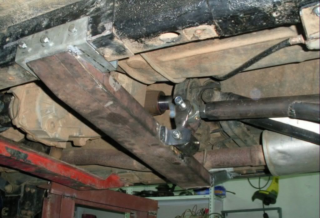

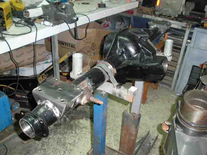

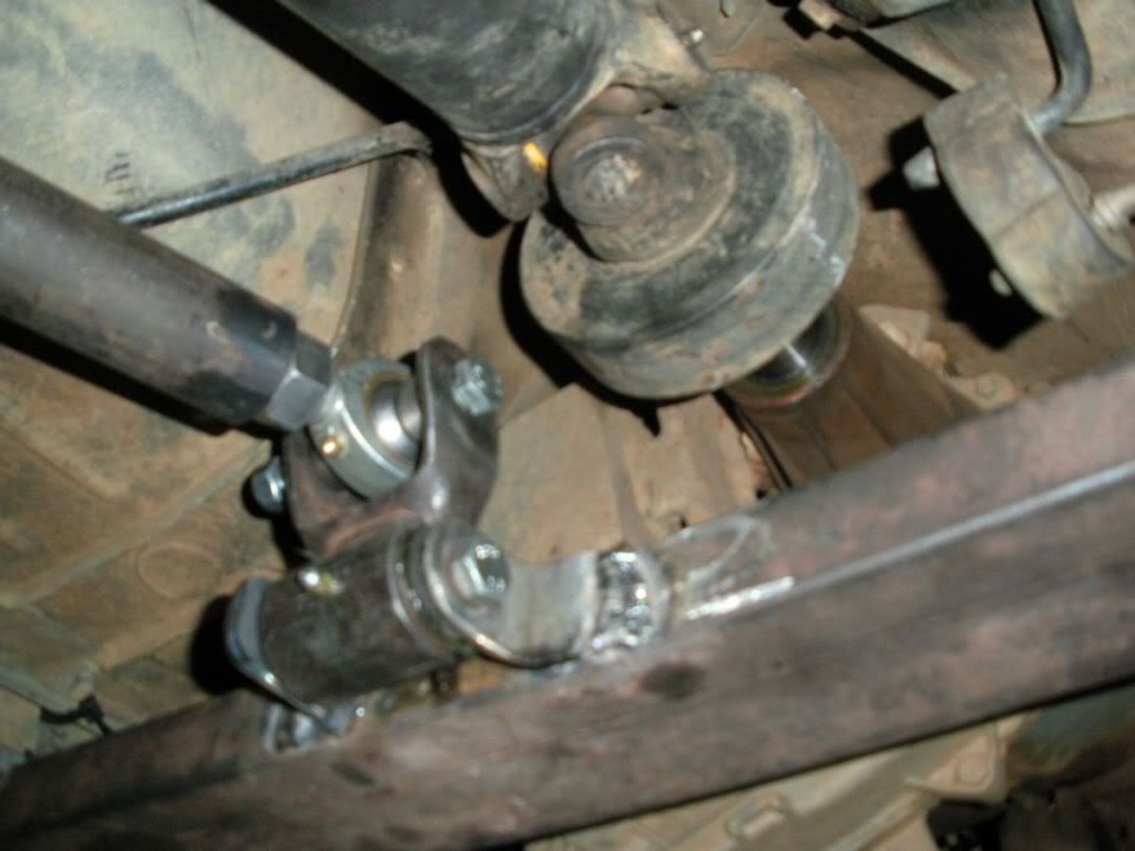

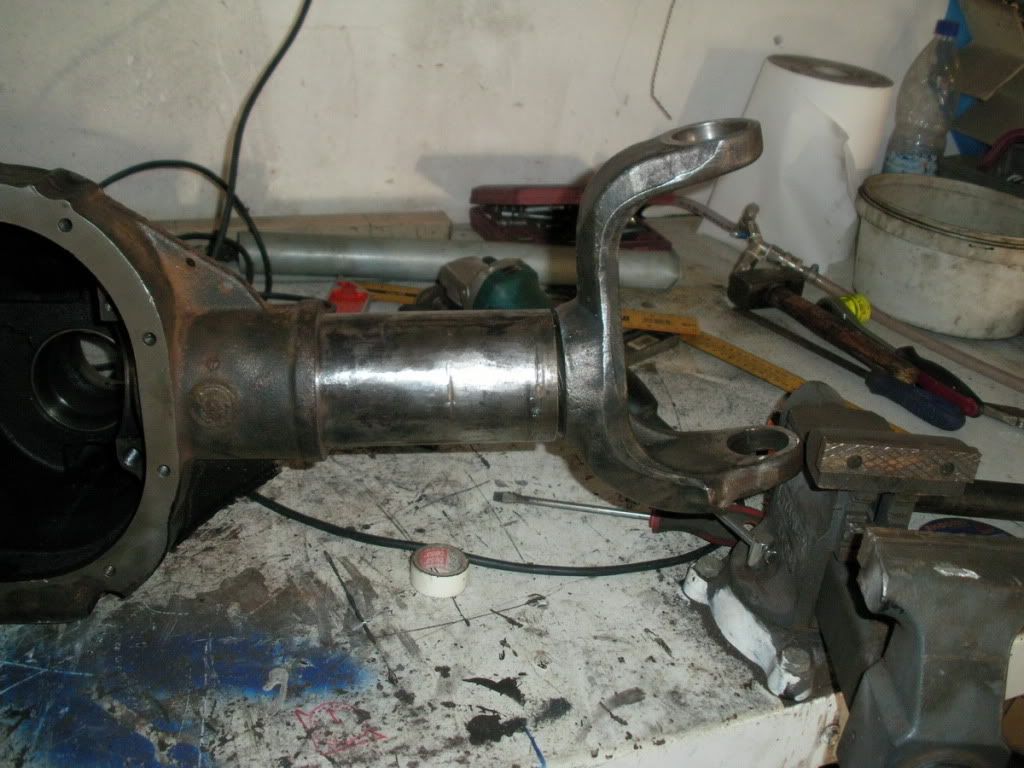

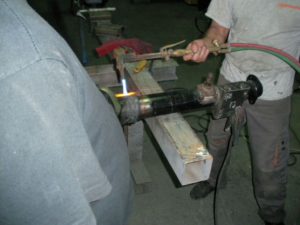

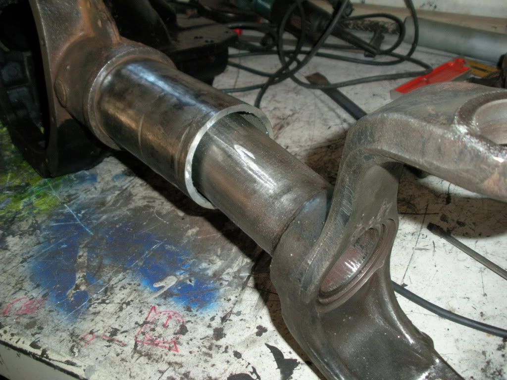

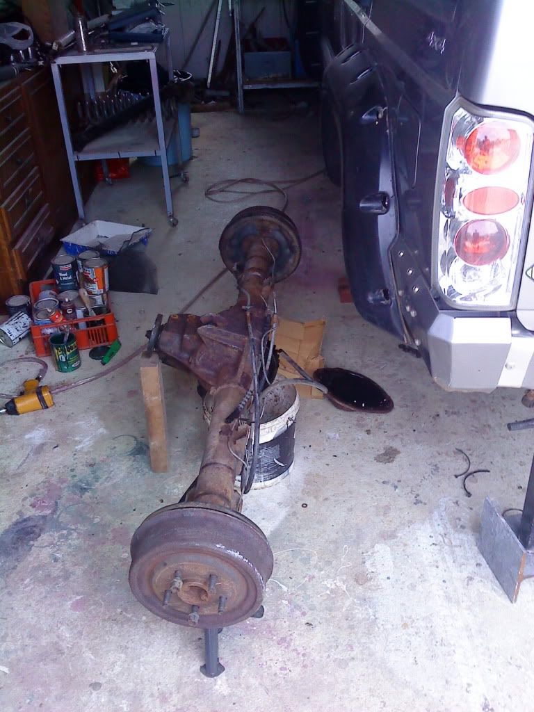

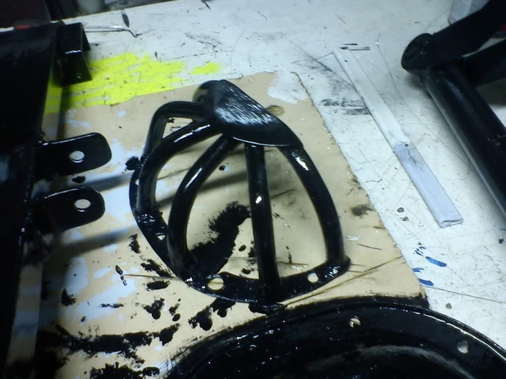

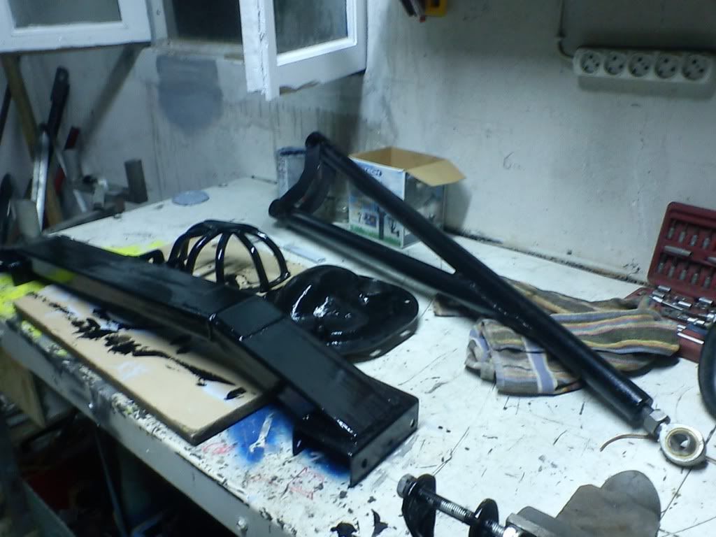

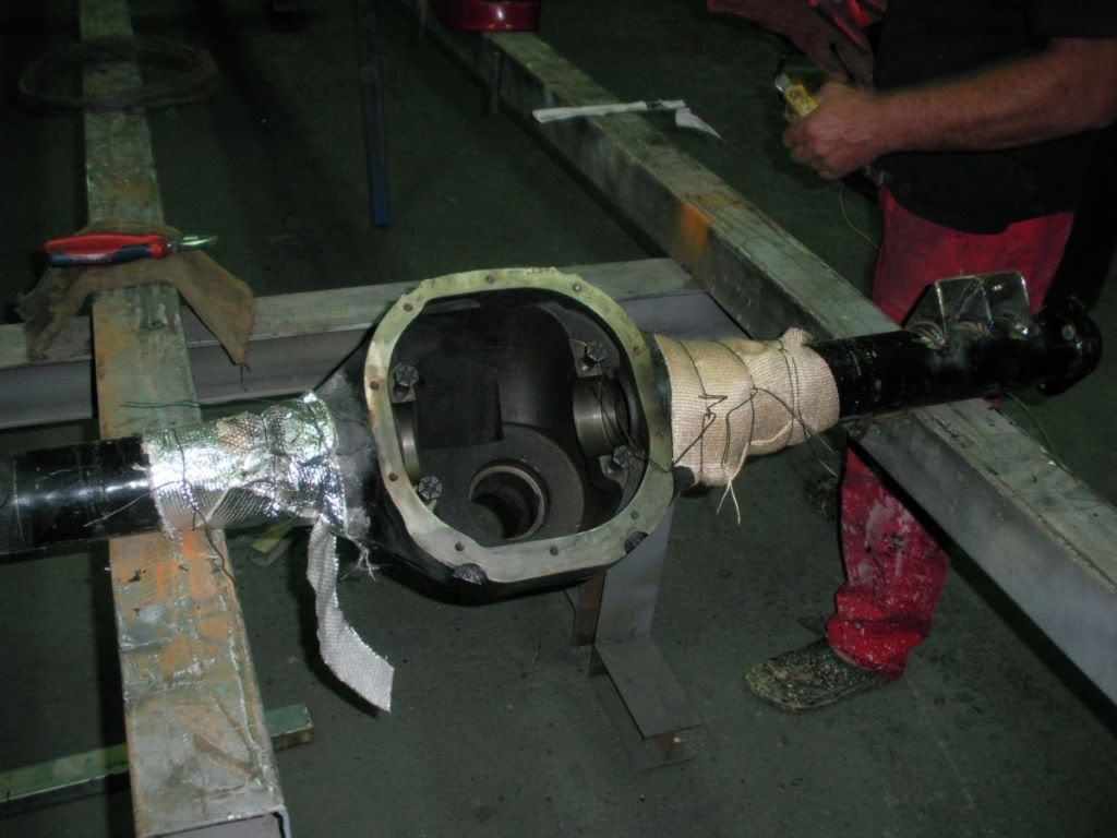

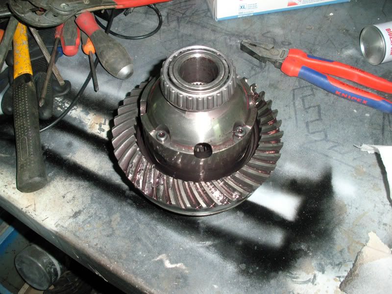

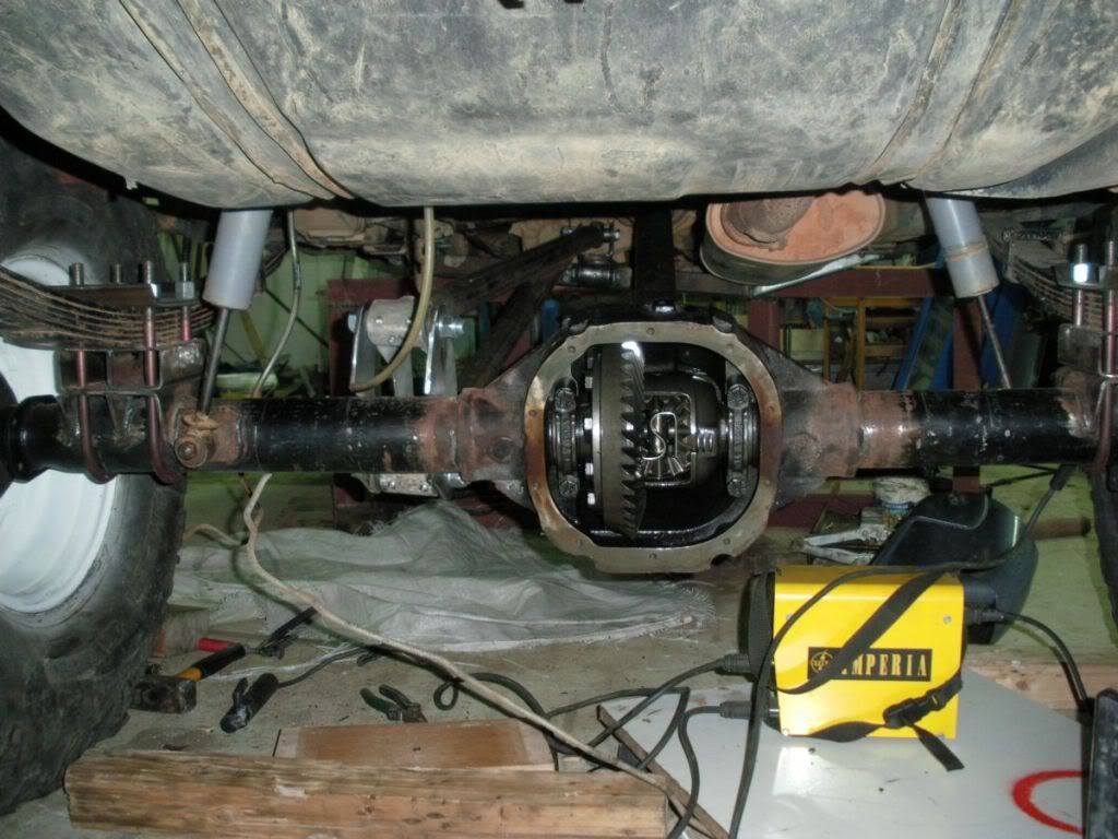

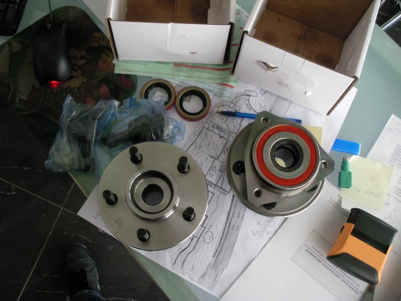

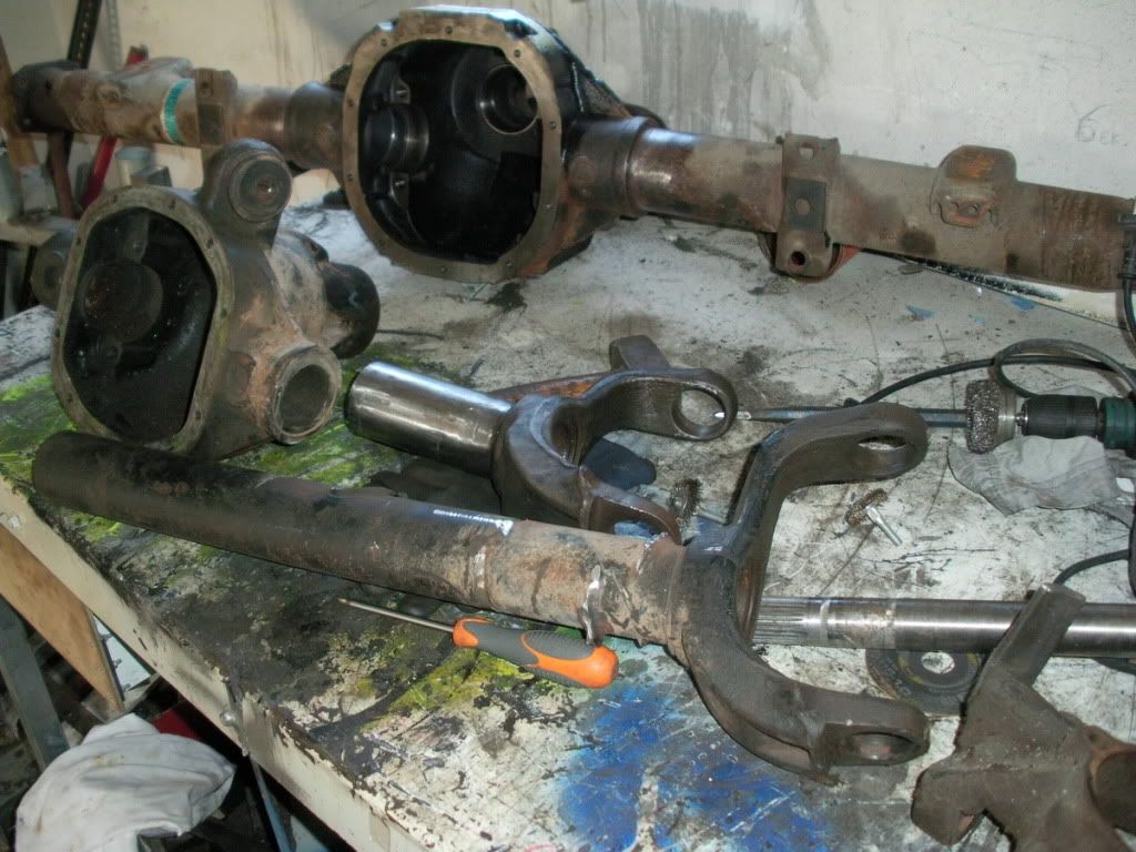

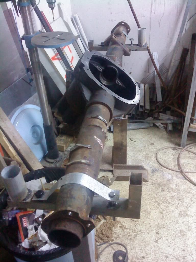

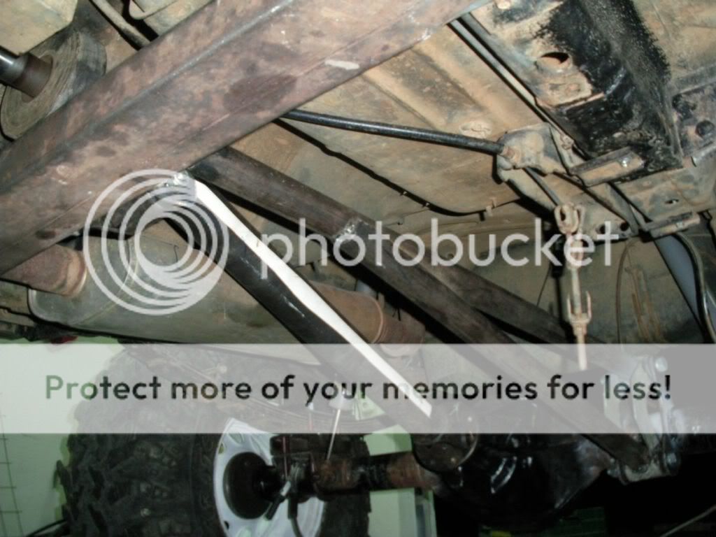

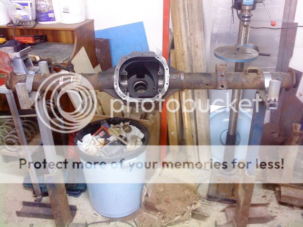

i'dd like your opinion on my build for a hybrid front axle matching together a D30 with an F8.8

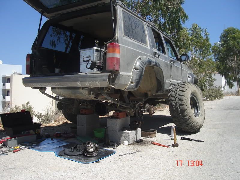

I have a jeep cherokee xj 2001 diesel.
rubicon express suspension 5,5" modified by me and now is up to allmost 9"

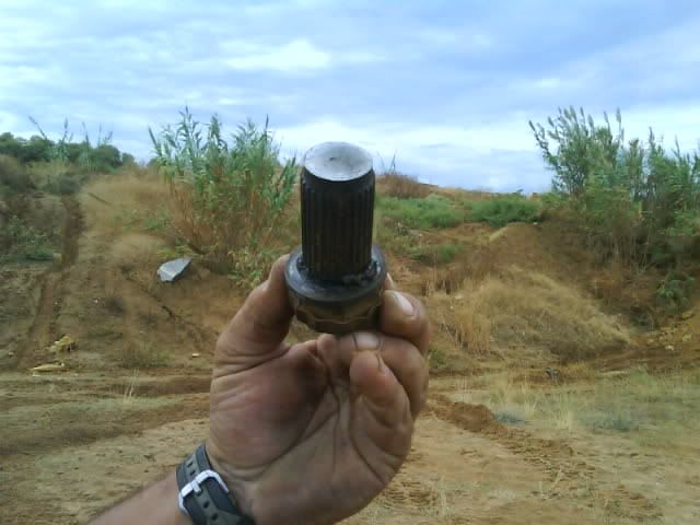

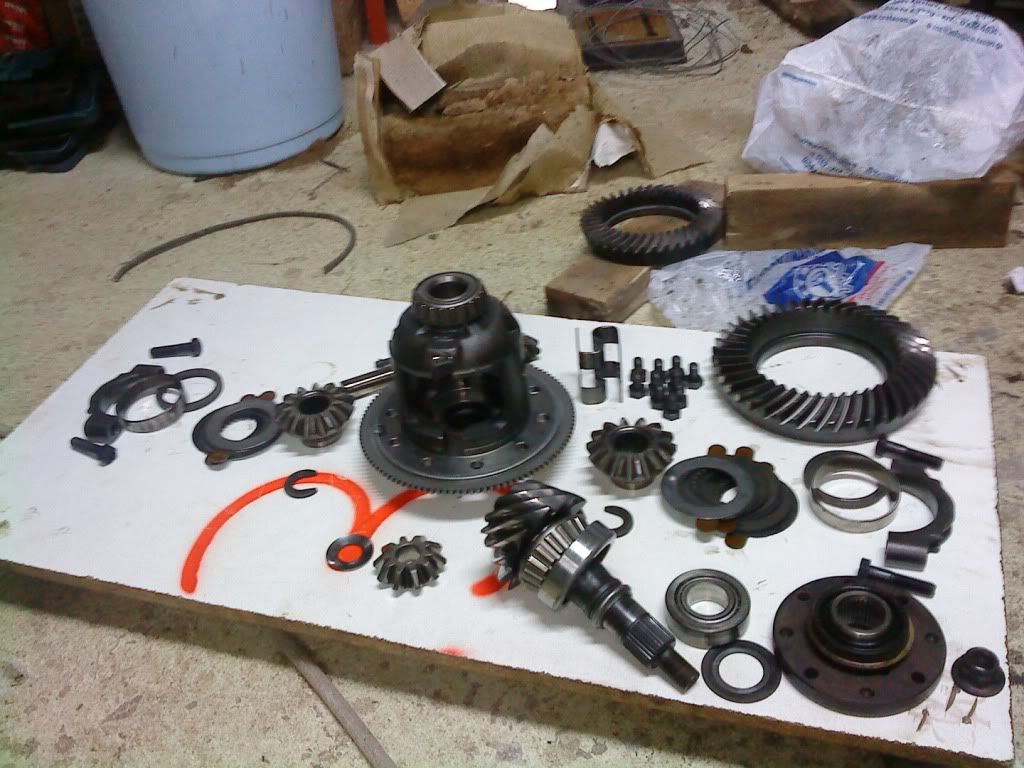

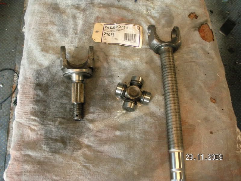

from 2007 until now i have a big collection of broken chromoly axleshafts, yukon and superior. broken crown pinions yukon, superior, motive gear, genuine gear and nitro. broken ball joints spicer, moog. and a bag full of broken u-joints:D

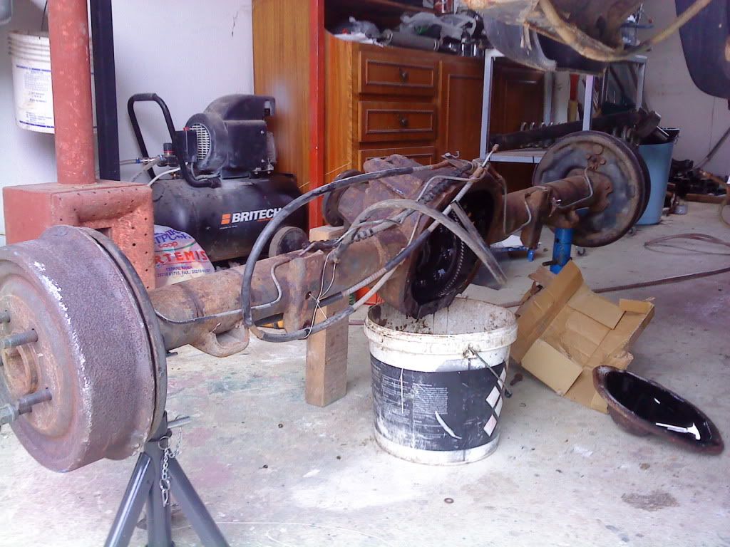

for the story, i have to tell you that Ford Explorers was never on the Greek market. Thats why it was extremely hard to find a ford8.8 . anyway, i bought an F8.8 from a smashed explorer that i found here in Greece and i used it as a rear axle. Then i bought another F8.8 which i found in Germany (european market, no customs).
For my hybrid front axle, i use the housing of the F8.8. the outer c's are from a cherokee Dana30 and the outer knuckles are from a Grand Cherokee WJ.

and some pictures of the axle (so far)
By antonisxj2011 at 2011-09-22

I like the idea you have but the problem I see is if you put that 8.8 in the front the gear rotation is wrong.
no problem with this.
even and with the pinion bearings lubrication issue, there is no problem.
the main thing that worries me is if RCV performance is willing to make the custom axleshafts that i need.

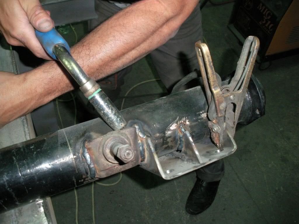

I didn't ask for your life story, just answer the question!
What is your plan for axle seals on the hybrid front axle?
if you see the 8th picture, i made some space in the new tube that fits about 10 gaskets of 60milimeter diameter:D (no more leaks).
the thing is that only the last gasket which will be lubricated, will work properly. the rest of the gasket will be "burned" and work as a mud goalkeeper:D
at the outer C's i will make two tube seals to my friend lathe, like i did in the past
