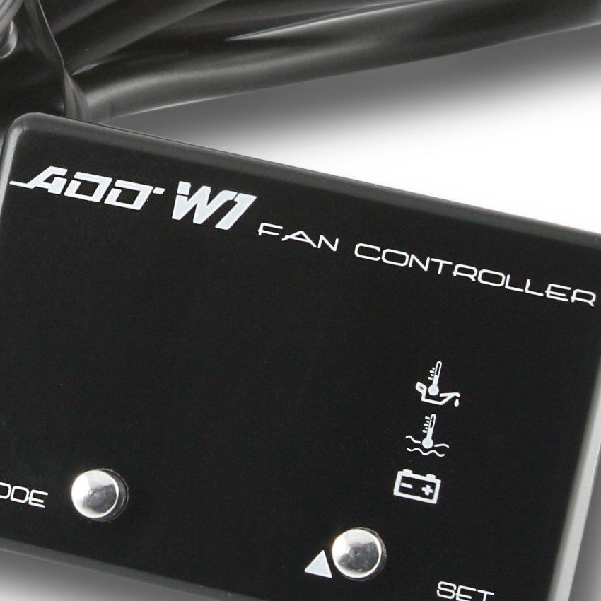

looks like a decent package. that is essentially what i use for controller. just runs lincoln intech fans.
