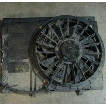

I've been using the Volvo fans for years--probably made by Spal. 740s, 850s etc. and some later models have them. make sure to get as much of the wiring as possible and the relay.

I've been using the Volvo fans for years--probably made by Spal. 740s, 850s etc. and some later models have them. make sure to get as much of the wiring as possible and the relay.View attachment 94966
How difficult is it to install?

I use the VW dual temp sensor as described in the article I linked. The cheapest way to get all of the parts is from the junk yard. The Taurus fan works the same way, just pulls a little more air, but I have not yet heard of anyone who used the Volvo fan and did not have adequate cooling.
Even if you want to connect a manual on/off switch in the cab, you still want the relay. You wire the on/off switch to the relay and only run the high current from the battery through the relay to the fan motor. If you only want one speed, you can just wire it to run on high speed, or you can get a fan from most any front wheel drive vehicle, because most of them only run one speed.
