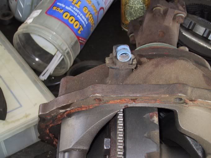

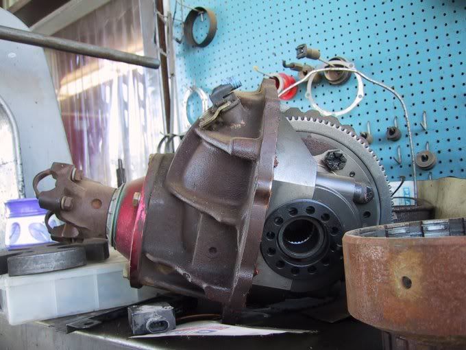

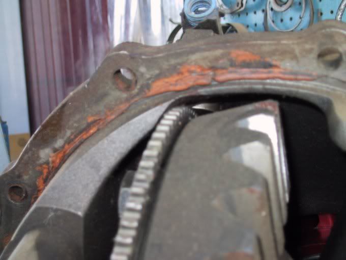

the tone ring can be put in to the 9inch. I know a few people that can/will do it.One of the problems most dont like about it, is that you have to take some meat out of the 3rd member.Alot of the camaro/firebird drag racers do this when they swap in 9's.
what most do is remote mount the sensor. curt leduc, california pre fun(google it) has a kit for the full size broncs f150 may have one for the ranger as well.
brea auto electric (google it) also has a kit.
Cant rember if it was on dezertrangers.com or race-dezert.com was a guy using a sprocket with the right amont of teeth and spacing off the drive shaft. search "tone ring" on both those boards and I bet you will find it.
heres a link to get you on the right track.
http://www.fullsizebronco.com/forum/showthread.php?t=146744
