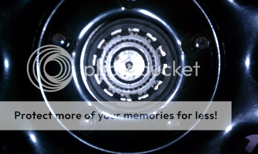

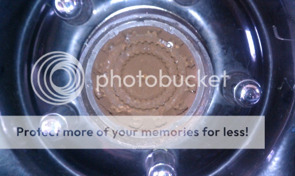

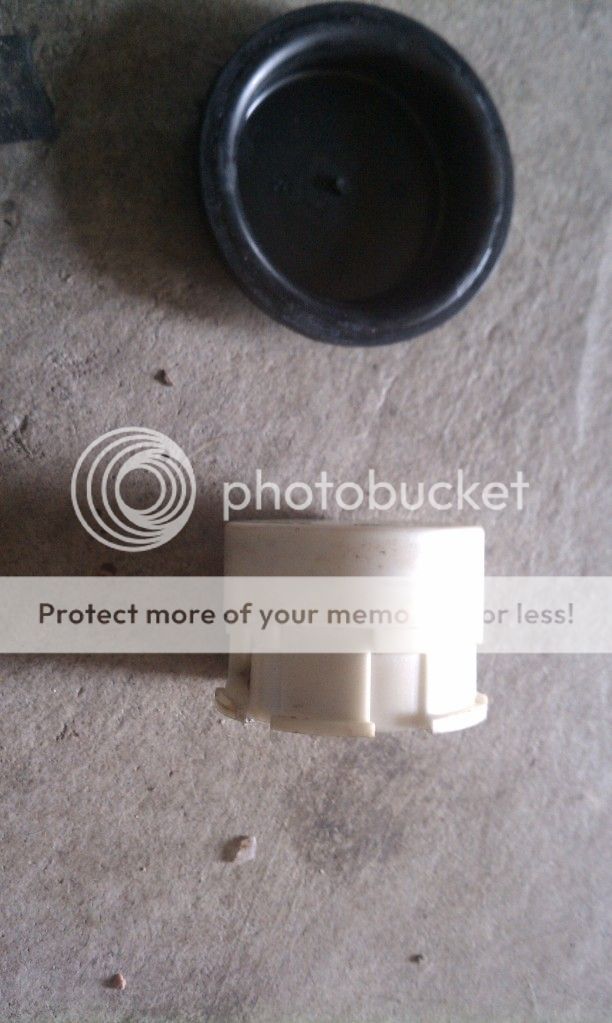

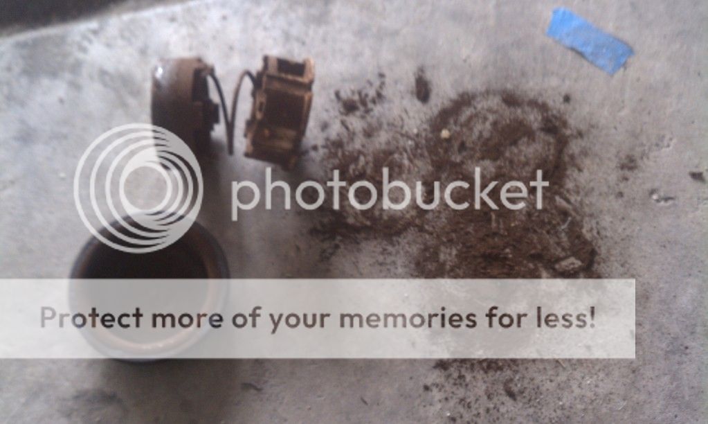

I just noticed today while driving an intermittent grinding noise coming from the front right wheel. The faster I go the faster the grinding, and vise versa when going slow. I got home and pulled off the hub and holy cow was there a lot of crap in there. I've cleaned this 3 times before but its never been this bad, so something is definitely wrong.
I got out my air compressor and sprayed air in the hub and there was a ton of dirt in there. Then I decided to take off the drivers side hub and it was perfect!
So after spraying out the passenger side I put it all back together and drove around and the noise is still there. I would test to see if it makes the noise in 4x4 but it doesn't work and I'm thinking this may be why. I'm at a loss, help me please!

The excessive dirt intrusion suggests one or both of the O-ring seals has failed, meaning that even if hub wasn't fouled/jammed up with all that dirt, there wouldn't be any effective vacuum force to operate the hub in and out.
Check the Tech Library for the easy way to operate your hubs manually, should you need the 4WD functionality.
I've never had that noise you describe, but have read here on TRS something about CV joint boot/clamp scraping on steering knuckle...??
If noise increases when turning left (higher load) or decreases when turning right (less loading), then it's probably the sealed/UNserviceable (pricey) wheel bearing/hub assembly "big enchilada"s.
Include more details about total mileage, etc.
I'm about to undertake the 4WD-PVH "tune-up"... let you know what I learn.

Hey thanks for the reply. It turned out to be the wheel bearing, and like you said I was unable to fix it my self haha. I was only 3 rusty, lock tited bolts away from getting it off, (no air tools) so I had to take it in. I did the manual hubs conversion awhile ago but my 4x4 still is broken and I rebuilt my shift motor and I don't know what it is so I'm just going to put a manual T-Case in. But let me know how your PVH tune up goes.
