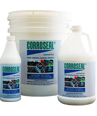

Corroseal Rust Converter/Primer - Rodda Paint
Corroseal Rust Converter/Primer is an industrial strength product for all your marine, household, automotive, and industrial rust problems.
Read the website if you want the official spiel.. but the short of it is this:
Corroseal Is a water based non-corrosive rust converter & encapsulator that can be brushed or sprayed on.
Super easy to use, simple prep.
Knock off any loose rust, clean of any dust/oil, apply, watch dry, enjoy. Once it's dry, you'll be left with an extremely tough black coating.
The company claims it doesn't require topcoating for long lasting protection (and I believe them), but if you feel like spraying something over the top they reccomend something oil based.
