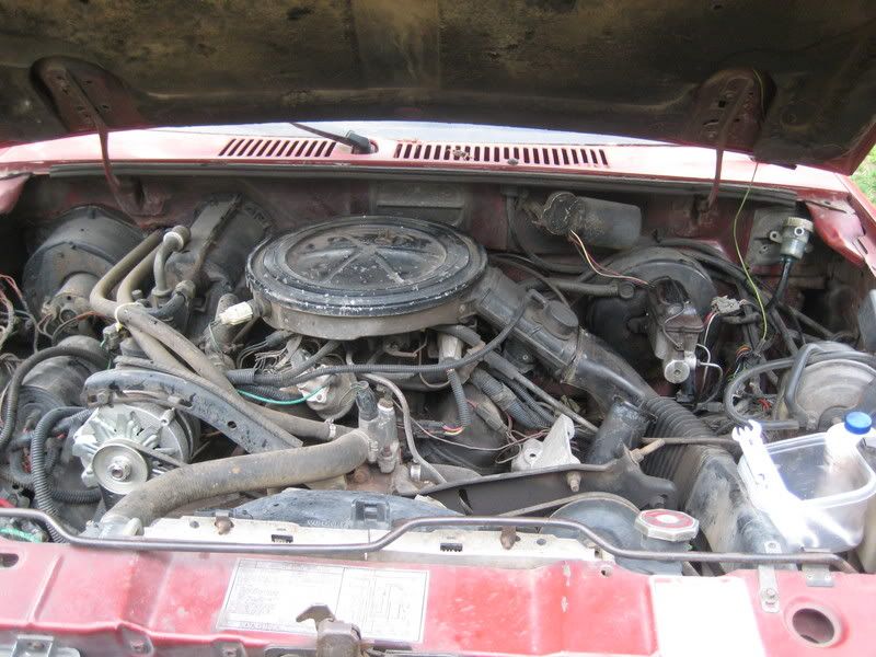

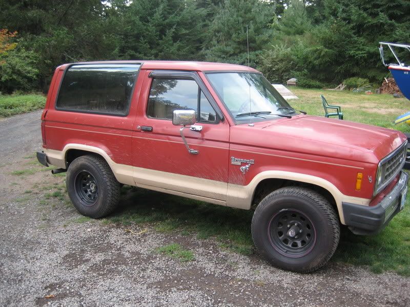

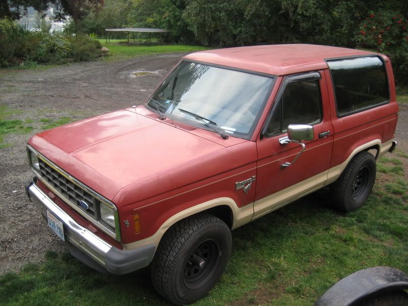

We picked up the bronco today for $200. It had a bad starter solenoid and some funky electrical. Its an 86 Eddia Bauer with the 2.8 and a 5spd with 3.73 L/S. Its almost 100% straight and rust free. One hell of a deal.

If it has a 2.8 from the factory it is an '85, and yours does have a 2.8. Now 20+ years later it is hard to guess who swapped what for what reason however.
That is a nice find, that would make a great dd/wheeler as it is, I hope there are no VW plans with this truck???

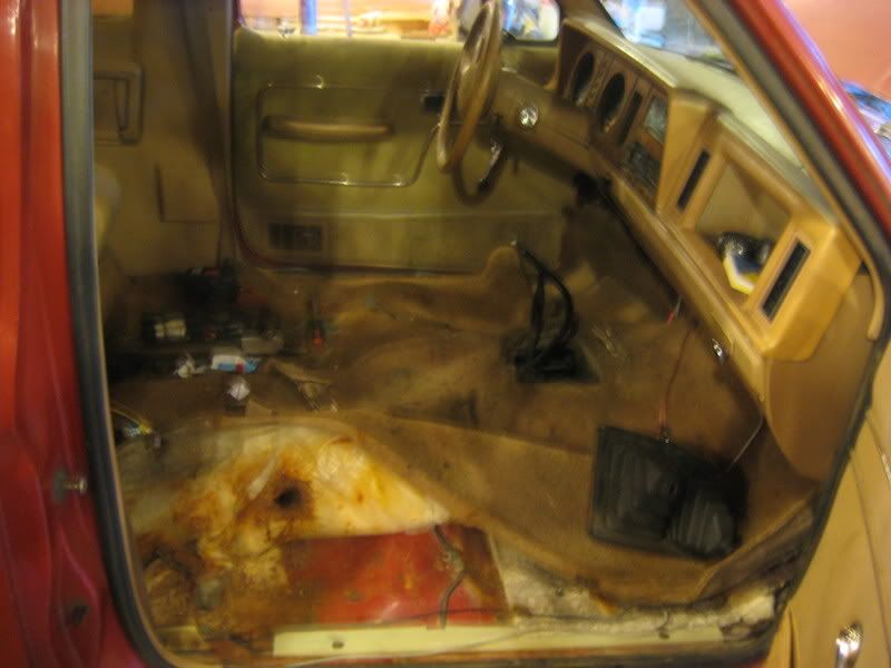

Its also got some kind of funky electrical....wipers will come on, but not shut off, blinker worked, but now don't and neither do the brake lights.... So we'll be keeping the bug's electrical for all that.

Word of warning, VW's have fairly weird wiring setups. My brother has a '68, the windshield washer pump is driven by the spare tire pressure (tire is kept in the front) from the factory and strange stuff like that. They also have a pathetic heating system that runs air thru heat exchangers and attempts to pump it into the passenger compartment, I don't know how you would get a RBV heating system to work with this setup if you wanted to.
I would also Duraspark that 2.8, it would really simplify things up there as your engine compartment will be getting alot smaller. Keeping it cool will be something else to work out, VWs are aircooled with the engine in the rear so there is no way for air to get thru the front for your 2.8.
Aside from outside looks a BII is a much better 4x4, longer doors with more glass area and a lower beltline make them easier to get in and see what is going on, more room in the back for either passengers or cargo and soforth. Bugs are a nice car, reliable as a hammer and get good milage (bro gets 45+ with his) but they are borderline claustraphobic for me driving around in one, I can't imagine trying to wheel one at low speed and keep track of what all is going on around it.
Just some thoughts I had, my bro had a magizine that someone plopped a 460 in their bug for a drag car, so about anything is possible with them. If it was a typical $200 BII I would say go for it, but heck if you fix the lights and wipers you could probably get a grand pretty easy out of it right now.

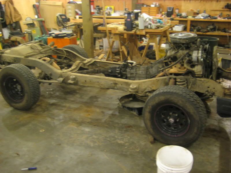

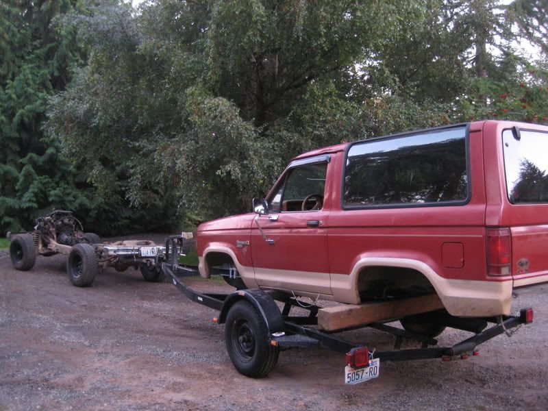

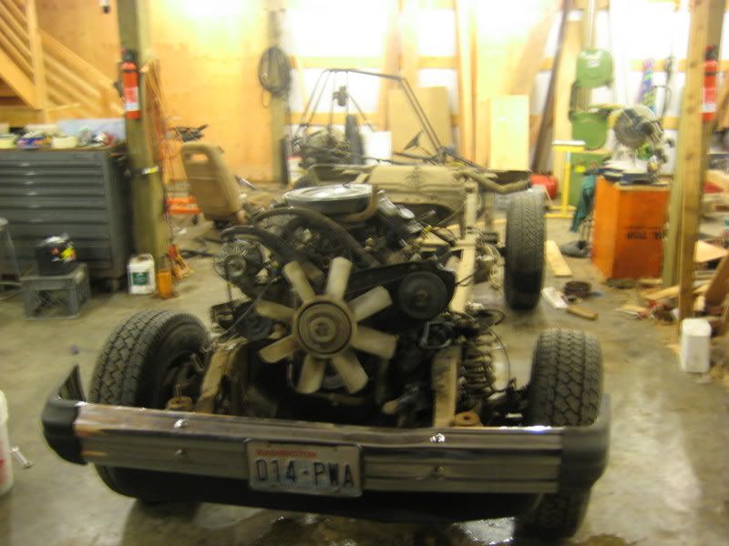

We got the body pulled off tonight in just over 2 hrs, and the frame rolled back into the shop. We spent most of the day trying to track down a VW pan and body. We've got a lead on one, with a bunch of baja goodies on it for $450. We may look at it tomorrow. I have pictures, but photobucket sucks usual so not right now.

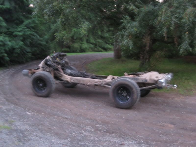

I have pics!
No that is not how we moved the body, just a funny pic.
