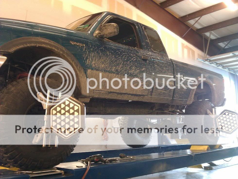

  • Alignment

I got the truck 5 years ago as a mess that worked, but not well. It's stayed relatively the same-looking externally, but it's a big change in performance, capability, reliability!!, and functionality. It didn't brake, had a horribly stiff ride, and wouldn't start.

I didn't drive my truck for 5 days, and the weather dropped about 10 degrees this weekend from a cold front. I come out to the Green Machine to see my tires leaning outwards. It was never like that before. I am wondering if the new ES9000 shocks, cooler weather, and sitting for 5 days raised the vehicle up? It's weird, and I've never seen this happen before. I'm not :icon_twisted:.
Positive camber:
Passenger Radius Arm:
Metal Radius Arm against Metal Bracket & Cycling Causes:
James Duff Bushings / Stock Rubber Bushings with torn/worn hole:
Replaced:
While I was down there, I switched out my coils.
Trailmaster Coil vs. Skyjacker Coil:
This morning:
THE VERDICT:
The Skyjacker coils are a significantly smoother ride on road, sucking up bumps and dips better. I am going to flex it later this week to see how it performs as well. Also, my tire wear is mostly on the outer shoulder of my tires, and are warm to touch as opposed to the inner being completely cold. When I turn a corner at 10 mph, it sounds like I'm doing a powerslide. :icon_rofl:
I noticed ~1.25"+ height increase, and slightly more positive camber (even though the picture doesn't look like it). The springs have settled a little bit from the 10 miles I've driven since last night (camber was really bad). My camber bolts cannot be adjusted any more, so it's time for new ones. I am taking it to get a full alignment today by a reputable performance shop with TTB knowledge.
The polyurethane James Duff bushing replacement has proved to be a more solid feel as well. The steering doesn't vibrate as much, and it's not a jarring ride anymore (from the combination of bushings & different coils). When the axle cycles, I can feel the difference in my steering wheel & seat being smoother. I have no experience using polypropylene material, but I'd strongly suggest using these polyurethane pieces. You'll like the solid feel better than the stock rubber (my last Ranger had good OEM rubber).
I will also retorque my nuts/connections later today.
Apparently, I lost a caliper bolt that attaches the bracket to the spindle. It's okay after a quick trip to Ford the following morning.
Penetrating oil was vital to removing/loosening the spring nuts & bolts to pull out the radius arm from the bracket. From all the mud and water, it has really rusted this stuff on.
I can't wait until I do the body mount bushings...
