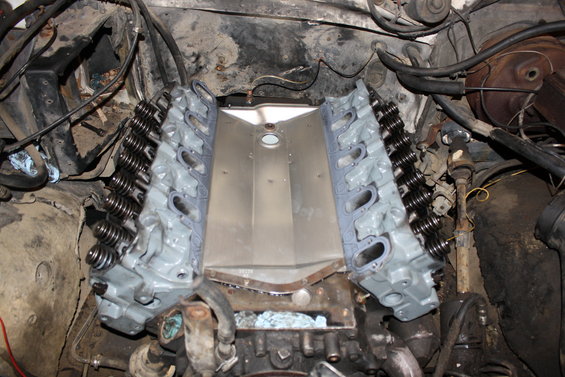

I tore the motor down to the block, cleaned everything.... That took nearly 2 days to do by myself. Finally ended up getting heads back on. I'm using the Fel-pro gaskets and ARP studs, over torqued 15lbs.
Also used Fel-pro manifold gasket and everything else. You can see the extra drain holes i punched in it.

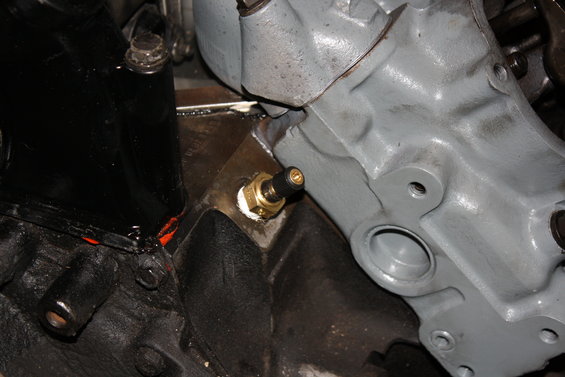

VDO water temp sender

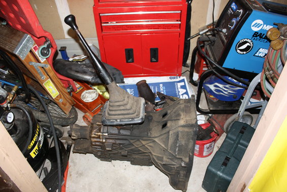

Trans in

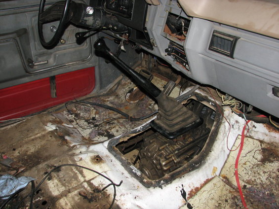

got some more work done today. Stripped the interior. Turns out there is a bit more rust in the rockers than I first thought, but I will still be able to patch them up no problem. The main parts of the floor are solid.

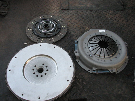

Got the clutch pedal assembly in... the hole I cut and mounted the master cyl in is too low so that sucks, I will have to move it tomorrow. Got the accessories back onto the motor minus the alternator which needs to be replaced, and the A/C compressor which I will put back on when I get all new A/C parts.
