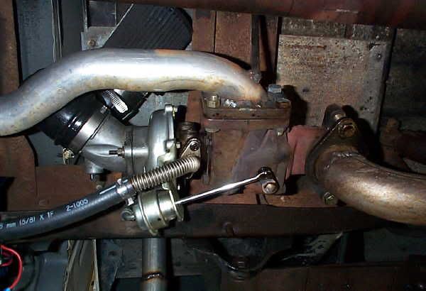

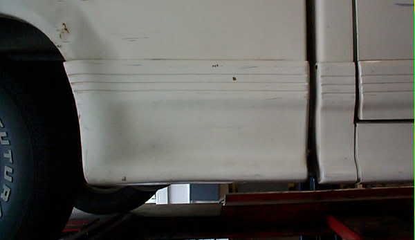

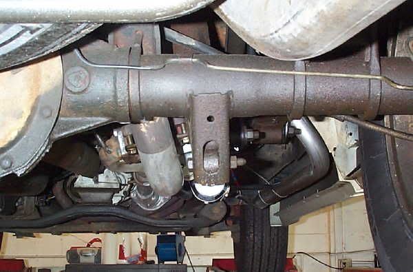

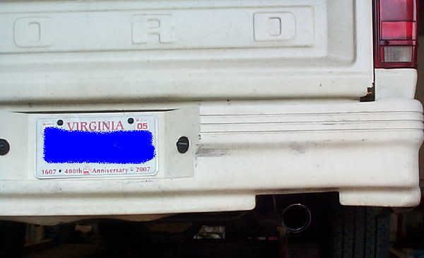

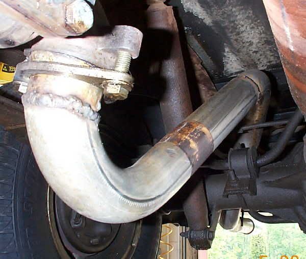

I found some pics of my Ranger GT 2.9 Turbo.
Here's the exhaust exiting the stock cutout in the Ranger GT lower valance.

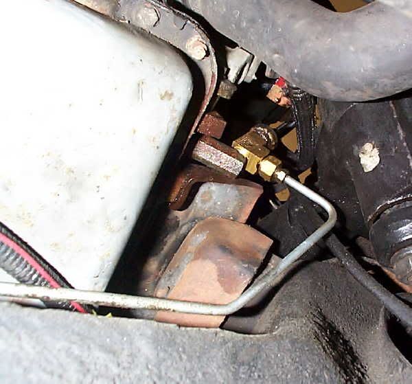

Here's how the oil feed for the turbo is tapped off at the oil pressure sender. It's hard line to the turbo.
Here's a view looking straight up from the bottom, at the turbo.
Here's from the turbo looking back.
Here's looking forward from the rear of the truck. You can see the intake air pipe headed down the right side of the truck. It is hidden behind the Ranger GT side ground effects, as shown in the next pic.

The only pic I've ever seen. But if you're going to turbo something, you may as well turbo a motor that is worthwhile.
i had thought about using the oil sender to feed a turbo, but the stuff that came out of my sender when i had it off was pretty damn disgusting, i wouldn't want to subject a turbo to that.
