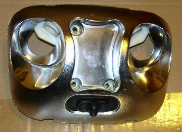

    Dual Beam Dome Light Triple Beam Dome Light
    Above are the dual and triple beam fixtures. They are the same aside from a plastic tab on the back which is located in the "wrong" spot on the triple beam model. and of coarse the extra bulb socket.
    Here is the triple beam dome light with LED lights installed. The map lights are 194 replacements and the center is a 1watt LED map light replacement.
