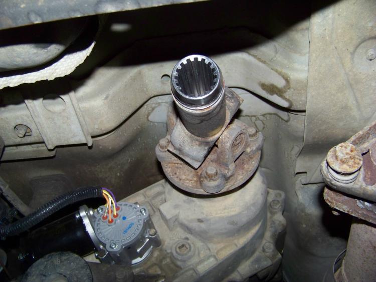

Remove the (4) 12-point 12mm bolts that hold the driveshaft on to the differential. If it doesn't come off, you may need to strike it with a mallet or wooden block.
Once you get the driveshaft disconnected, slide it out of the yoke at the transmission/transfer case.

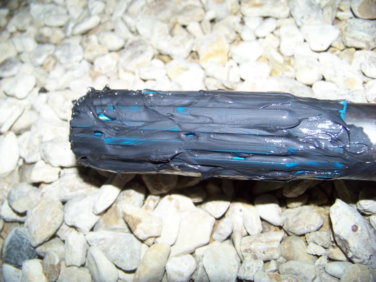

Make sure you clean all of the old grease out of the grooves.
Once it's clean, put a good coating of marine grease on it.
