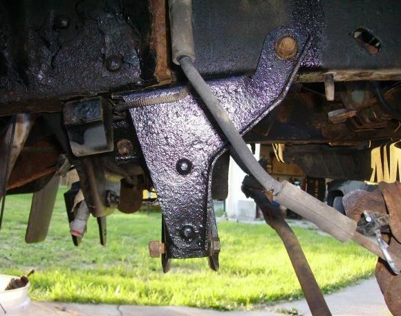

Here is a photo of a 1987 Ford Ranger STX High Rider radius arm bracket, stock, RIVETED in place.
If yours has one like this then it's a High Rider. In comparison, this is a pic of a '91 STX [ NOT a High Rider ] radius arm bracket, stock, RIVETED in place.
Compare the rivet spacing and the three extra rivets on the High Rider bracket, there is also a block of steel between the frame and bracket that is 1-1/4" thick. It's welded to the bracket. In this photo I've taken that block out;
