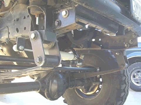

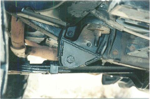

On my installation, using the front eye bolt of the rear axle spring as a reference point, the distance from there to the rear spring eye bolt for the front spring is 46-1/4".  At this measurement, the wheelbase is 95".   Since the frame rails at that location are too close together to attach the spring hanger under the frame, the hangers were attached outside the frame rail right under the body mount.  Although welding anything to a frame rail is not recommended due to the potential for weakening, this was the method I chose for attachment for the front and rear hangers.  The hanger was fabricated using 1/4" steel; however, a pre-made hanger would work as well.  The on-center measurement for the distance between the spring packs is 32".  This provided sufficient clearance between the spring and a 38” tire (mounted on a 15" x 8" rim with a 3" offset) at a full turn.
The front hanger was also mounted outside the frame rail, directly under the front body mount.  The distance from the rear hanger spring bolt to the front hanger spring bolt is 44", and the front hangers are also 32" apart, on-center.  The shackles’ length and strength selected will again depend on your specific application.  The shackles on my setup are 4" and were cut from 1/4" steel stock.

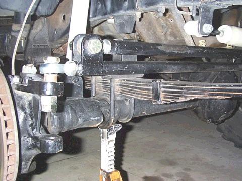

Once the hangers and springs are mounted (this task was the most time-consuming for me since I didn’t have any reference points), the most difficult part of this conversion has been completed.  The bolt-up of the Dana 44 to the leaf springs is now a matter of centering the axle and determining the proper pinion angle (the pinion angle is a critical measurement that affects caster and driveshaft angles – a professional in this field should be contacted for assistance).  Since the axle on my project had the cast radius arm mounts, grinding on the axle and spring perches was required to obtain a proper mounting fit.  The spring perches were located on the axle 32” on-center, equidistant from the axle tube ends.  The U-bolts and U-bolt plate from the Wrangler were used for the axle installation.

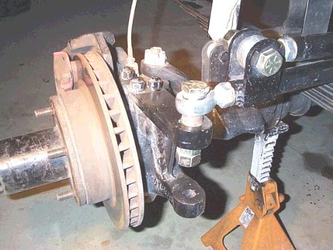

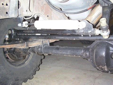

The steering component configuration with a leaf spring conversion will require some imagination and fabrication because the tie rod and drag link now have to pass over or under the springs.  Proper steering geometry and handling characteristics are issues that may need to be addressed by a qualified mechanic.  For my needs, the tie rod and the drag link had to be located above the springs so that they are out of harms’ way.  To accomplish this, I started by grinding a flat surface on the top of each knuckle.  Steering arms were fabricated from ½” steel and bolted to the knuckles with 3-1/2" grade 8 bolts.  Also, a gusset plate was welded to the underside of the steering arm and attached to the knuckle.  The tie rod and drag link are composed of a 1-1/4" tube with a 1” tube inserted into it, and the ends are 3/4" x 3/4" Hime joints.  The Pitman arm and the steering box are stock.  I added an AGR power steering pump for some added pressure to help maneuver the 38" tires.
