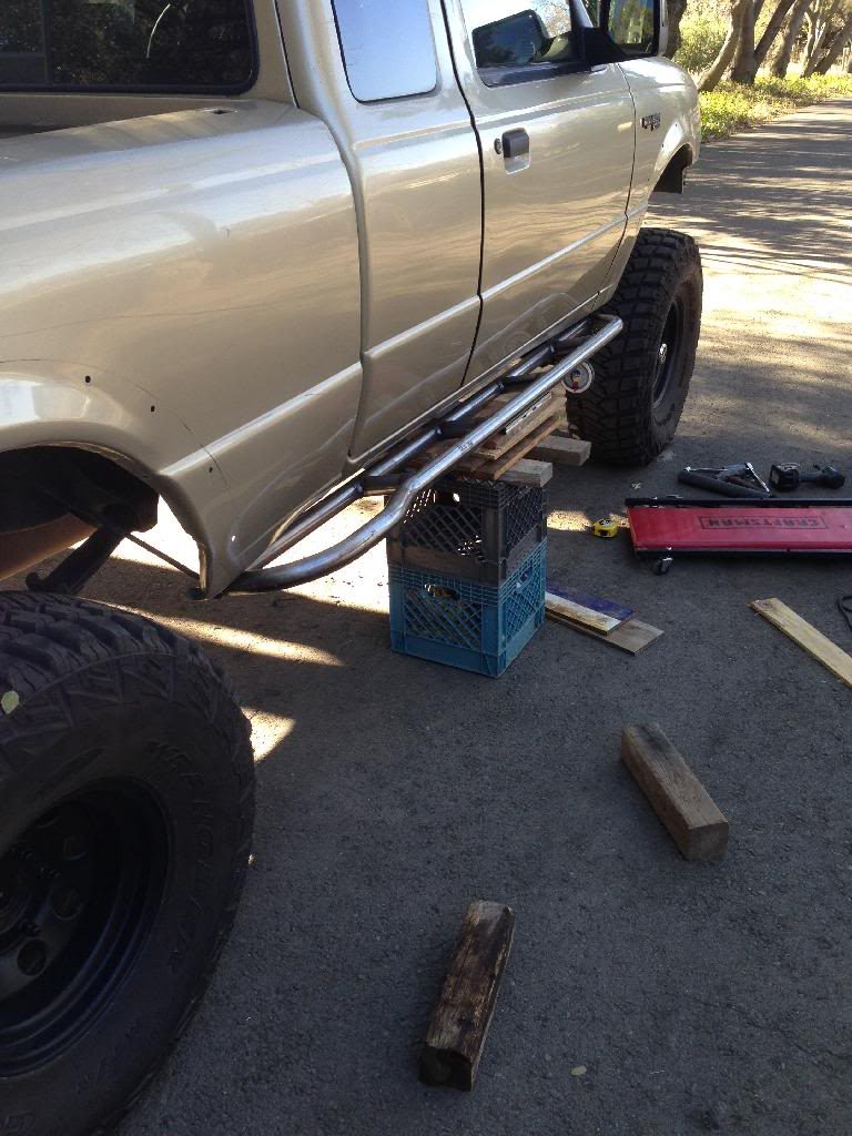

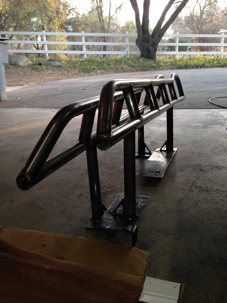

In order to get more flex, legoms013 added Skyjacker extended radius arms. He also made some rock sliders and added a TJM bumper with a Smittybilt XRC8 winch. The lights are Hella 700FFS with Silverstar H3’s.

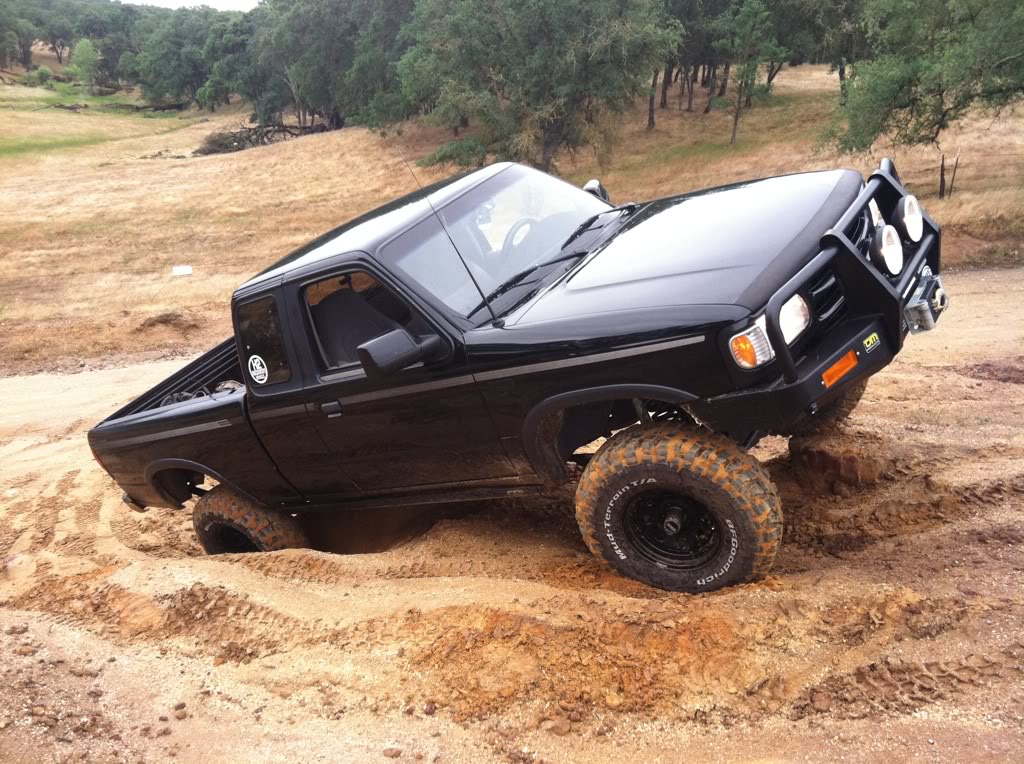

legoms013 finally upgraded his wheels and tires to 33×10.5 R15 BFGoodrich KM2 Mud Terrains on Procomp 98 series black wheels (15×7, 4.00″ BS). The roof rack is by Yakima.

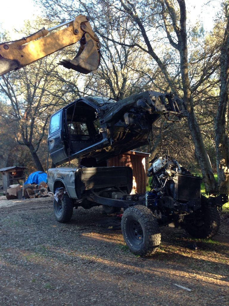

Ok, so this is the point where most people part the truck out and start over. But the frame and suspension was undamaged, and legoms013 had put a lot of work in to this truck. So in the never ending quest to improve the truck, he updated the damaged body with a newer one.
Behold, the donor. A 2000 Ford Ranger;
So off came the old damaged body;
