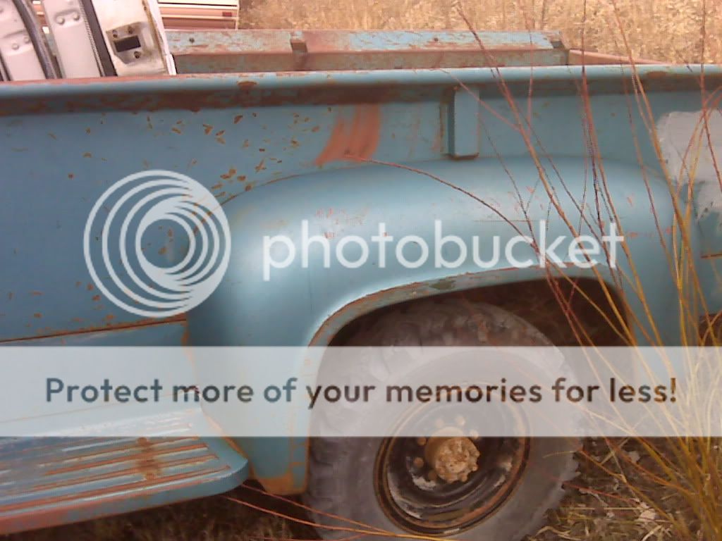

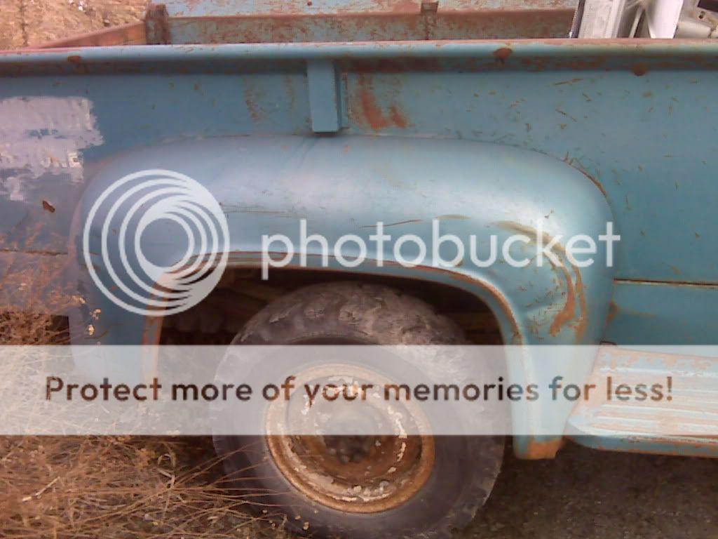

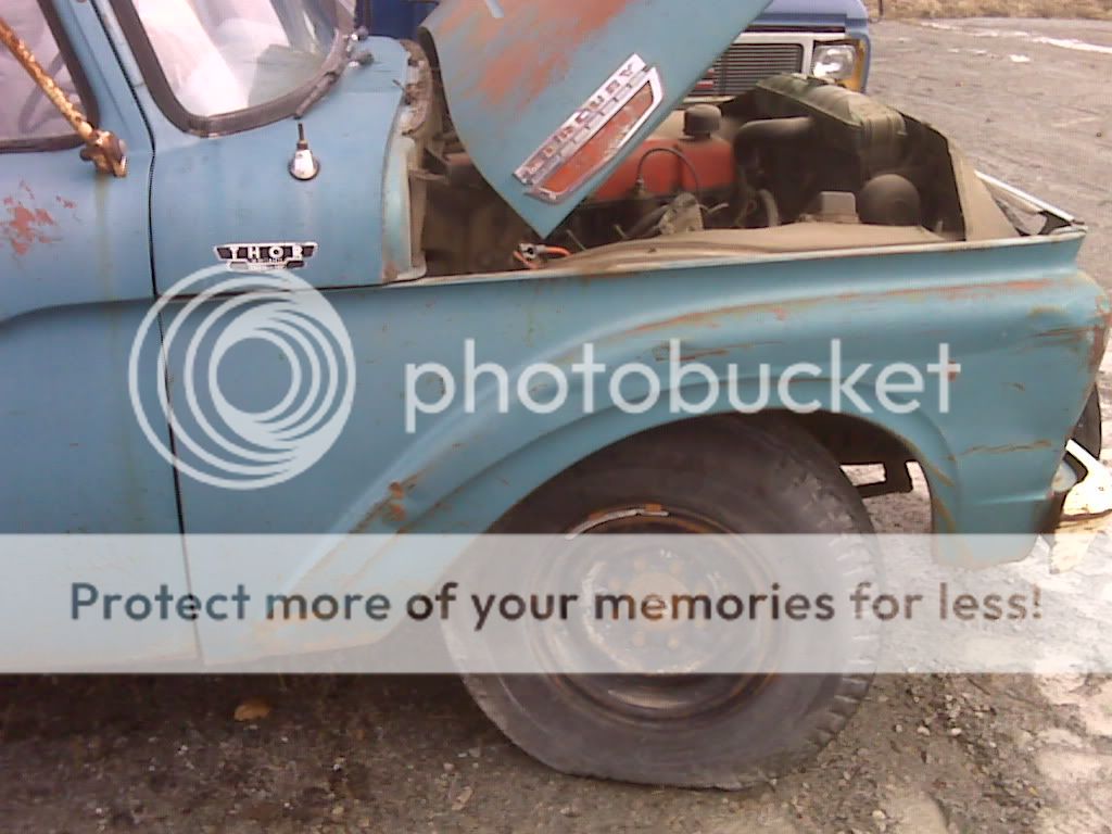

Damn Good find!!
seems to be in pretty good shape, i mean it doesnt look rotted at all, just looks like surface rust for the most part..

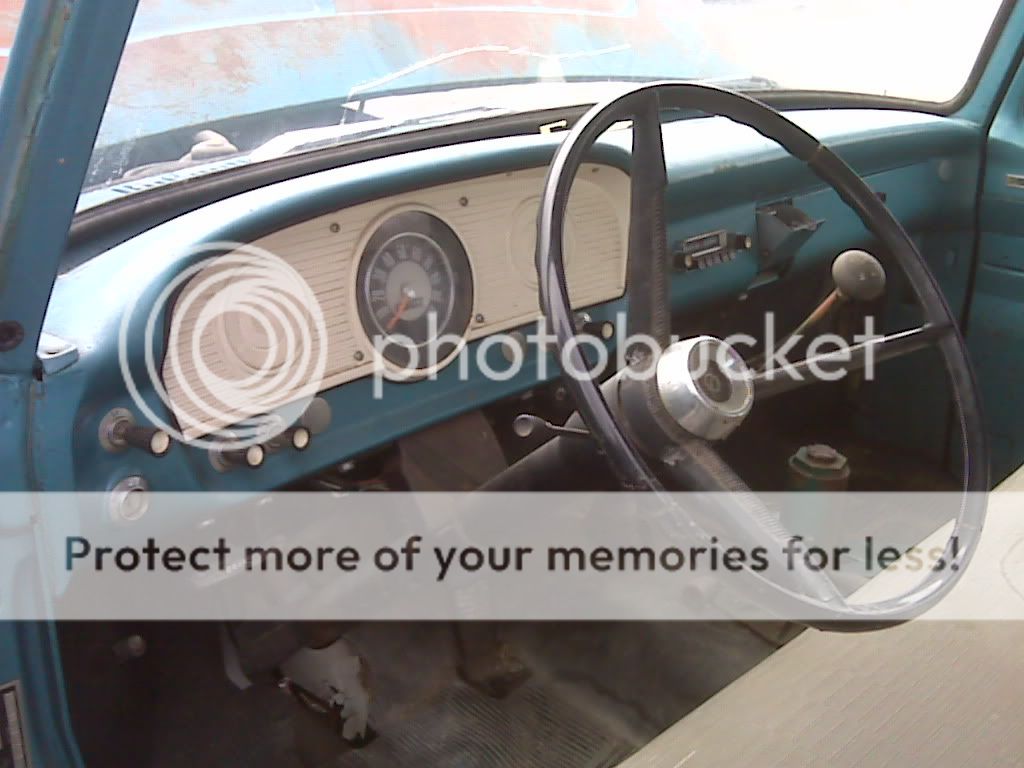

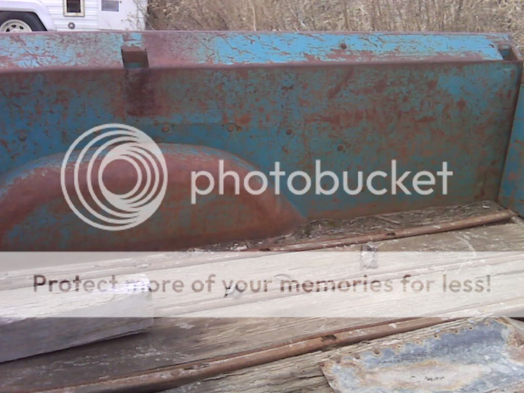

it is mostly surface rust haha. bed floor used to be wood. now its soil and theres a hole in the floor around the pedals but if what i remember is right did they not use a wooden access panel there? the seats not even ripped. so the interior is staying the way its meant to be. just paint and whatever it needs to run and drive then its finished

On the earlier Fords, that access panel was to the brake master cylinder. Don't see one on the firewall so that's probably what's down there. Lots of good sites for the F-100. Think the major difference between the Ford and Mercury was different trim and such. Good luck, them things are "Built Ford Tough"

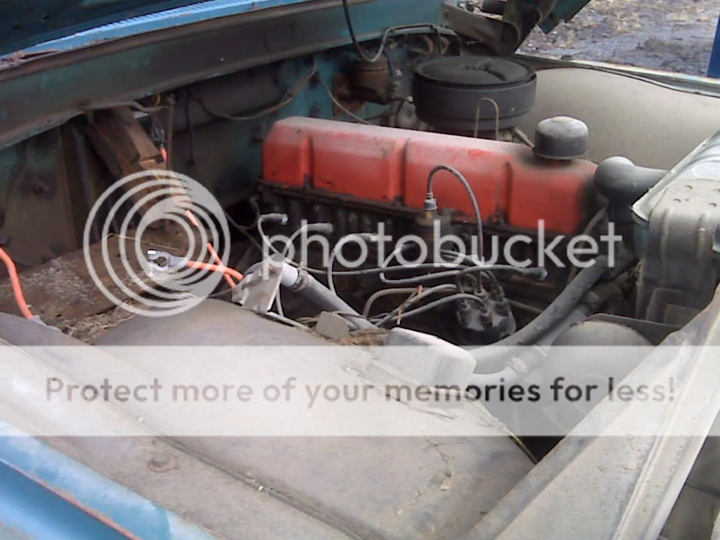

That's definitely not a 240 or 300 c.i. as the distributor and plugs are on the wrong side. I'm not great at IDing them, but it's probably one of the small ford sixes such as the 200 or 250.
Good eye there 7secs. In the US 1963 is when they made the switch to the 240/300. Even the really small 170 ci had the carb/air cleaner on the passenger side. What is shown might be a left over 232 (223), who's dislexic, or bad memory. Good buy no matter what.

i think its a 223 ci. dont remember.... i looked at the odometer today. 63'000 miles thats like 1312 miles a year haha so does anyone know what this truck would go for narmally?
