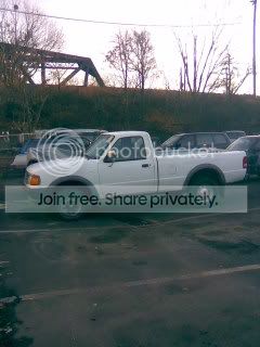

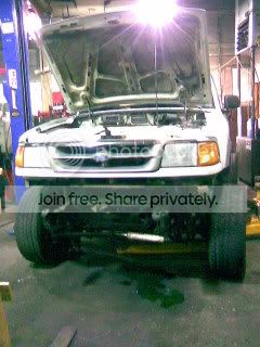

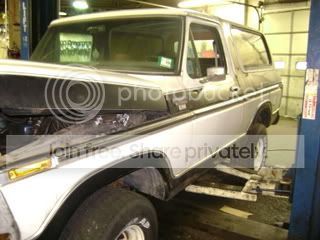

Here are some before pix
1996/1979 Ford Ronco
The engine & drivetrain are done.Im fabing up the body mounts today, the cab sits alittle back, I had to remove the a/c heater box,(i will modify it and put it back later) the drivers side valve cover is about 1/2 inch from the firewall with no firewall mods.I am going with this position.
The centerline of the front tires is forward about 2" but it still looks cool. I used the bottom 1/2 of the Bronco steering column and made a spline to spline adapter to use the upper Ranger column.Im mounting the radiator between the roll bar in the bed with fans.
I will have to crop the front of the bed about 10"
so i can center the bed to the rear wheels, then wiring, dash,brakes,lift,tires etc
Ill keep posting

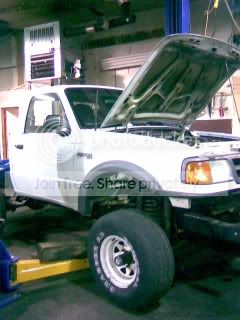

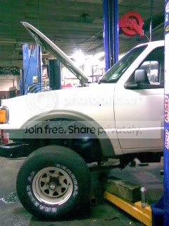

12-17-2007
Middle cab mounts--- Done
Steering shaft--Done
