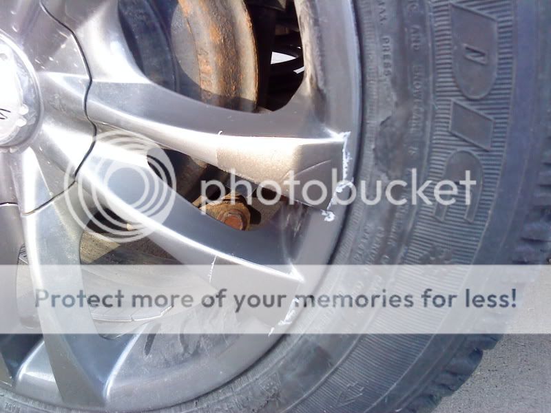

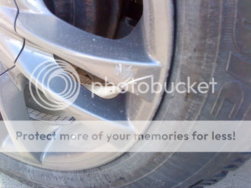

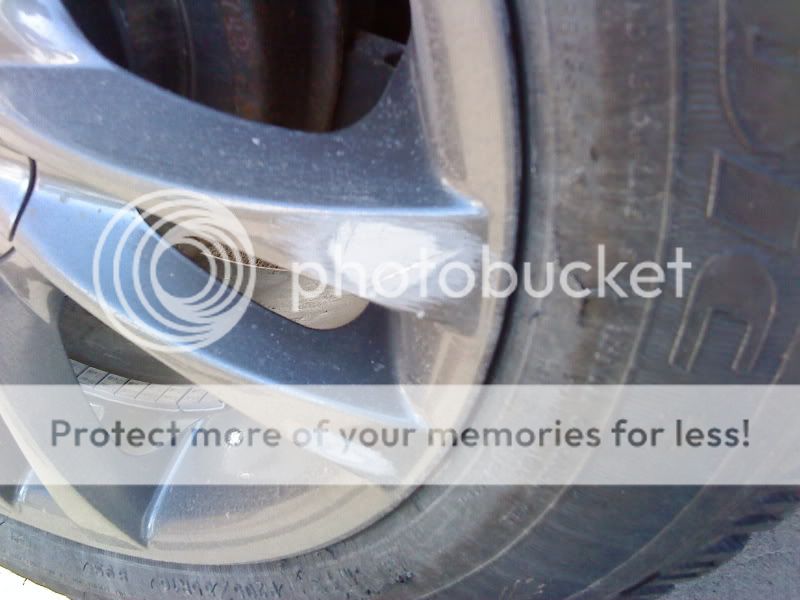

Four days after I bought a set of new rims to replace a set of damaged rims, I was parking and I got a little to close to a curb. I managed to scuff the spokes of the rim and make a brand new set of rims look old and ugly. I wasn't going to let the rim beat me, and I wasn't going to pay $100+ for a rim shop to repair it for me or buy a new rim. I decided since it was already ugly and damaged, I couldn't make it any worse. This is an easy and way to repair a painted aluminum rim.
This is what I had to start with.

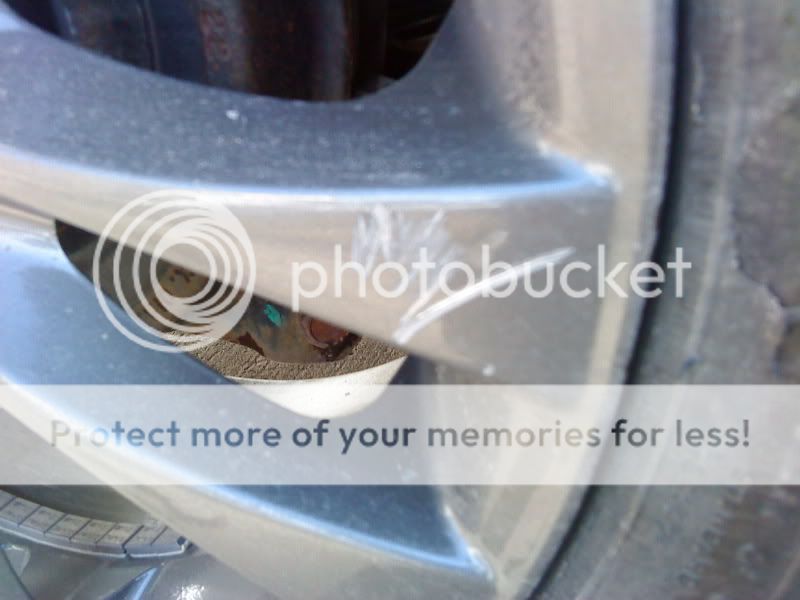

Sand the area down with a coarse sandpaper or emery paper depending on how bad the damage is, mine wasn't to bad, so I used a 400 grit sandpaper, and then an 800 grit sandpaper, and then 1000 grit sandpaper. I was wet sanding and drying between each sand to see how much I had to go. Sand the area surrounding the damaged section too, it makes for a nicer surface to work with later on.

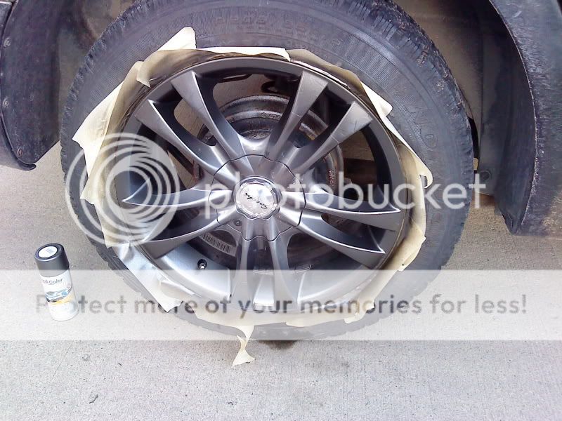

Tape off anything you do not want painted, this includes the tire. I used 2" wide masking tape and had good luck with that.

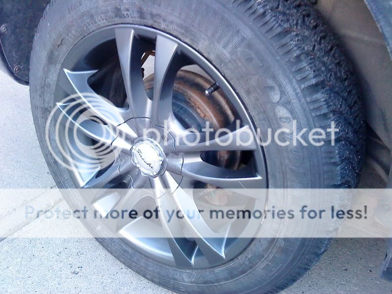

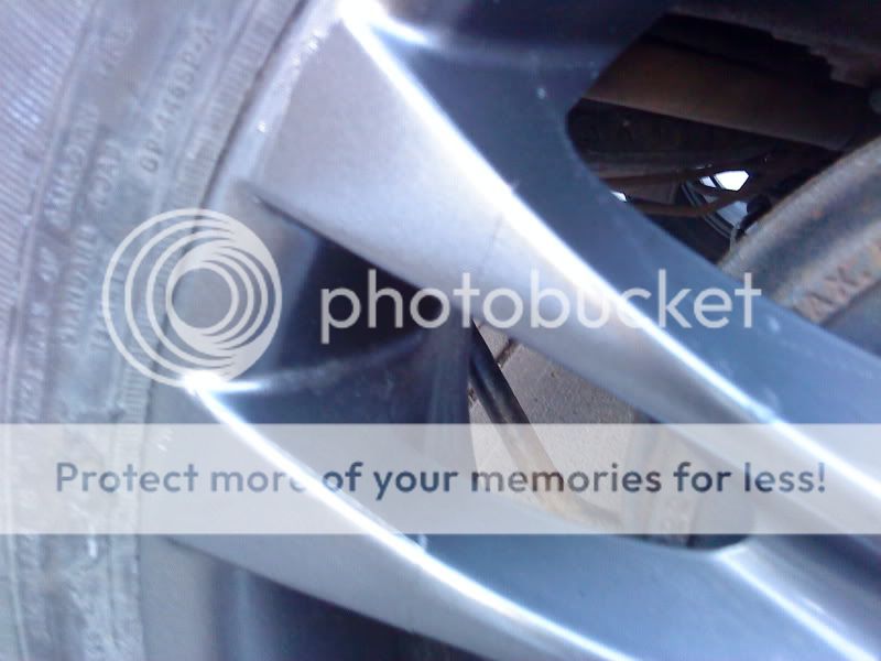

And here is what I ended up with, after about 2 hours of easy work, and most of the time I was letting paint dry.
I went from this
To this
