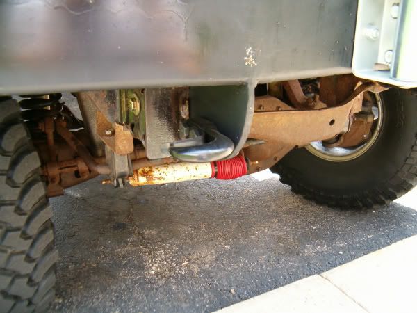

Can I see some pics of your bumper as it is now?
ya, I can get some, but none of how its bolted to the frame. the orriginal mounts that i made were drilled to match up to the factory bumper mounting holes.

Sorry, I didn't get any pictures of me pealing back the factory brackets (I had d-rings welded on the front of my stock bumper).
