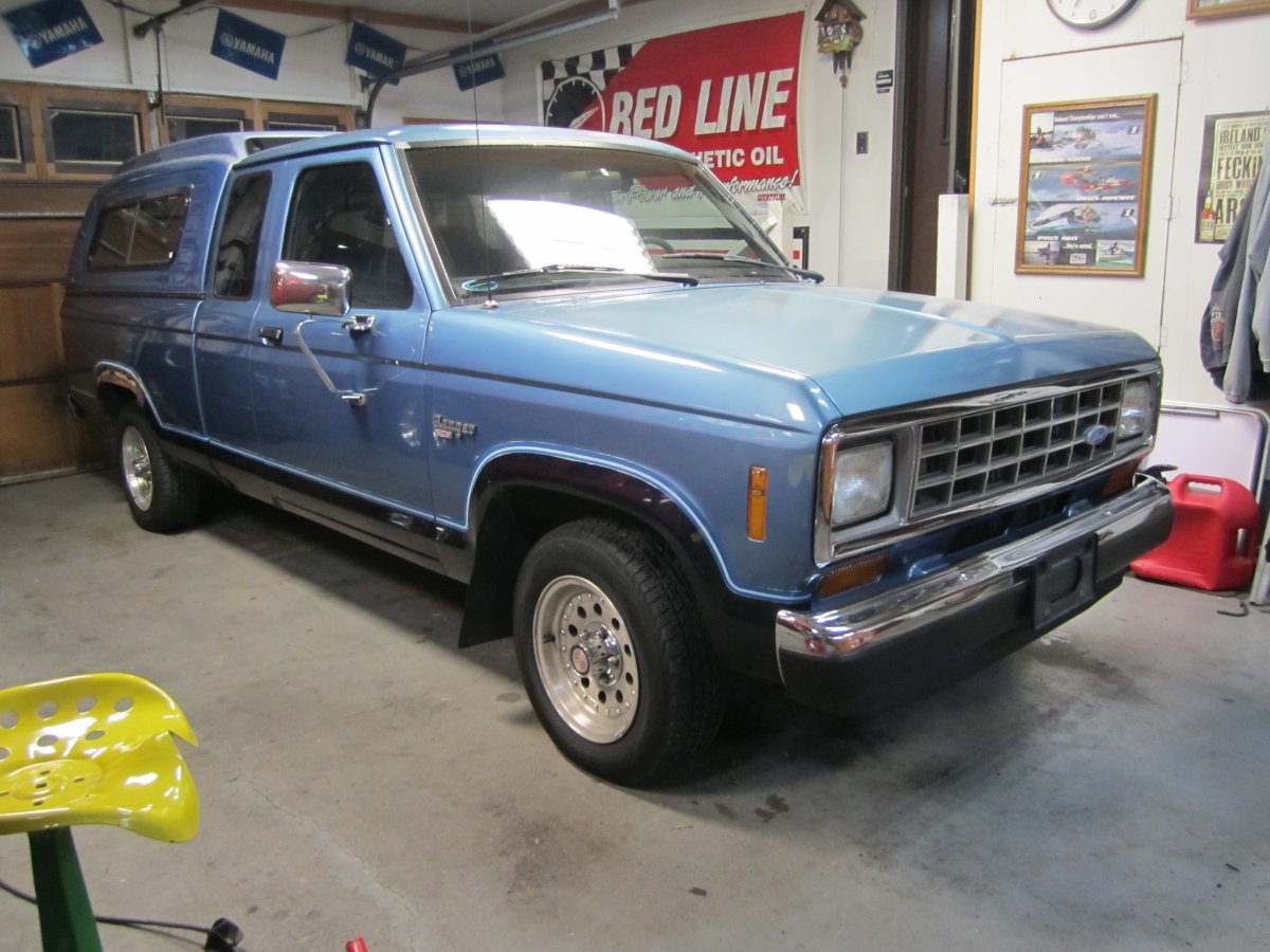

So I ran across a bitchin deal on an 1988 4x2 Extended Cab (during my never ending quest of finding a preferred donor first gen 4x4 to drop/swap the Turbo Diesel into)... A one owner, under 100k miles, bought off the show-floor, putted around town for the last 27 years, babied truck.. I couldn't pass it up for under a grand! Right place, right time, planets and stars are aligned kind of deal in my world :icon_twisted:
Rusted box-sides from our awesomely salted and chemical sprayed wintertime garbage roads,(shock, I know lol) but very clean otherwise on the cabcorners, fenders, doors and radiator support. Happy days!
How I found it..
He had the inner structure treated back in 1990 at Ming, they drilled holes all over the damn place to do it, but did its job of keeping the cab corners and doors alive around these parts..

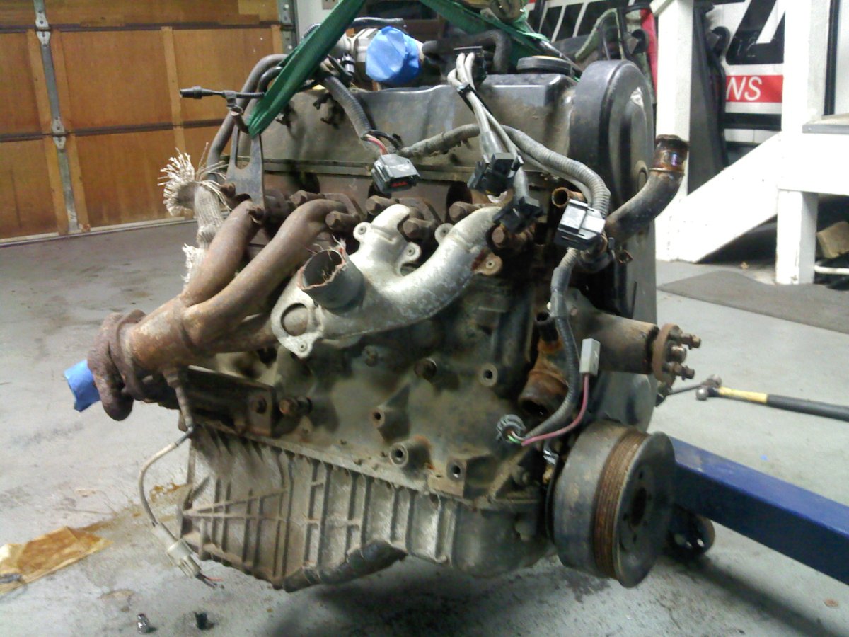

Low Miles 2.9L and auto trans for sale shortly!
Got the donor motor from a low miles 93 Ranger front hit for a few hundred and a case of Coors.. Great start for the roller cam and unmolested bottom end. Tore it down and measured bore, had very little taper and still some crosshatch marks so excellent shape for a set of .020 CP pistons and Crower rods to be taking the stockers place. Off to the machine shop for the works- clean, magnaflux, Deck the block, bore & hone, crank polish, and a full balance on the entire rotating assembly.

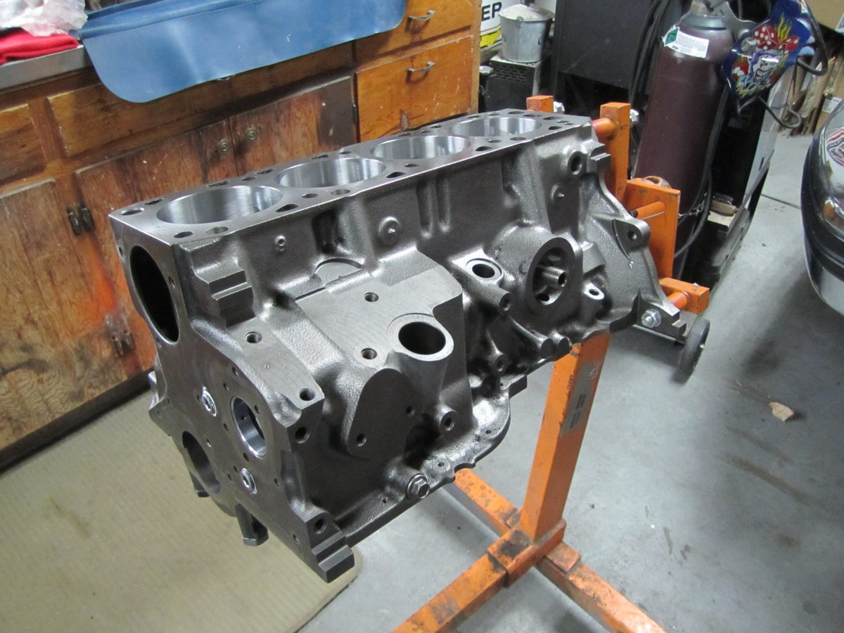

Got a couple here.. Block and components are back in the G-rage, starting reassembly now. Everything was in excellent condition before my machine guy started into it according his measurements, crank just needed a polish and returning to standard size bearings on the mains and rods, running ACL hardened bearings on both. Need to file fit the rings, then hopefully have the shortblock assembled by the weekend.

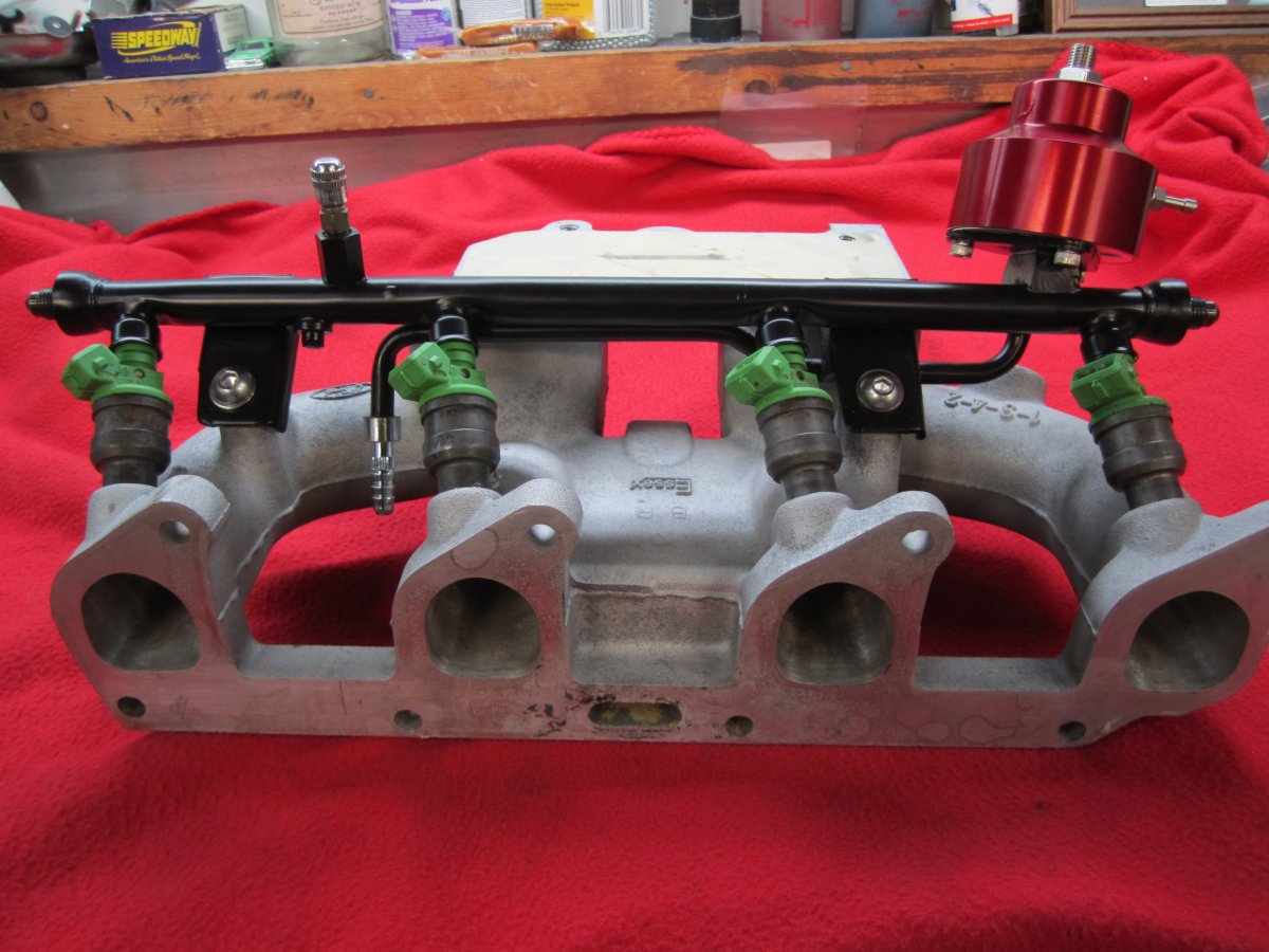

Finished up the port work on the lower, injectors all have a happy target now! Didnt go super crazy on the lower, knife-edged and gasket match the upper to lower, smoothed out all the casting flaws, will do the match to the new head when I get that completed, for now it is close.
Stock fuel rail on a 93 Ranger engine/intake manifold.. I like the total capacity it has, but its delivery volume and return capabilities kinda suck imo. So I modded it with a -04an weld bung on each end.
http://www.speedwaymotors.com/Male-Steel-37-Degree-AN-Flare-Weld-Bung-Fitting-4-AN,997.html
This will tie into a -06AN to two -04an y adapter then back to the 255 in the front tank. Return volume is good, but the factory barb fitting is only like 5/32 in a 3/16 id tube..Drilled factory fitting open to 3/16, restriction gone.. Using an Aeromotive 13103 1:1 regulator for a pre-93 Mustang I had from an old build, its the same mount and rail for the most part. Bonus!
Mocking up the rail..
Cut and welded shut the original feed fitting, bead blasted all the rust off the tabs and painted it up. 42lbs injectors.

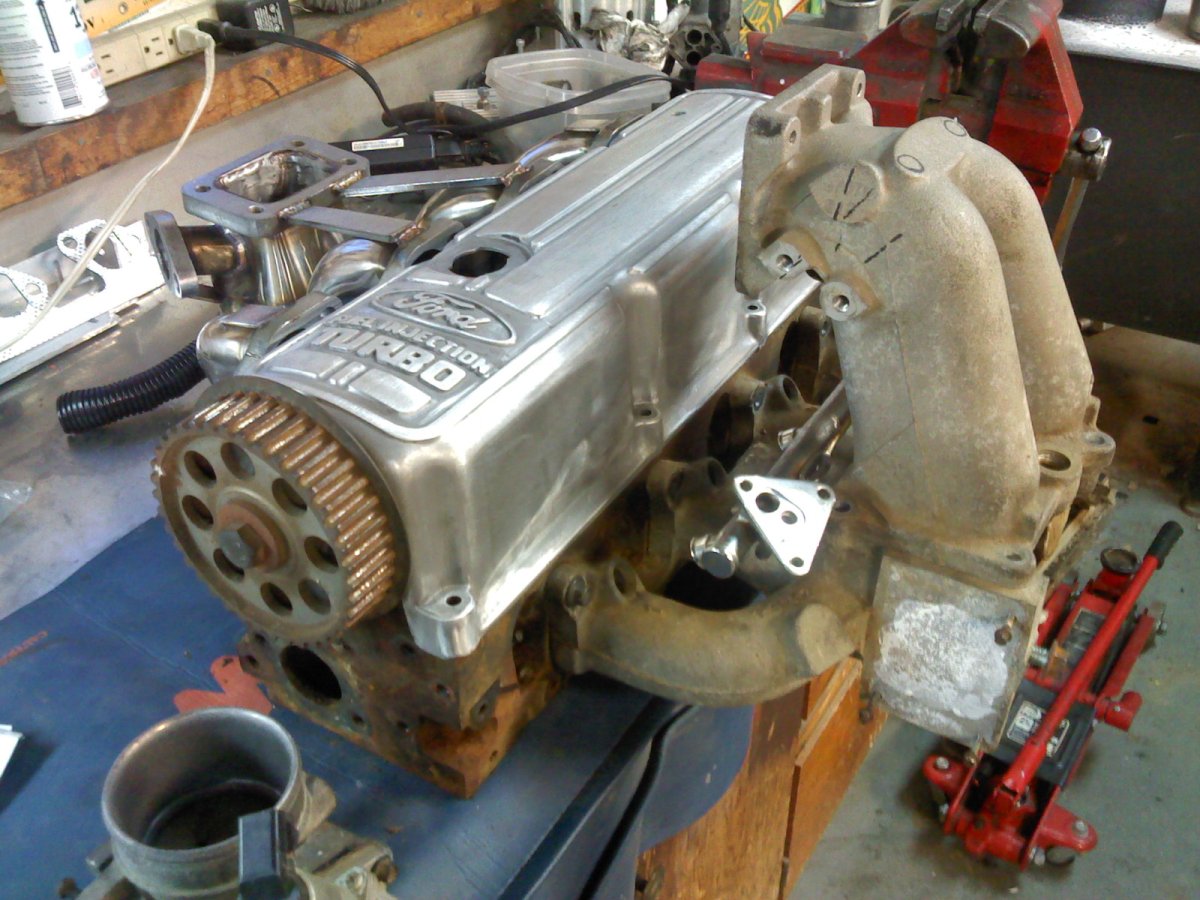

Finished the paint work up on the valve cover! Stripped it down and step sanded the top fins and insignia down starting with 320 and finishing out with 5000. Masked off the topside, finished out the rest in black, pulled the tape and cleared the entire valve cover. Now just need to keep the turbo heat off of it!
I bought a china header to start out with on this truck, I like the location to get the turbine away from the AC box but I read they are known to crack, probably the SS used? Or maybe poorly thought out downpipe exhaust combo? Bracing issue?? :dunno:
For the money though, I have a good head flange to build off of if it doesn't work out. Going to tig a spacer on top the main flange to get the compressor a little further away from the #1 pipe heat then wrap the header.
Upper Intake
Upper intake finished out! Gunna take a round hole and fit it to a square one lol Had to add some aluminum to the top to get it all to match up, but there is already lots of meat in these stock parts to hog out! Adapted to a 65mm mustang TB. Got it pointing forward for easy connection to the innercoler and it will clear the AC compressor with ease I hope....Now just need to get the motor sitting in the rails to find out if the hood will shut lol!

Block is assembled, painted up, and ready to drop in the rails! Also doing a little guinea piggin here.. I love the look of raw aluminum, but hate trying to keep it staying that way! Everything wants to go back to where it came from.. So with all the aluminum parts on here I am just bead blasting, spraying the parts with one coat of my own little concoction of adhesion promoter and 2 coats of Glasurit 923-57 matte clear Maybe it will stay this way? And now the waiting game begins! lol
All the flat black parts are coated with Diamont SC804. This stuff I have tested and beat the hell out of, good to go here!
