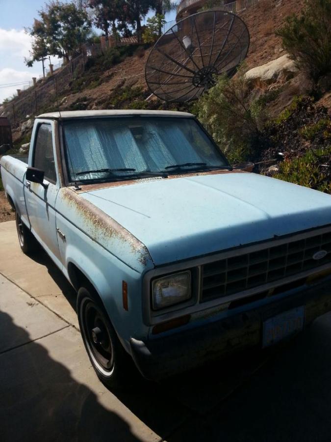

Picture of the truck. I will post a few more once the truck is moved.

The Lima, OH built 2.3 is not know for blowing head gaskets. You may or may not have had overheating problems. Were it mine, I would remove the spark plugs, squirt some oil into each cylinder and let the oil penetrate a bit, maybe a day. While that is going on, I would borrow a pressure tester for cooling systems. You can pressurize the system to see if the radiator leaks or the coolant is leaking into the cylinder(s). If it holds pressure, it is likely not leaking... If it leaks from the radiator only, as far as you can tell, you can get a replacement radiator from a recycle yard (boneyard) or a new one. Since you don't know the condition of the rest of the truck, you might want to go used. The 2.3 doesn't need a lot of radiator.
After you have oiled the cylinders and waited, you can run a compression test. Disable the ignition(you can remove the wire from the distributor to the coil), and block the throttle wide open. Crank until the gauge reaches a maximum, usually 3-4 revolutions. Note the readings for each cylinder. If two adjacent cylinders have low compression, you have found a likely problem, a bad head gasket between the two. If all are low, it can be rings or valves.
If the numbers are all close to equal, replace the spark plugs and then I would remove the top of the float bowl and clean & empty the float bowl. You could also drain the old fuel unless you know it is good. Put good fuel into the bowl and tank, and re-connect the coil. See if it will run and how well.
You could buy a complete used 2.3 for ~$300 if you just want to get it running. The 2.3 is a long-lived engine, with some going over 300,000 miles and still running well. A used one can be found and installed that will likely cost less than repairing yours if you find valve problems.
