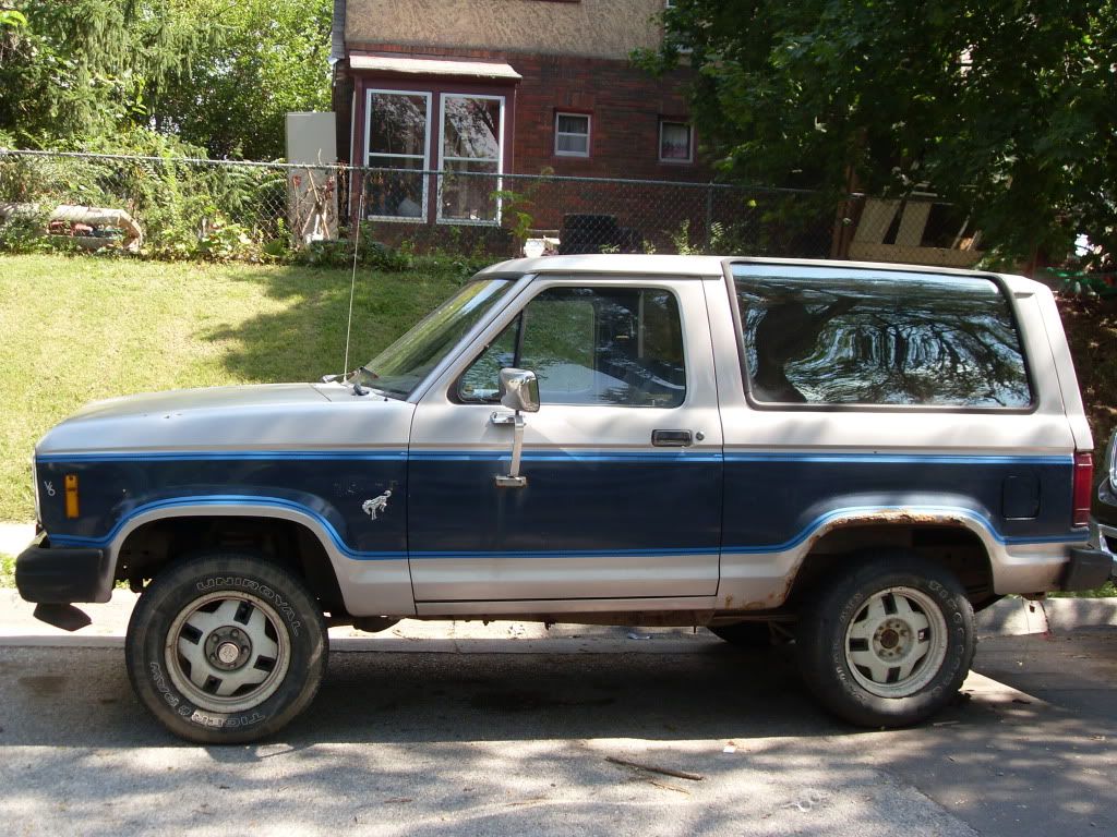

I got it home, got different tires put on, cleaned her up and took the running boards off and this was what i was left with:
Found a pic from the side

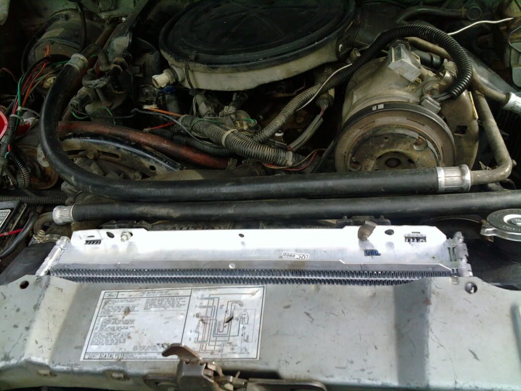

Well, after i got it home and cleaned her up i didn't do much to it for some time. When spring came i noticed my temp gauge would run on the hot side, often going over the red line. I dont think it actually ever over heated but by the gauge it got hot. So i replaced the smaller things first, i started with a new thermostat, that didnt work, next was the water pump, that didn't help, moved on to the fan clutch and that did nothing as well. So after reading some threads i came to the conclusion i needed a new radiator. I ordered a 2 core radiator for an automatic explorer for $80 off of eBay and put it in 2 days after i got it.
During the install i picked up an aftermarket temp gauge to get a better look at the temps of my engine. After te explorer rad was put in, I hardly saw temps above 200*F.

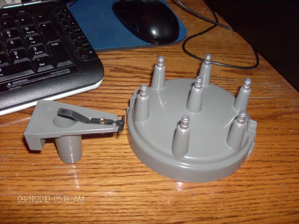

So after a year of driving the truck i got tired of the lack of power. So i started research ways to get more power out of the 2.8, i cam across the TBI swap and the duraspark swap. I decided i was going to go with the TBI swap because i wanted to eliminate the annoying carburetor. So i scoured the junkyards for a month for parts for the TBI swap but i was unsuccessful in finding any cars that would work for the swap. So my next option was to go ahead and do the durasaprk swap. So i started buying pieces for it, i got all the parts new from the parts store and found a carburetor off of a 64 mustang 289 that was rebuilt by pony carbs on eBay for $80.

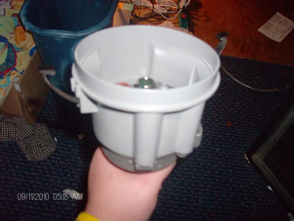

Cap and rotor
Dizzy

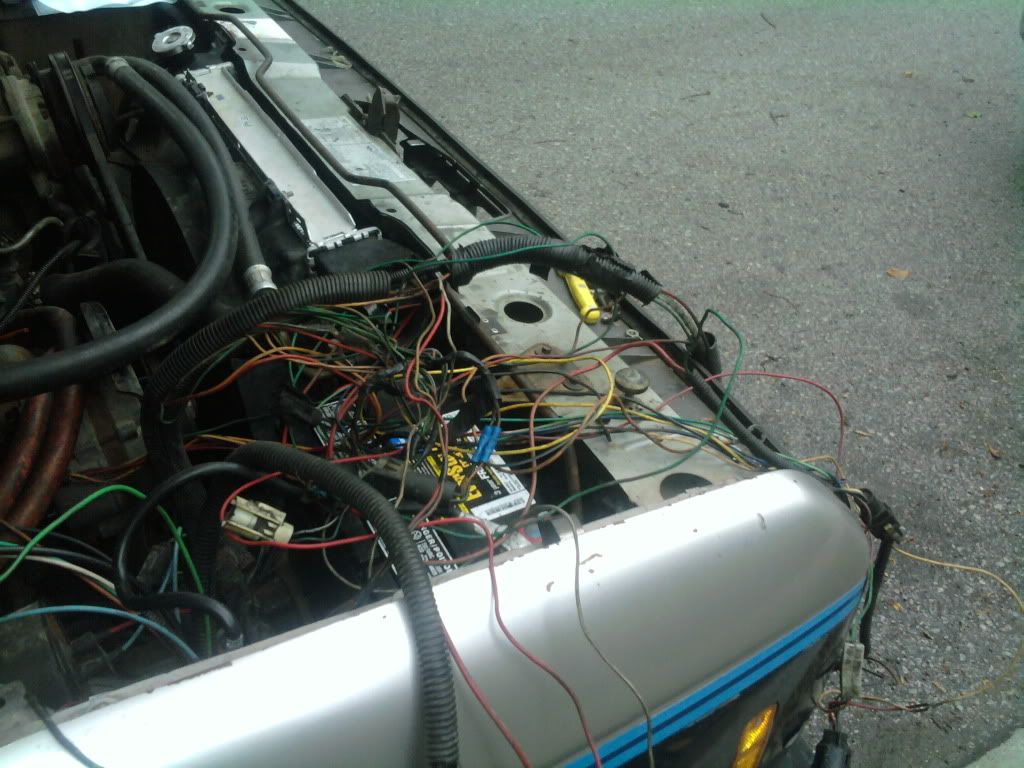

So i got started pulling the wiring harness and the vacuum line and solenoid.
It felt good pulling out all of the wires and all the vacuum lines that were not hooked up.

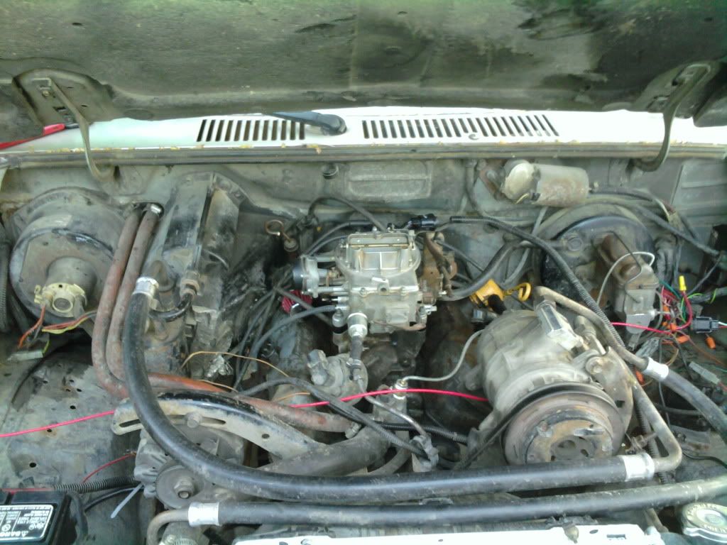

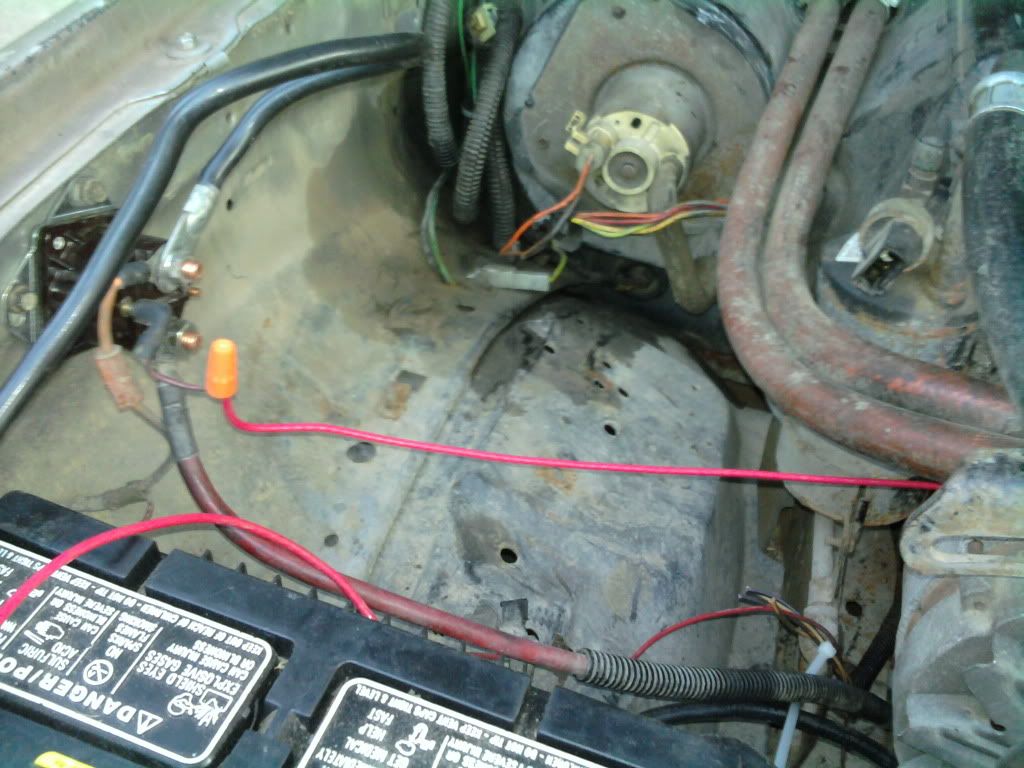

After i got everything installed, i could not get the truck to fire up. I rechecked that i had got the engine to TDC before i put the dizzy in and all my connection were good. Someone on TRS suggested i add a small wire that goes from one connection to one of the small posts on the starter solenoid.
That made my truck able to turn over but not start. So i checked and made sure i had spark, got spark, made sure i was getting fuel, i was. So i could not figure ot what the problem was. So i thought i was 180* out of timing, but i rechecked my TDC and it didnt add up. In the process of trying to ge the truck to start i went through 3 duraspark boxes (luckily they have lifetime warranties :lmao:) So i talked to my brothers friend who knows some about cars and he suggested i make sure my wires were on the right posts and spark plugs, they were. At that point i was out of ideas on what to do. I posted a thread on here and on TRS about things that could cause my truck not to fire. Someone suggested i move my wires clockwise and counterclockwise on the dizzy cap, becuase maybe i had gotten the timing off by a tooth when putting in the dizzy. So i put it forward one post and tried to start it and BOOOMM!!!! It made a huge pop, about as loud as a gun. It scared the crap out of me. Come to find out my muffler had blown because of all the unburnt fuel :crazy:. But on the next try she started right up and ran great :applaud: :applaud:
Here was the end product, a cleaned up better running engine.

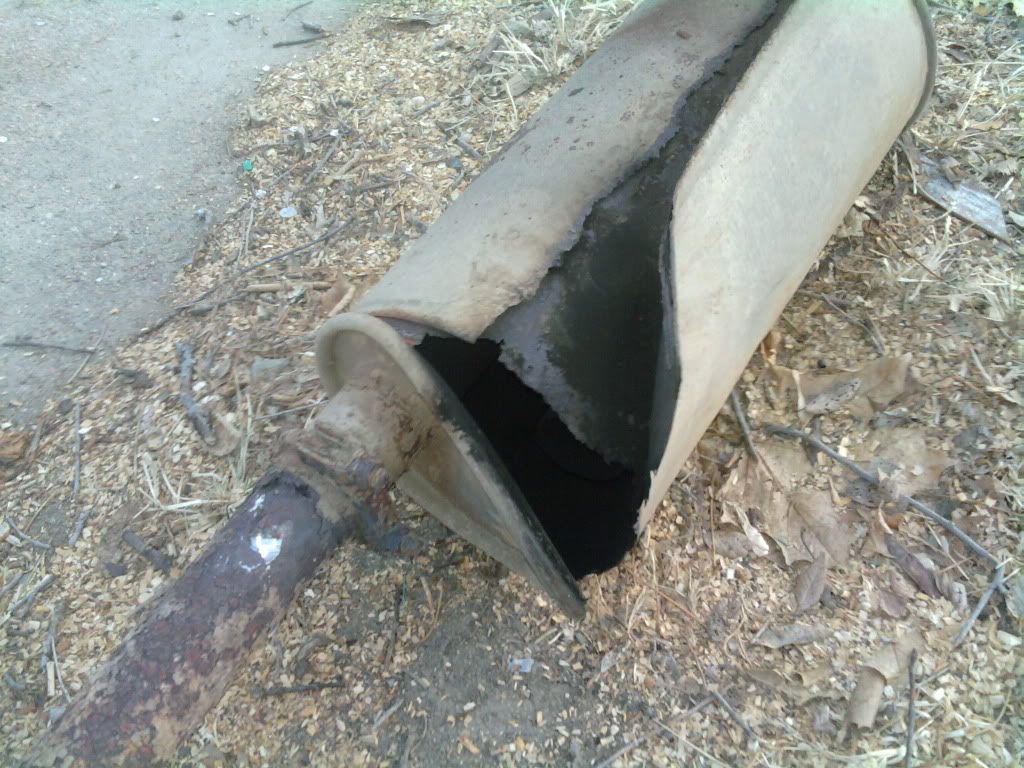

Heres pics of the blown muffler

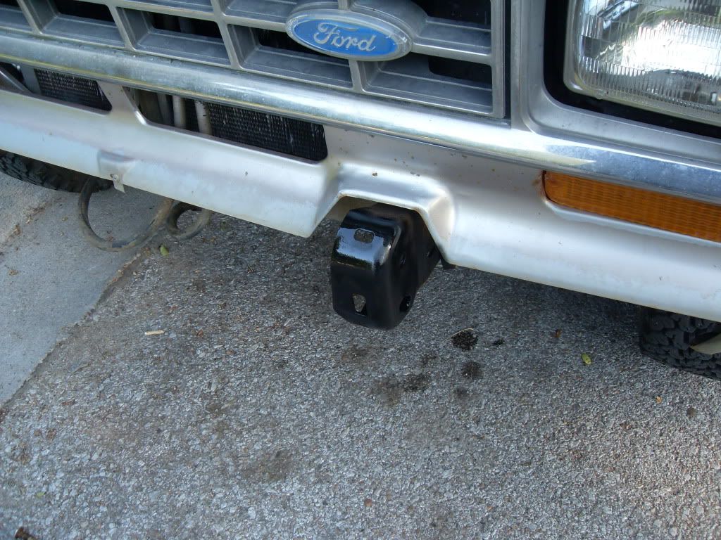

This a push bar i found at the local pick a part for $25
Well still no progress on the tranny swap :frown_2:

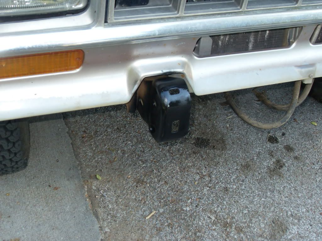

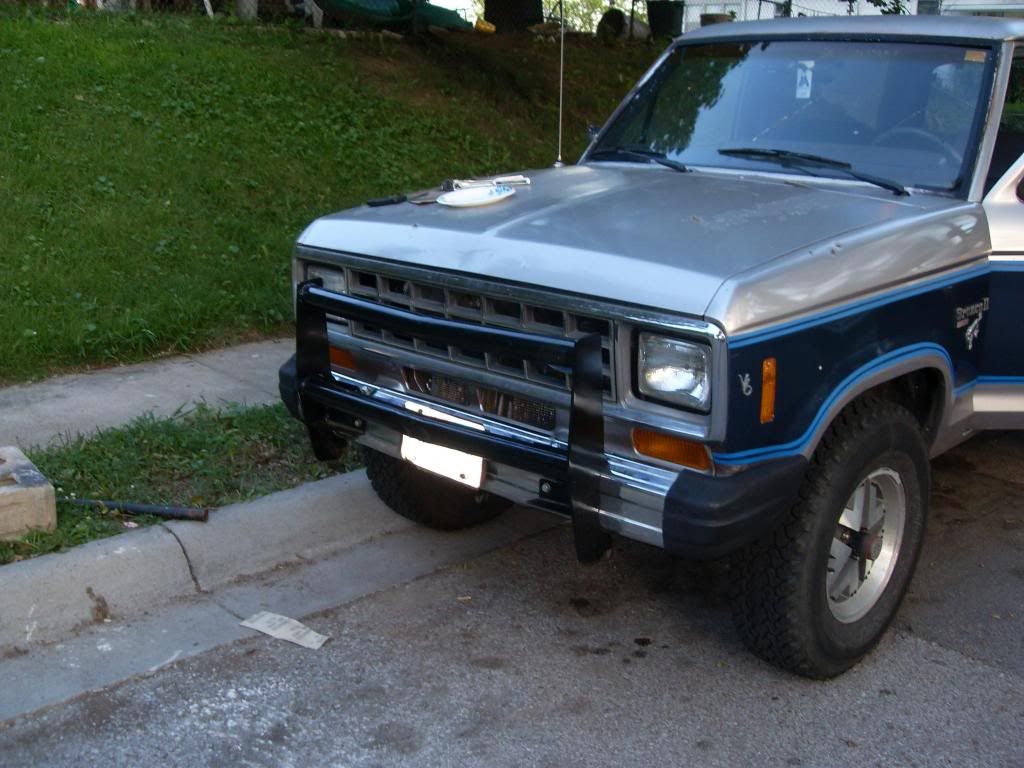

But i found a Push Bar in the local u pull it for $20 bucks so i threw it on.
Before:
Frame horns, with some paint.
The bar on.
This thing is really beefy, it weighs a ton :laugh:

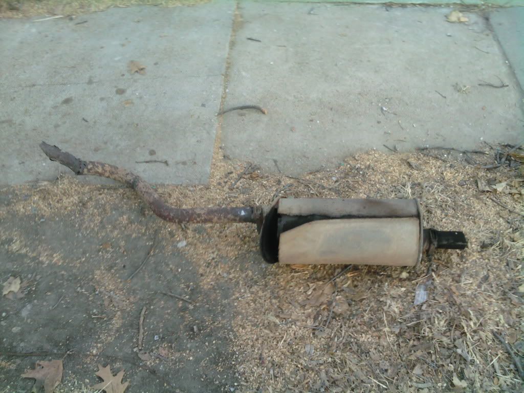

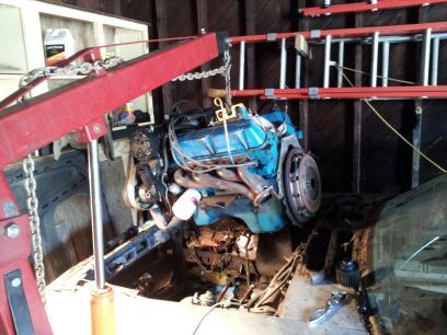

After driving the truck for close to 2 years, the engine decided it didn't want to dun anymore. On the way home from work it started running like it was out of gas, so i limped it home and it wouldn't start after that. While trying to diagnose what went wrong for 3 month, i got it to start only a handful of times and when it started it would idle ok but when you would try to drive it, it would backfire bad. Replaced the dizzy under warranty, rotor, cap, plugs, wires, dspark box redid all the wiring, but nothing worked :sad:
So my buddy sold me his 302 :headbang:
It has an aftermarket cam (don't know which one), an Edelbrock performer intake and a Edelbrock 4 barrel carb. When it was in the mustang, it scooted it quite well.

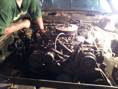

Here are some pics of pulling the engine.
What we started with (sorry the pic is crappy, dont know why it turned out that way)
Here is me trying to get out the tiny starter bolts
Here it is in the air
