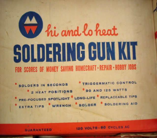

Unoleisu...thanks for the instructions. My client might have one i can borrow. Can I just use a roll of 16 gauge wire to practice on? I may have room since the harness with the most chewed wires has a little play in it and I have a drop light. will also get the correct gauge wire. I think all wires in that harness use 18 gauge. Will the heat shrink tubing shrink with a 1200 watt hair dryer?

Bobby...Thanks for joining in. All suggestions/opinions are greatly appreciated. What does "tin the ends" mean? I am now thinking the solder may be good for me to learn and maybe more cost effective. I am new to this and willing to learn...slowly but surely. (so far) :D
Ponyup, Sure you can practice with 16 gauge. It'll solder about the same. If there is enough slack in the harness to easily join the two chewed ends of each wire together, you shouldn't need to splice in a piece, I'd just solder them together. (I'd make sure you have all of the little copper strands for each wire, not just half the strands, this might require trimming the chewed ends back a little.)
I simply use a lighter to heat the shrink tubing. There is some little butane Pintorch with an attachement for this, but I've never needed to spend the extra $$ for it. (I think I saw it at Harber fright tools) Although I'm not sure what "tinning the ends" means, I am interested in hearing about it. If it works better I'm sure I'll try it myself, but twisting and soldering has worked well for me. It was the way I learned back when I took my ASE electrical class. And seems to be the method some manufacturers used on splices for their harnesses, at least the ones I have taken apart. I try to keep in mind that there is more than one way to kill a zombie.
