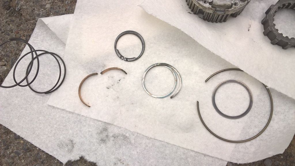

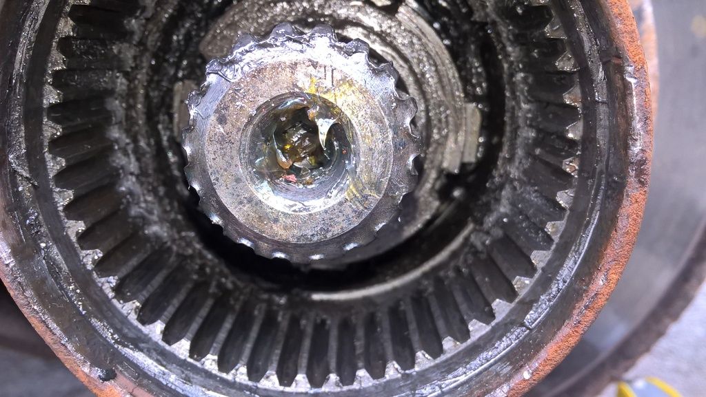

So after doing a family 'function' (private viewing for a funeral...) I decide to relax by tearing into the front end. Left front wheel bearing checked okay, hub is okay. The right one? Hub won't lock now. Wheel bearings are noticeably loose now. And if I turn the axle shaft- I hear a scrap sound from the hub.
That's not a new brand of "Shineola" grease... Aluminum metal flake all over everything!
That's what's left of things. Still haven't found the rest of that brass colored semi circle thing. Likely it's mashed up in the bearings. Also the clip that was supposed to hold the shaft- It was in there, but wasn't attached to the shaft. Just sitting there.

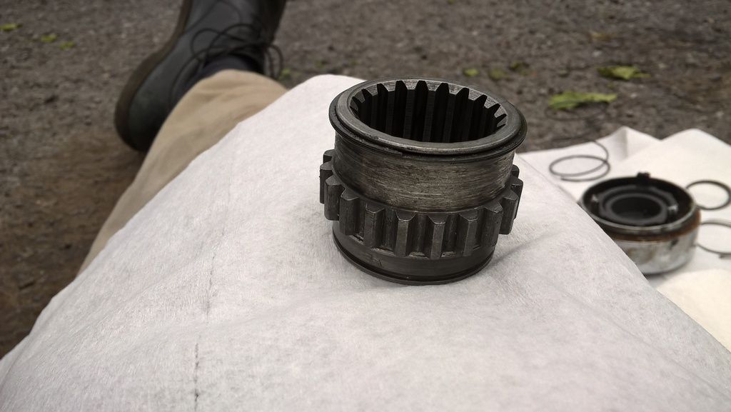

Pretty depressing. Hadn't expected to need all new wheel bearings and a new set of locking hubs. (limited budget). I'm heading to the U Pull and seeing if I can nip up a locking hub (either MileMarker or WARN). That and about a case of brake cleaner, new bearings...etc... The drivers side seems fine. But it looks like the last owner didn't correctly install the locking hub, and it pretty well started to disintegrate. Wish I could go with 'new' parts, but the parts are to expensive. (bearings will be new- But the hubs are about 65 and up for new. I can barely afford the bearings at this point....) I'm already expecting the drivers side to do the same thing, so it's getting new bearings as well--and I'll examine the parts sense at least that side seems to be working.
Side note: The part that is bent in several different directions. That is exactly how it was pulled out of the hub. With a pocket screwdriver. It was sitting in the back against the large nut for the wheel bearing looking just like that.
Anyone off hand know if there should be a spring retainer just in front of the big nut for the wheel bearings? I read up on this and it states to remove all the stuff and put in the 'install kit'. (Which was done....) But I'm not sure if the spring retaining plate was supposed to be in there or not... Then again, this came out like a big handful of scrap..
