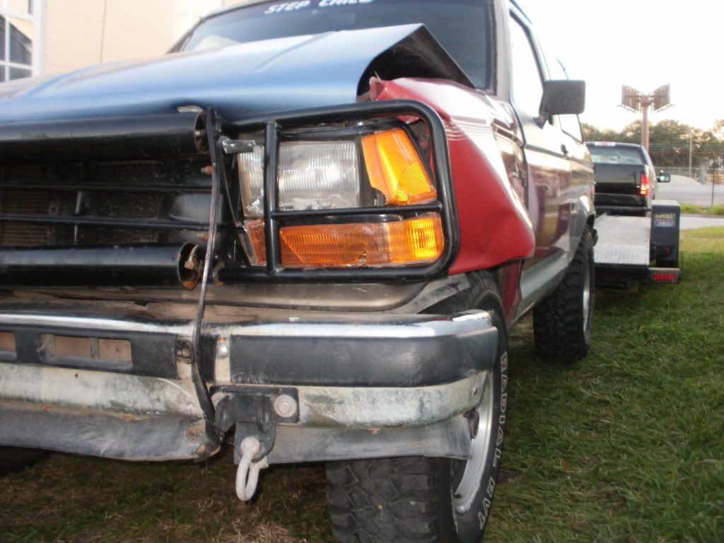

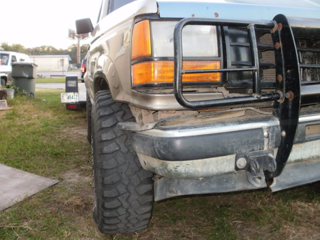

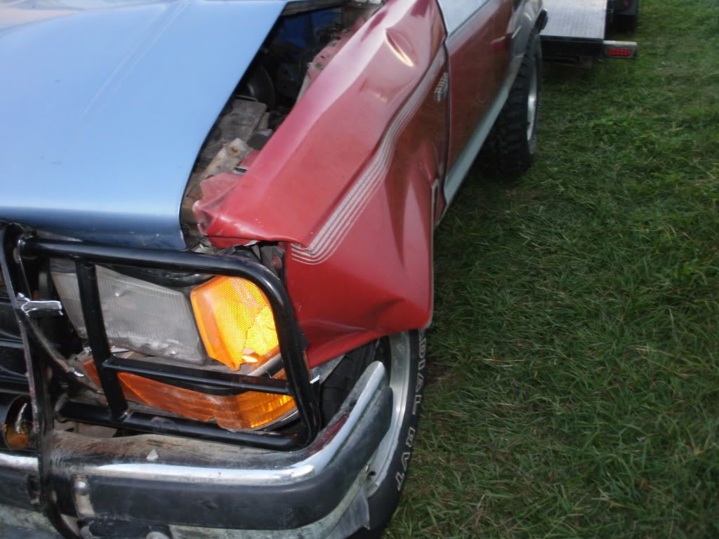

Well the week started out good untill tuesday evening after work. Got off and was on the way to help a friend out with his car when an idiot pulled out in front of me from a stop sign. Locked my breaks down and tried to mis her but.... you guessed it KA-BLAM. :annoyed:Good news is that no-one was hurt to include her two very young children that were in the car with her. Really good news considering I hit her in the drivers side rear door right where one of her kids was sitting in his car seat.
Now my beloved project Step-child sits in the driveway with a mangled front end just 20 days after getting her registered for the first time in four years of actually owning her.:bawling:

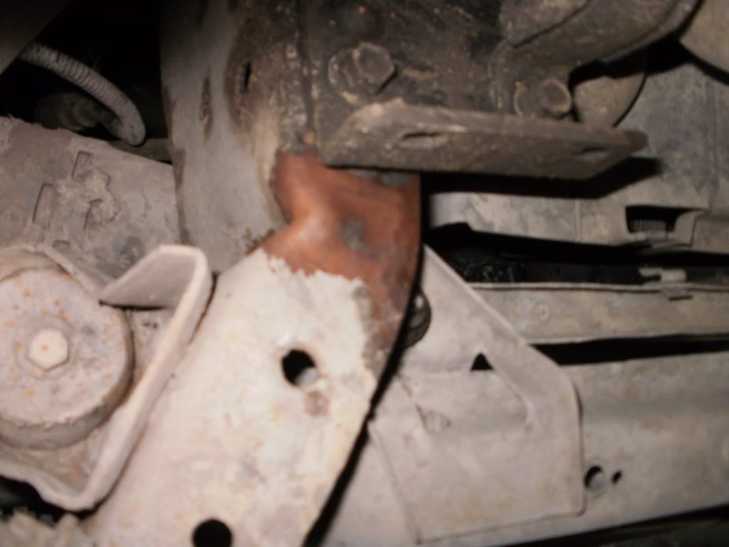

Yep that is a bent frame your looking at in the last two pics. Just the front 6 inches or so on both rails but it's still bent.

Frame swap. Find one that was rolled or the body rotted away and get the frame, but your shell on it, and go from there.
That will be the easiest way to fix that.

That is pretty much what I thought. I will weld mine back on once I get it back together. Also thinking about boxing in the front portion of the new frame in the area in front of the sway bar mounts. It was designed by Ford to bend in case of a crash but it also causes you to replace frame.
Checked last night on the local u-pull jy website and a frame only cost's 109.99 but the hassle of stripping down to a frame at the jy may over-ride the cost. may wind up cheaper to buy a whole parts BII and go that route.

It may be able to be pulled back. i had my wife check with a few shops she delivers parts to and they are saying that it would cost somewhere around $90 just to set up the frame machine then between $100 and $500 to straighten it depending on how bad it is. Of course to get an accurate price I am going to have to get to them.
I was looking at it yesterday and it looks as though it has been welded on the pass. side already at some point. It also has a small crack in the same area so it might be better to do a swap anyhow.

No, if you think the frame has been repaired in the past, I wouldn't mess with trying to straighten it. Do the body swap. Then if you really want, hang onto the old rolling chassis and build yourself a replacement section for the front out of box-channel and repair it that way.
