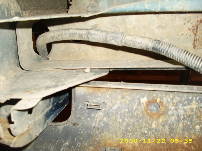

After the wires are dropped down though the bed you need to pull the wire loom from the bed where they are attached, making sure you get all the plastic push clips out. You may have to lift the bed up and place a chuck of wood or something to get the ones right above the rear bumper cause they are a pain to get to.

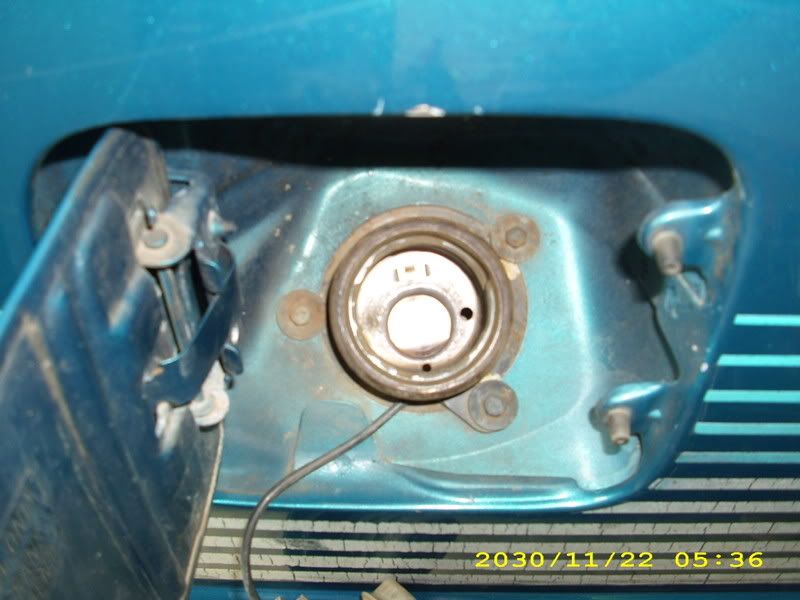

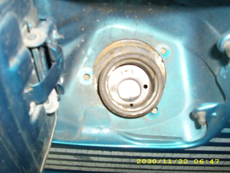

Now that the bed is unbolted and wires from the taillights dropped, you need to get a 6mm socket and unbolt the 3 bolts holding the filler neck for the gas tank mounted to the bed.
