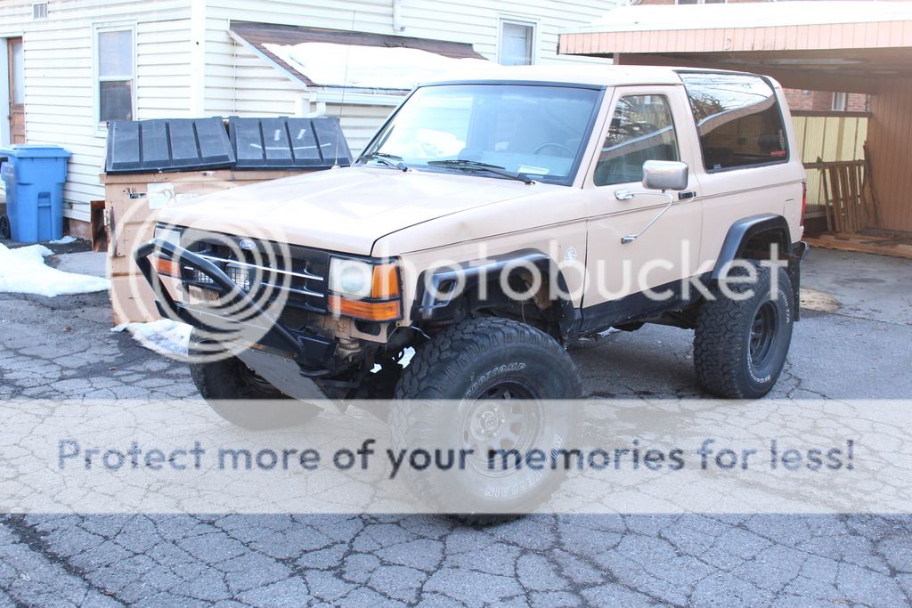

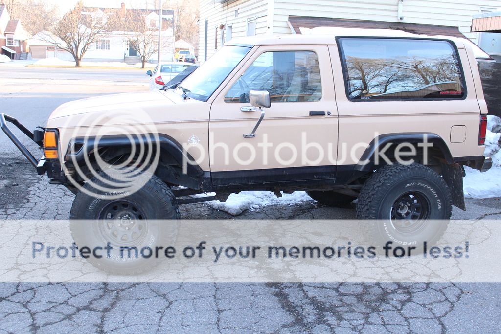

Dont mind my one odd tire haha

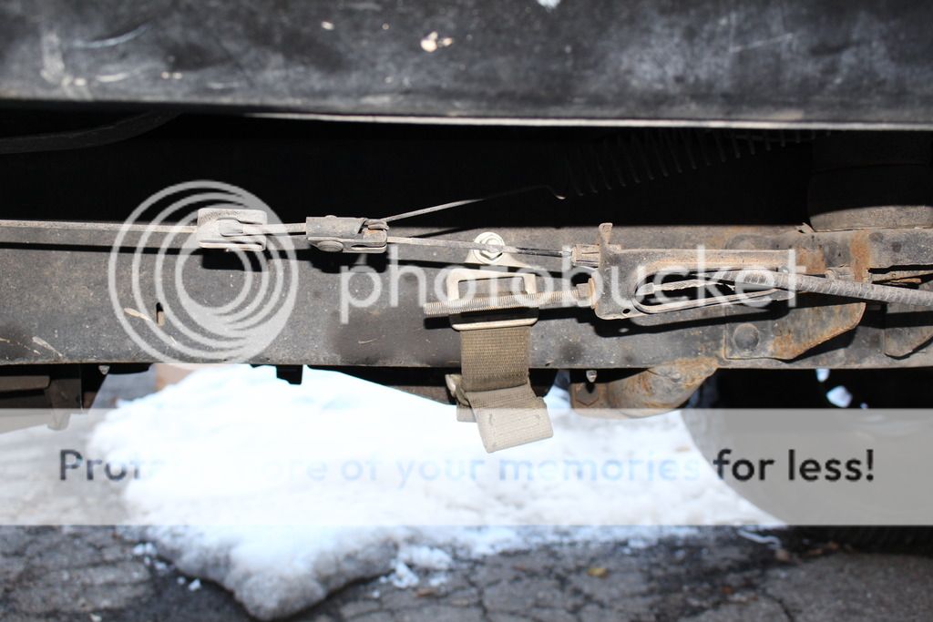

what is this strap for? it is bolted to the transfer case.

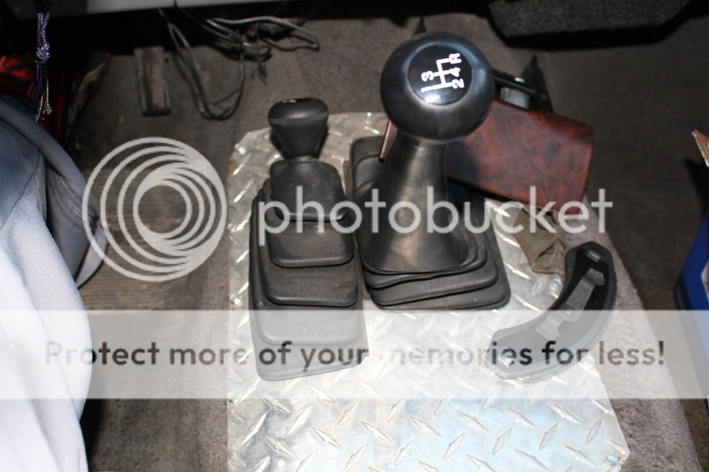

Here's the tansfer case shifter, i need to figure out how he has it set up so i can acutally use the 4wd. It doesn't follow the pattern on top of the knob

I'd be curious to know just what transmission was used... seems odd that it's a 4-speed manual unless that's just the knob he used and it really does have o/d. If it's a non-RBV transmission, then that would likely explain why the speedo cable isn't long enough and the transfer case shifter doesn't work right.

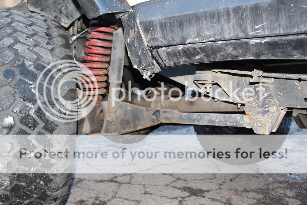

85 there is no body lift that's just with it pushed all the way forward. I'll have to get under and take pics and look for markings on both the transmission and the transfer case. But I am curious what he used, if not a rbv transmission.

I think I am seeing spacers between the body mount bushings and the body mounts and the frame is sticking down about enough...

Nice spot. I haven't had that much time to tinker around with it. I wonder if the PO did that to help with the 4.0 swap. This afternoon I am finally going to have more time to look into the transfercase, but my question is what kind of things am I looking for? What's the best way to problem solve this?

If you do a bodylift it will suck the 4wd lever down into the floor like that. You may also run out of travel and need to enlarge the slot in the floor so it will move enough.
There are also two different t-case linkages. Whoever did the swap may have cobbed one to work on another trans/tcase.
http://www.therangerstation.com/tech_library/ManualTransmission.shtml
http://www.therangerstation.com/forums/showthread.php?t=103015&highlight=c5+pic+request&page=2
There is pics of transmixers in the first link, my guess is it is a TK4 if it really is a 4spd. If so it would use the same shorter 4wd lever that my C5 uses in the second link. Check out the little lever on the t-case also. I recap my 4wd shifter adventure on the last page.
