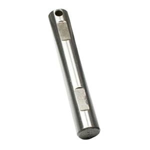

So here is what's going on.
I can't believe that the broke broke off inside the pin, but it did.
There is no bolt threading left at all, in fact it's much deeper than that. (New bolt in pic).
How far inside it goes.
How far inside the old bolt is.
Thing is...I don't see why the pin needs to be removed, as one can still access the clips.
So far, the clips have been a pita to take out.
The pinion shaft is scored all to hell, which leaves me to think that the bolt is bent.
Someone drove on it with a hammer and punch to try to break the bolt.

After looking it over some more...
The shaft is probably toast since it looks like it has been beat on with a hammer 10,000 times.
I wonder if I get a good, and I mean good drill bit..
If I could drill the shaft out to where the bolt is?
As you can see from this photo, the hole is not that deep on the shaft.
