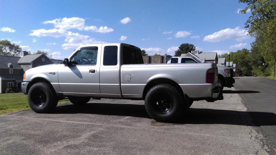

I brought the truck into a different tech that works in a bldg right next to where I work, and while he was inspecting it, we both noticed that the left rear leaf spring is broke, and incorrectly aligned, which prompts me to believe that all of the vibration I'm feeling is just poor pinion angle, probably attributed to broken/worn suspension parts.. The leaf springs that I ended up getting were junk, so I'm glad I didn't spend much on them.. Going to look at another set today, and then hopefully sometime next week the new rear axle will go in!!
I cranked the torsion bars to 2", once the truck settled, it gave me about 1.5" over stock, and so I put the 31's on, and started noticing a little rumble up front.. Part of me is thinking it's the tires, since it didn't do it that bad with the other tires I had, but I did have a little bit of a moan/rumble coming from the front left..
Also, the 2 Moog tie-rod ends that I put on; BOTH of their boots have torn, and it's been less than 2 months.. I haven't taken the truck off-road yet, however with this past winter being as bad as it was, I've coined the term "urban off-roading" because of the severity of the potholes around here!!

I'm almost thinking you may be right, well, at least so far with their boots and bushings haven't really held up all that well.. I STILL don't have the new axle in, but it's allegedly going in tomorrow, but I won't get it back until Wednesday of next week, since I'm going to be outta town.
I ended up buying new straight brake lines and bent up one of the sides.. It doesn't look tooooo bad, but not perfect.. I don't really care, as I doubt I was getting the old lines off of the old wheel cylinders.. I didn't really care though, as I bought new wheel cylinders, a new rear line, new metal lines and new drum hardware. I wire-wheeled the rear axle and used this stuff called "Corroseal" to see if I can get rid of some of the corrosion. I'm hoping to paint it tonight, and get it in the truck with minimal damage..
Also, in my pursuit of trying to determine the new rumble, came to the realization that when you buy tires/wheels from somewhere online, it's probably best to check the air pressure before putting them on the vehicle. All 4 tires were at or over 75lbs!!!! WTF?!? Thankfully, I only drove on them for a day or 2 before I couldn't take the bumpsteer anymore.. Plus, people were saying that with cranked torsion bars, the ride stiffened up a little, but this was spine-cracking!!! I've had racing suspensions in a couple of my former vehicles, and this was by far, WORSE!!! I dropped them down to 40lbs, and they ride great.. BFG says they should be at 35lbs, so I think I'm a little better than I was, 35lbs later!!
