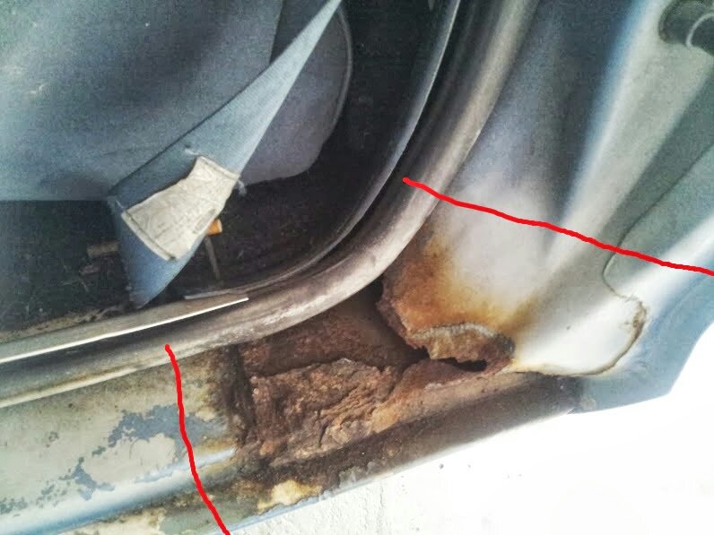

How are you dealing with the door jambs?
I haven't been able to find the pieces I need to fix mine.

Mine is rotted out as shown, except it has a hole all the way through now. uploadfromtaptalk1408374472702.jpg
Luckily an awesome member on here had what i needed and chopped it out.
Its probably the only way to go unless you wanted to use metal mesh and bondo... Thats something the idiots before have all over my truck. Im making a build thread now so if you swing by sometime in the near future, you'll see the boulder of bondo coming out of my rear fenders. Literally a few inches thick..I'm doing my best to avoid bondo unless I'm skimming.

Yup, that is exactly what mine needs (not that bad though)
I wish LMC or somebody would get on the ball and make that piece. EVERY Ranger I have looked at in the JY is the same if not worse than mine so it must be pretty common.
