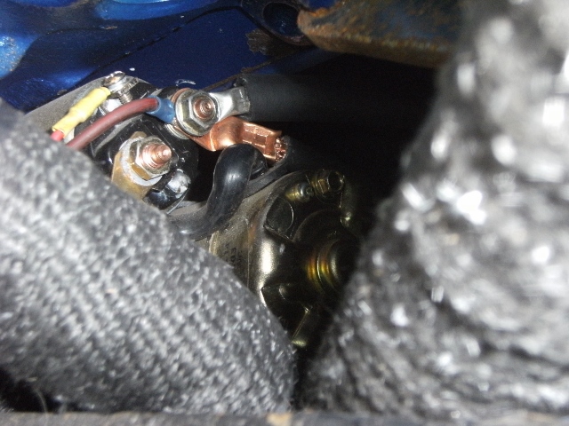

2nd pic is starter

didn't get a chance to look into this yesterday, hopefully next day or 2. will update as it is figured out. your opinion on how I have the starter post? will it be safe?
cheers
8,370
I guess it will be safe enough
But I would use fender mounted Power Post, one reason is with Remote battery mounting "jump starting" can be an issue, you never know when you might need it or a friend might need your help, :)
With the power post you have a "battery terminal" in the engine bay, and ground would be engine, for starter motor or alternator AMPs
