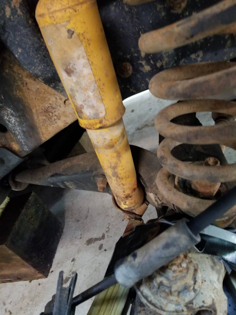

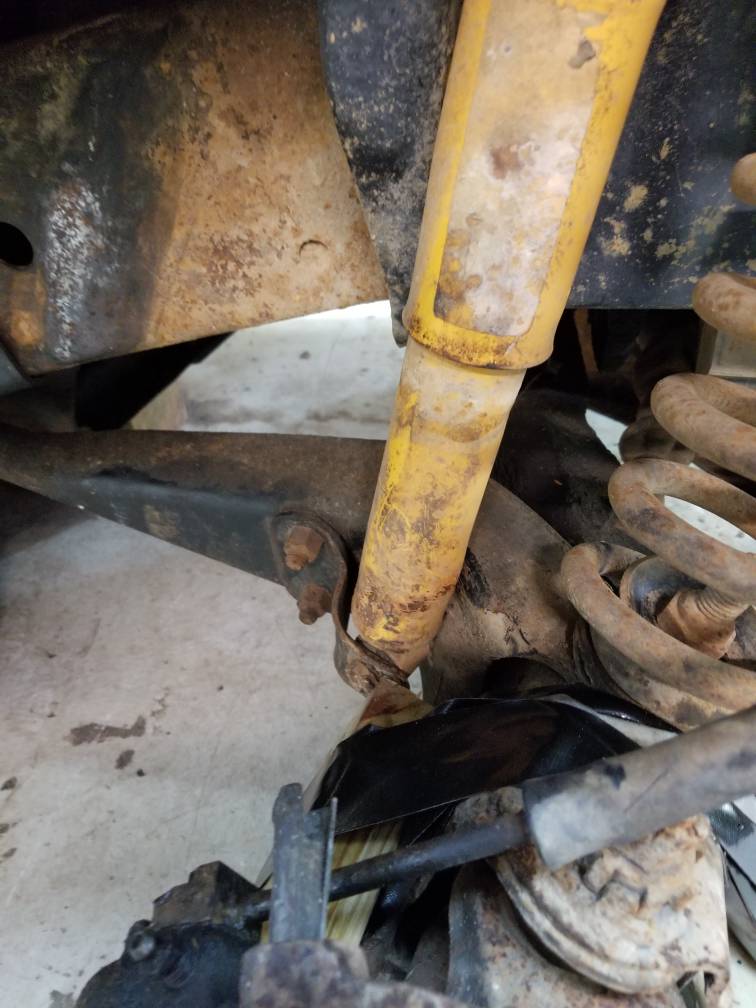

Recently came into possession of an 87 BII. It's a 2.9l manual trans 4x4. Everything from the windows to the door locks are manual as well. Seems to be the perfect base for a project. Only problem, it's been in a wreck. Front passenger side is pretty banged up. Current plans are a d35/8.8 swap and a lift. Gonna look for 4.10 axles. Haven't been to any junkyards yet, started the front end pulling today, didn't get a whole lot done though.
Here's a few pics of the damage.

Made a little progress so far. Sway bar is off and one shock nut is off... I over estimated the power of an impact gun. Air isn't an option so I'm using an electric, but every bolt I come across has to be started by hand, which is annoying.

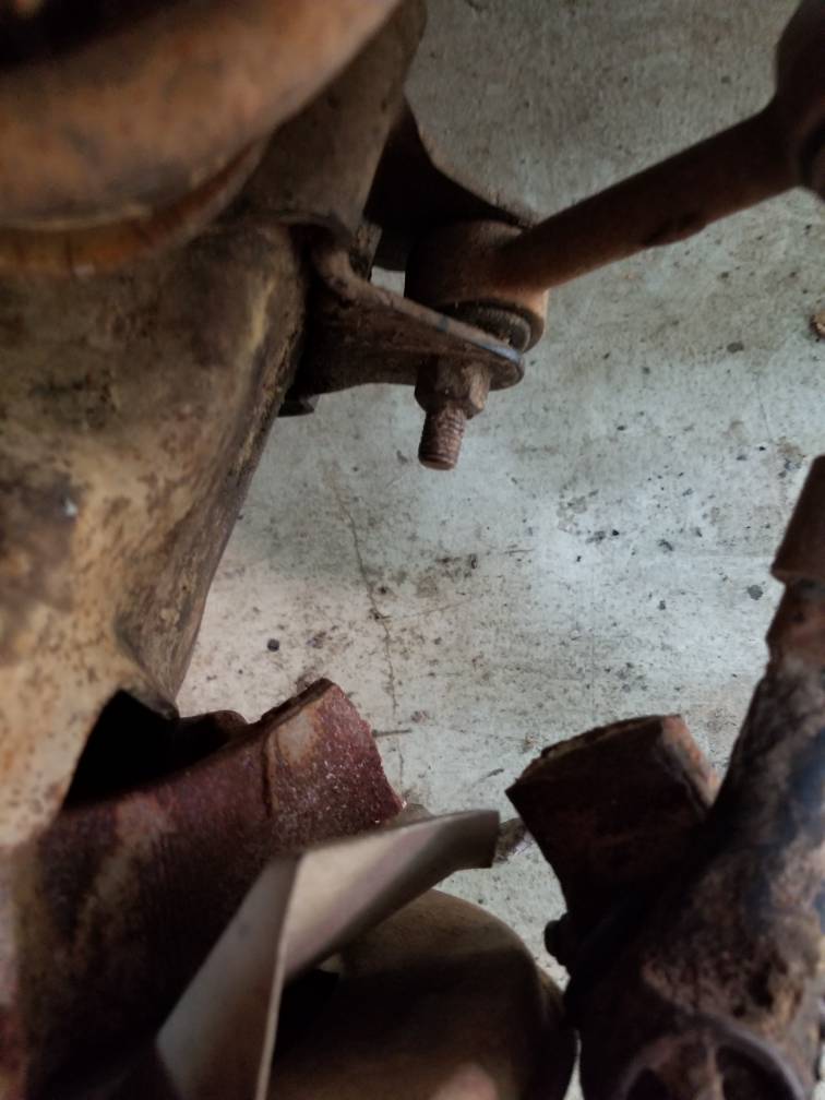

Went out today, got the other shock nut off. Also got the drive shaft separated from the diff, then got one radius arm bolt off. Gonna have an issue with the other radius arm, though. When it wrecked, the radius arm got pushed back and turned the cross member into a curly fry. Won't be able to get the bolt off so I'll have to cut it off. After that, I'll have the pitman arm and then the bolts above the diff that hold it to the bracket/frame (what are those called?). Thanks for reading.
