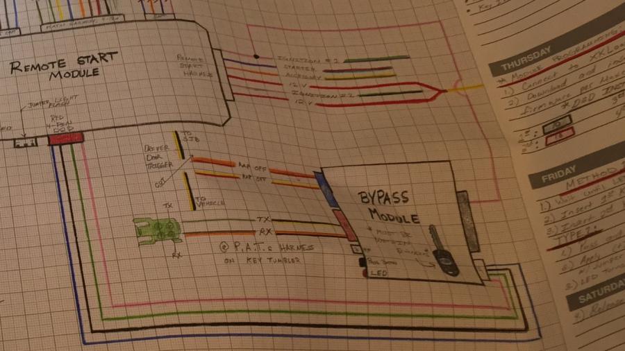

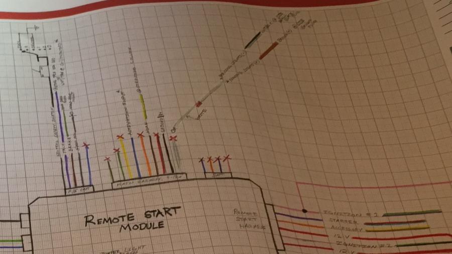

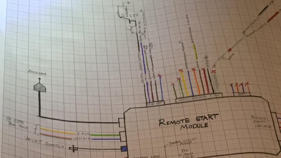

Hello All, first post here. I've been working on installing a 1-way remote starter in my 2004 (XLT/4.0/4x4). I have followed directions and rewired it multiple times but never any success. Here's what I have now, maybe a fresh set of eyes will see something I don't. Also, as of last night, something shorted out at the ignition harness (i saw the spark) and now neither the R/S module nor the Bypass Module will get any power. Multimeter shows 12V and when I test voltage on the purple starter wire the voltage just keeps increasing indefinitely. Also, it appears that the key in ignition chime isn't working following aforementioned spark.

I will list all connections below. I have also attached pictures of a diagram I drew to help assembly everything. Please feel free to ask questions.

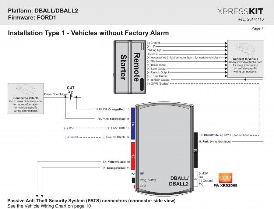

-[DBALL2 BYPASS MODULE]-
BLUE, 14-PIN:
10- ORANGE/RED--RAP OFF--driver door trigger (yellow/black) @ SJB
11- YELLOW/RED--RAP OFF--driver door trigger (yellow/black) @ SJB
*YELLOW/BLACK DRIVER DOOR TRIGGER CUT BETWEEN TWO SPLICES*
RED, 12-PIN:
10- YELLOW/BLACK--TX--spliced into white/lt green (PATS) at PCM
11- ORANGE/BLACK--RX--spliced into orange/grey (PATS) at PCM
BLACK, 10-PIN:
9- PINK(+)--IGNITION INPUT--spliced into pink primary ignition wire at 6-pin harness on R/S
WHITE, 4-PIN:
*D2D HARNESS CONNECTED TO R/S*
I have probably spent close to 40-hours working on this install. While this is my first remote starter install, automotive electrical is not something new for me. I sincerely thought this would be easy, but boy was I wrong. i'm determined to complete this install by myself. I'm not eager to have Best Buy install it, but it's looking like that is my only option at this point.
Thank you for taking the time to read this thread and consider my situation. Any input, suggestions, comments, or advice is greatly appreciated.
