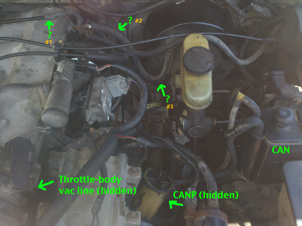

Immediate loss of fuel pressure - Like as soon as you turn the key off, it drops to 5 psi almost immediately, and then trickles down to 0. 30-32 psi at idle, and 45 or 48psi (can't remember) if you unplug the vacuum hose from the regulator. I had thought it was the check valve in the fuel pump, since the fuel pressure regulator is working right and i can't smell any gas in the vacuum line, but I still lose fuel pressure. Upon further inspection, it looks like i do have a small leak in one of the fuel lines - not sure how to replace/fix it though. (see below picture)
(Ignore the text, I stole the first image I could find off google for approximately the right area) Pretty much right in this area here, just a little further down in the engine compartment. It's a braided steel hose into a hard steel line, and looks like its leaking right at the connection. How do i fix this? Do i just have to replace the whole line?
I've found a vacuum hose unplugged under the throttle body, and I traced it back to the carbon canister. I have absolutely no idea where it goes though, I can't see any connections where it would go.
