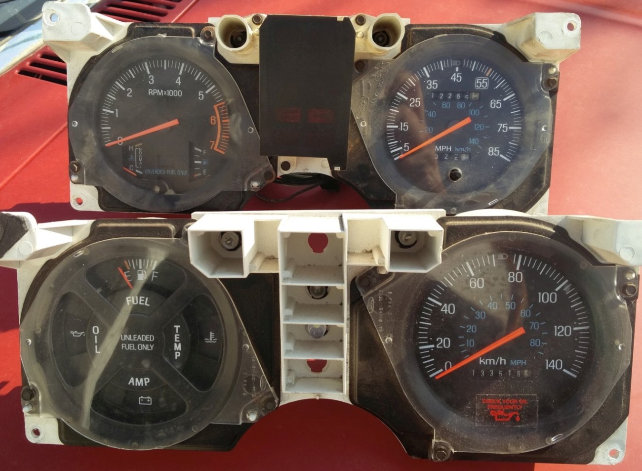

If the speedometer can be swapped, that's workable. I can buy the junkyard whole cluster, swap the speedometer (it is MPH, I need KMH, plus my odometer), then that should be more or less usable.
I don't want anything to do with the message center though. My cluster surround trim is the silver finish, not the woodgrain, and I'm not interested in swapping that out at all. I'll take apart the junkyard cluster in the yard and see what I can figure out before I'm out the $$ for it.

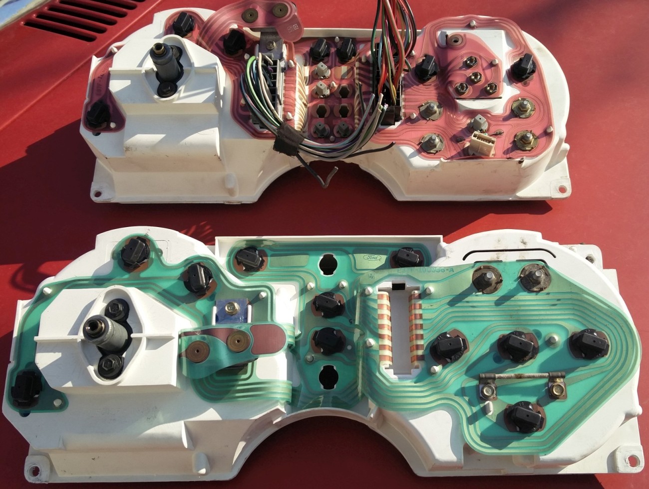

I can see that the "message center" is a removable module held in with screws, so presumably (oh I hope) I can move my warning light cluster (the 4 individual lights) from my cluster into the 88 cluster, swap my speedometer into it, screw around with the pinouts to get it to match, and then have the result I'm aiming for (solving question 1).

I went and picked up the cluster.
Unfortunately, there is no viable way to retain the dash bezel with the 4 warning lights, short of cutting the clusters apart and melting them back together the way I want them.
I will have to find a truck that can give me the bezel I need in the colour I want (silver, not woodgrain). I prefer the look of the 4 indicators separated but I'm sure I'll stop crying about it eventually.

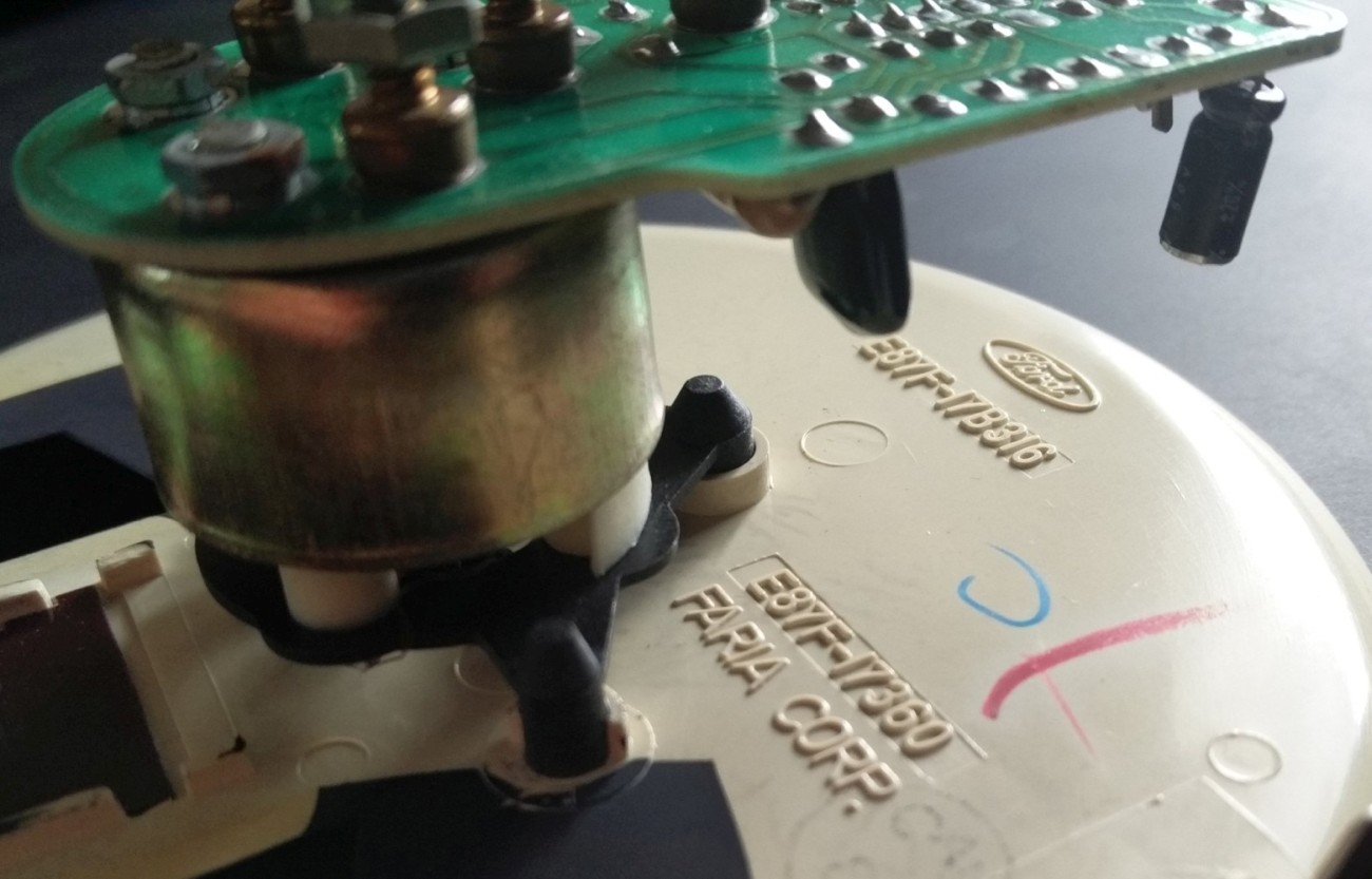

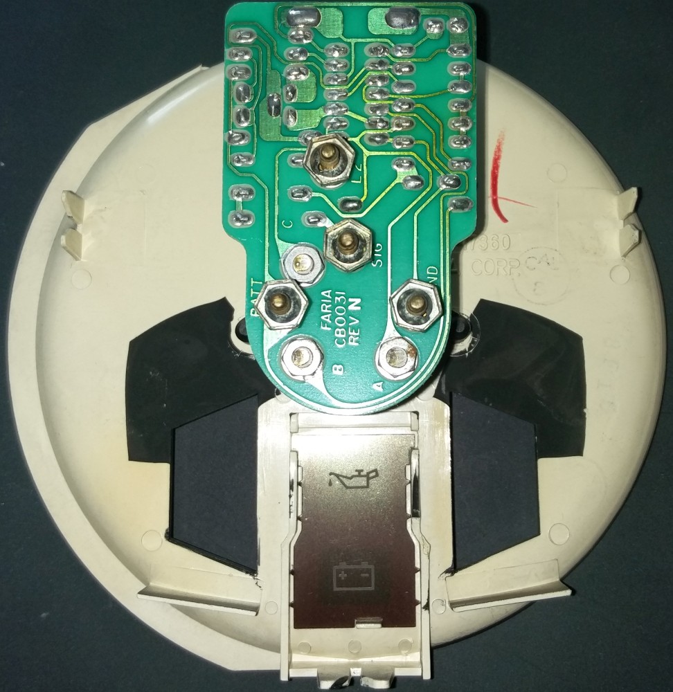

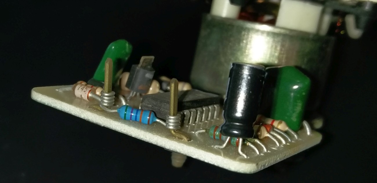

-Pulled tach out of new cluster. Found a resistor tightly wound around two posts on the PCB of the tach. The value of that resistor is how you change how the tach displays the signal it receives. Potentiometer to fine-tune it might be the way to go if there isn't a known list of values somewhere.

The resistor is neatly wound around the posts like a factory job, and it's a different value than the one in my other tach. I haven't hit either one with an ohmmeter yet but I can see clear as day that the bands are different colours. Otherwise the tach looks to be the same. I'm assuming the "ground or not" decision for the extra contact peg is done by a wire being present or not in the harness.

Playing with the resistance makes it read right at a certain RPM, its accuracy will degrade as it leaves that RPM.
