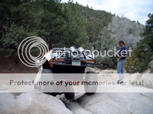

This upcoming summer I am planning a 2-3 month frame-up build with my 87 2.9L V6 Single Cab Short Bed Ranger. Wanted to throw out my imagined build and see if anyone had any suggestions or ideas to help in my planning.
Goal: Clean and built to last and function reliably on pavement and weekend medium duty off-roading to get to remote camping/dirt bike spots. I'm 70% street, 30% off-road every month so this is by no means a dedicated off-road truck.
Engine: Keeping the 2.9L V6 recently rebuilt. enough power for what I need. Maybe beef my powersteering up a bit? with those 35s it wouldnt hurt.
Transmission/Transfer Case: New rebuilt 5 speed manual to go in, new rebuilt transfer case to go in (new rear drive shaft..kinda sheered half the splines off...)
Rims/Tires: 15x10 rims 35x12.5 R15 Tires (Km2s are my favorite, we'll see if i can find a set of 5...)
Lift/Suspension: Existing 4inch? 6inch? skyjacker lift new shocks all around. will need to correct the camber on the TTB for the new wheels and tires
Axles/Difs/Hubs: Rebuild on both axles. Existing D35 TTB front, install a Ford 8.8 Rear both geared 4.10? for the 35s. most likely a selectable locker on the rear, don't want to waste much money on the weaker d35 but maybe a lunch box locker and be careful to not blow it up but doubt I would ever really need a locked front... right hub is shot, new heavy duty jeep/warn hub lockers. maybe d44 front knuckles?
Frame/Body: Frame repaint, undercoat. Cab inside black bedliner. exterior truck grey bedliner. truck bed black liner. bushwacker cut fender flares. Custom bumpers front and rear (rear with swingout tire and jerry can carrier)
Brainstorming on some custom racks and boxes but those are just details. So that is the rough general idea. Let me know what you guys think! The good and the bad lay it on me . Some Pics as it sits at the moment.
