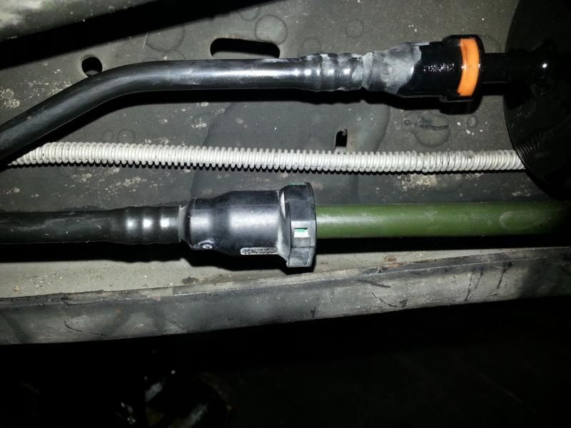

My solution was to purchase a pre-made 3/8" metal push on from Autozone and a couple 5/16" nylon fuel line couplers.
Cut a couple inches off one end and silver soldered it to the hard stainless return line from the 5.0. A 3/8" to 5/16" compression union would work.
Cut both the nylon lines between the Ranger fuel filter and fuel tank. Used fuel rated 5/16" press in couplers to swap the two ends.
Plug the larger end onto the 3/8" push on, plug the smaller one onto an Explorer fuel filter and you're done. -- Only thing left is to pop the FPR off of the fuel pump assembly in the tank.

OOPS! Just realized you're going even older than I'd thought.
Still, consider using compression fittings or heck, get a double flaring tool and use flare fittings with unions for the fuel lines.

You can buy both the 3/8 & 5/16 metal line repair pieces at the local auto parts house. They'll plug into the oem quick connects and then you're simply looking at metal to metal joints.
Any chance you can find a set of Explorer hard fuel lines at a breakers yard? A bit of re-shaping and you'd have most of your fuel line issues resolved.
