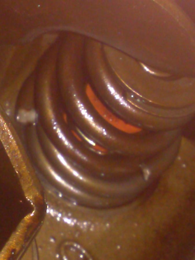

Haven't gotten very far yet, but did get the intake manifold off, and the driverside rocker cover off, the rocker closest to the cab has a ton of play in it.
Just double checked, and the spring on that rod is broken. Could that possibly be my only issue?
Well, I don't want to speculate. I'll just tell you what to do next.
You need to get air on that cylinder through the plug hole to hold the valves up. As I said before, many compression testers have an air coupler on them for this purpose. To work on a valve with the head still on the engine you need to be able to use air to hold the valve closed. Once you get the air on there, you need to turn the engine to close the valves and pull the stem up on the broken-spring valve. Hopefully it didn't fall in there.
Not being there sux for trying to figure it out. A valve spring breaking on a low-power engine like this is fantastically improbable. Can you take pictures and post them before you touch it? If it is just a broken spring, and the valve still seals, then it is an easy fix if you can get air to hold it up and can find a spring compressor to install a new spring with. But I want to see what you are seeing so get us a picture.

Yeah I was pretty confused for a minute. I'll get a picture of it uploaded first thing in the morning, didn't take a picture of it before I left my truck. Also will see about renting or purchasing a compression test kit of my own tomorrow morning and seeing if I can figure that thing out before I go taking that head off...how do I go about turning the engine to close the valves? Sorry still learning.

driver's side, closest to the cab is your #6...I wouldn't be surprised if the broken spring is the only problem, but like Will said: hopefully the valve didn't drop in and was held up by the broken spring.
if the valve does drop in, you might still be able to pull it back up using a small telescopic magnet. I had a valve drop once (was using air to keep it closed) and managed to pull it back with the magnet.
