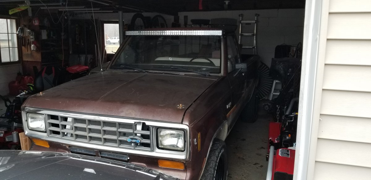

So finally got some free time to upload some images. And had to figure out how! haha
So this is first year i bought the truck, drove it up to MI from Kentucky, this is just after I put new tires on it.
Rebuilt original 2.8L about 2 years ago, had C3 trans rebuilt abut 6 months later.

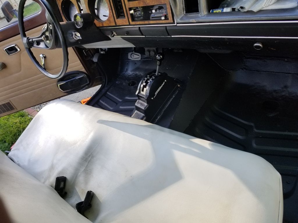

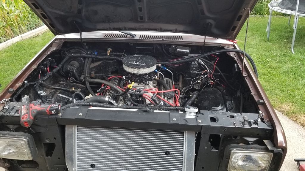

Its been a while, but I have gotten a lot of work done on the truck. Engine and Trans are in. Rear axle is out. I ended up getting some 3/16 Stainless steel for the motor mounts. It fit quite nice on the stock v6 mounts.
I painted the engine compartment with por15 and then rattle can over it. Came out decent.
benhojnowski
Feb 9, 2017
Detroit MI Area
351W
At this point I got real worried about fitment issues. But it fit.
Still working on the plug wires and waiting on the Holley Sniper Efi which seems to get pushed back more and more every time I check the status. :sad: Trans is in Also, and what a pain in the ass it was.
More to come hopefully sooner. Should be putting a body lift on tomorrow and working on the floor. After getting the trans in I realized a body lift was a must do. I wanted to keep the truck low as possible but the trans is just way to big. It would force me to have no foot room while driving to keep it the stock height. so body lift and lowest floor I can squeeze in. This is gonna be my daily driver so I want it to be comfortable. I still have not figured out headers. A fab shop by me quoted $1700 to have them made.:thefinger: I told him he was crazy. So I will probably end up making my own. I've seen header weld up kits on speedway motors for around $150.
