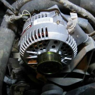

Did the 3g upgrade to mine. Used the harness and alternator out of a 1995 Windstar. Easy as hell to do. With three massive fans (I'm NOT popping a head, damnit), stereo, inverter, etc. I still.havent found bottom.
