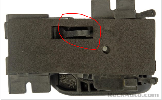

For the inside door latch it needs to be from a 1991-1989 model, the back should look like below.
25613

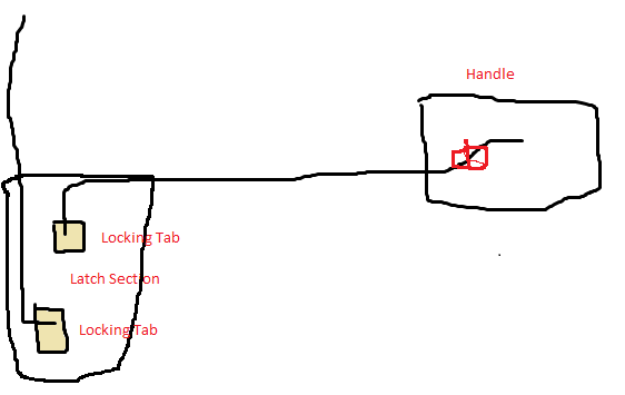

You will also need the corresponding latch for the rods. Below is a crude drawing of how it should hook up. You will need to rotate the interior handle 90 degrees or vertical to feed the rod end into it. The locking tabs should slide off and on the rods with a flick of your finger.
25614
Again, this is all from memory, but I have done several handles and locks over the years and on different models of Fords and they are all mostly the same.
I hope this helps, Someone correct me if I am wrong.
