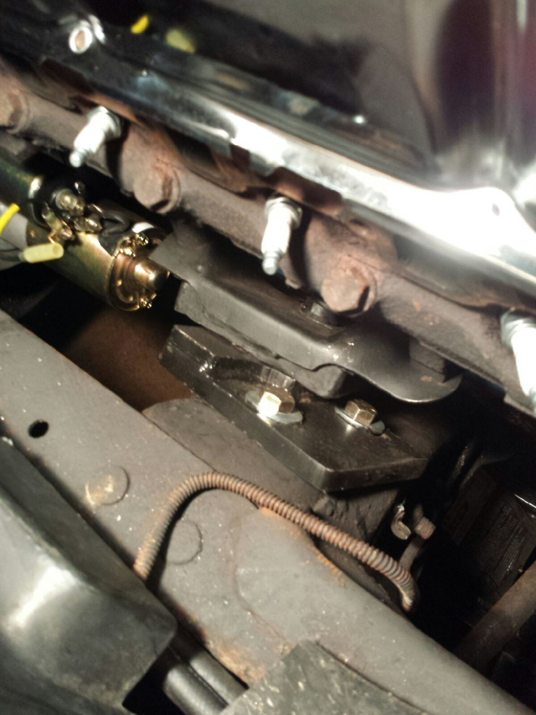

32,318
17,774
Cut the slots too deep in the engine crossmember for 5.0 convert mounts - use 4.0 mounts and plates in stock holes.

The holes cut in the subframe for the Mustang mounts . . don't have to be perfect. You need them correct, from to back as to where they are. But the length of the slot isn't as important as the engine will locate itself if you fuss with it some. Then tighten it down.
32,318
17,774
And then as the engine runs it settles down, I have pulled it back up once, I am making a shim for the second time. I get it as tight as I can but the torque of the engine makes it roll to one side over time.

Mine has sunk almost 2 inches down (and looks to have stopped) because the slots are to long so I'm going to have to raise it back up.

I don't believe with proper hardware this will happen. It certainly hasn't happened with mine.
