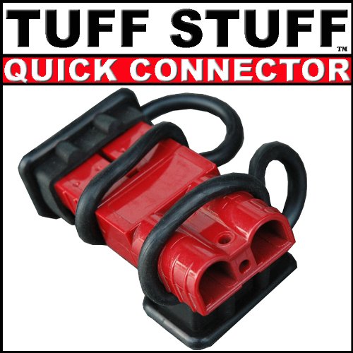

Ok checked it out and yea looks like he did almost the same thing I was thinking of doing sweet but I think i'd rather run quick connects front and rear like these for a winch later or maybe jumper cables that i can make.

I used an Optima Chevy (side post) battery in the rear. I also added remote terminals and a quick disconnect like the one you are showing above.... But the battery itself is tied into the system via 4ga wire from the always hot starter stud.
