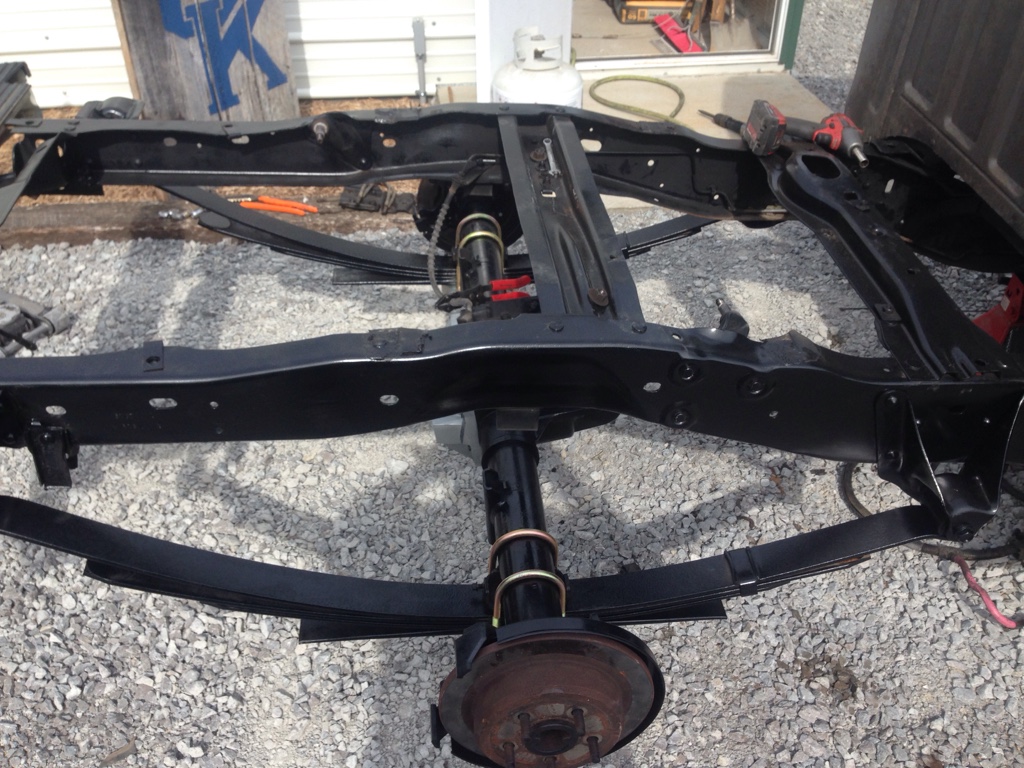

Sanding and painting most of frame today and starting on the wire harness.

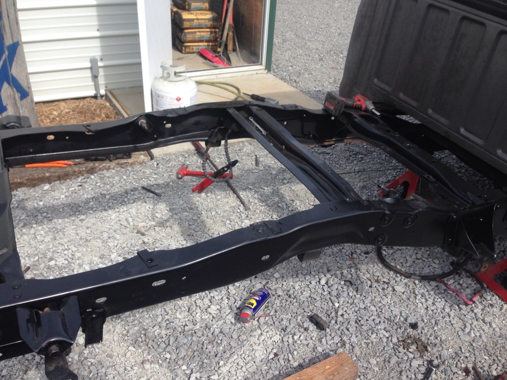

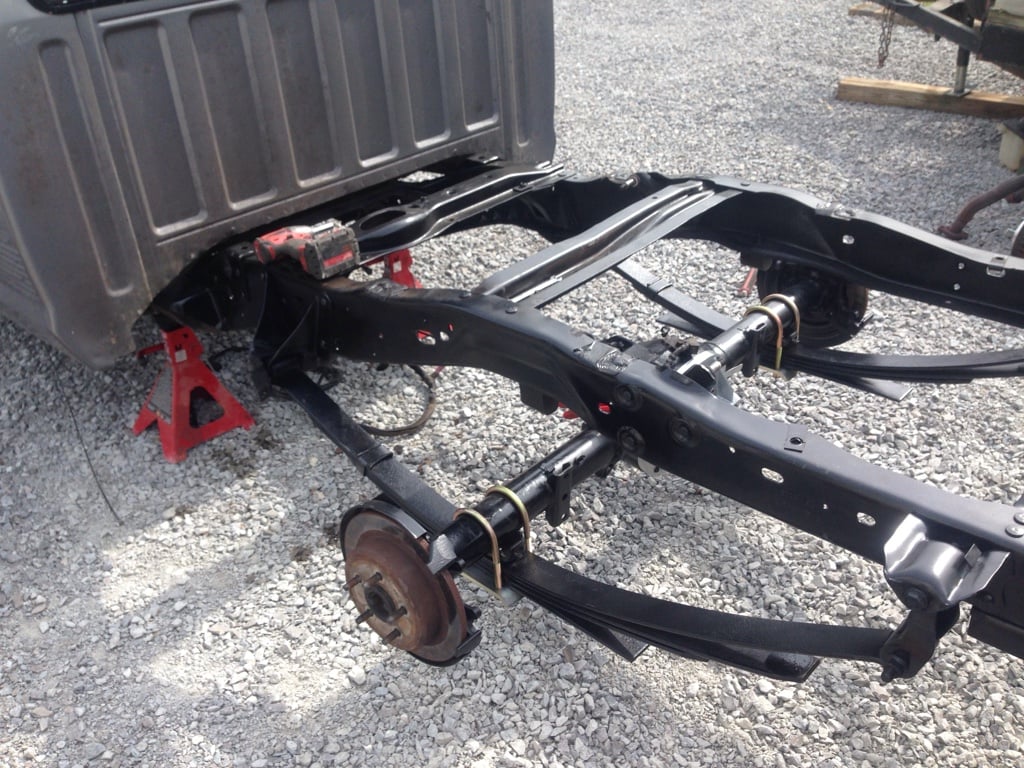

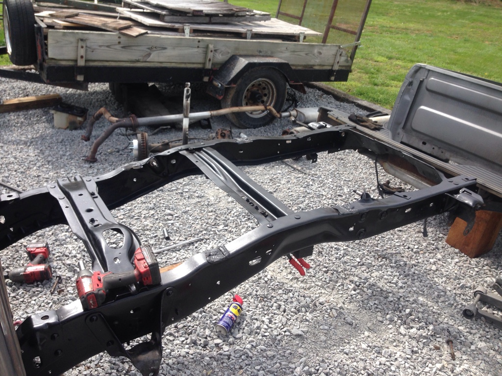

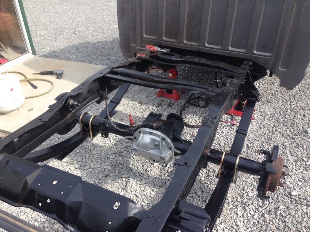

So I pulled all the wiring and ac box to prep the engine bay today. I also pulled the tank, fuel lines and harness from the rear to clean and paint the rear of the frame.
So the next thing I'm going to do is run my fuel lines and electric fuel pump. I know I want to go with a fuel pump & regulator set up and delete my in tank pump but wasn't sure what pickup to use. If someone has an idea I would gladly appreciate it. Most likely going with the Holley blue pump/reg with stainless braided lines and AN fittings.
