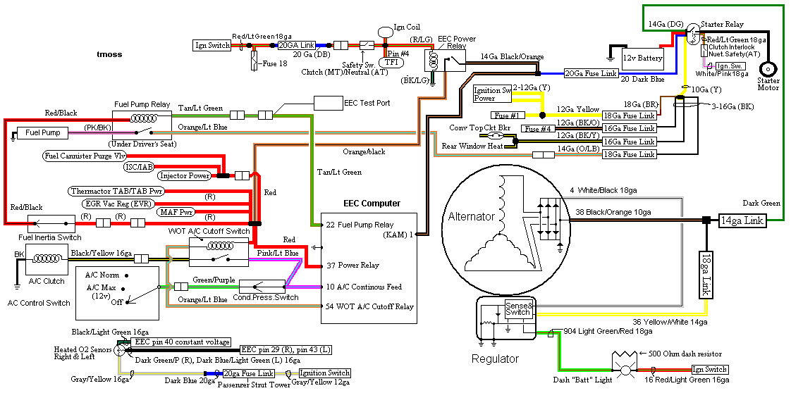

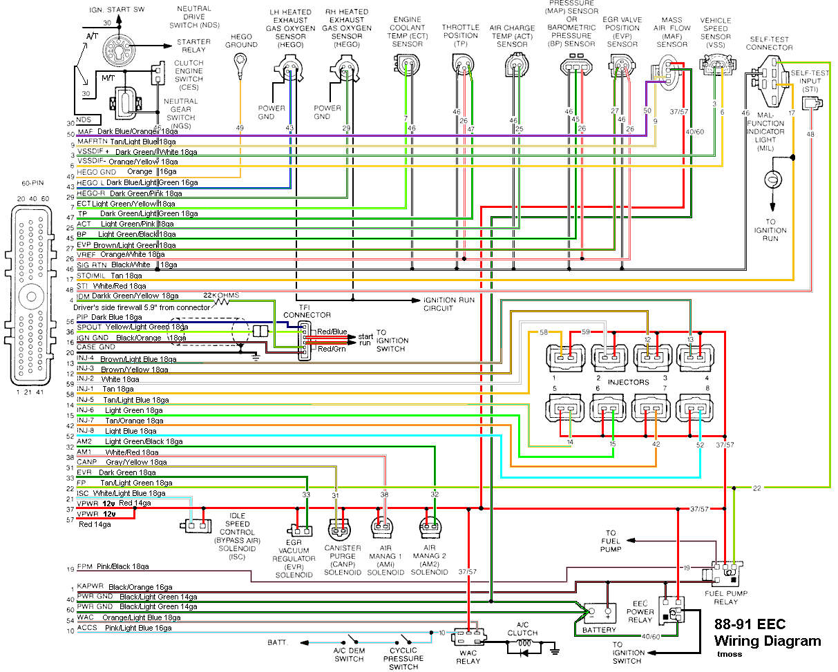

In one of the guides i'm told to connect the Green / Yellow wire (from Plug1) to the intertia switch's Orange / Blue wire. My Inertia switch has two wires, Orange / Blue AND Pink / Black. These two wires go from the intertia switch into the engine bay and end in the form of a 2 pin connector, but This connector is not connected to anything.
I tried it anyways. Side note Voltage reading is 6volts @ intertia switch wire which is connected to mustang green 8 pin harness
Now im trying to connect the Pink / Black wire coming out of the interia switch to where it needs to go (provide (+) voltage to fuel pump??). Did everyone have to do this?
Does anyone know which wire in the Ranger plug (driver side brake booster, 8 pin square) which is the fuel pump (+)?
Using the following for reference. The intertia switch seems to be in two different places in each diagram.
PIN 37/57 goes thru the intertia switch first - then the fuel pump relay here
PIN 37/57 Goes straight to Fuel Pump Relay here

My book, a Haynes, is showing:
Fuel Pump relay -> Dark Green/Yellow -> Inertia switch -> Pink/black -> fuel pump.

I had to to splice the pink / black coming out of the intertia switch over to the ranger main harness, since it was not connected (utilized old motor harness to get there) Then from the main ranger harness, it goes in the cabin (fusebox im guessing?), then back out into a harness going down to the frame. Well at that point the fuel pink / black wire was disconnected.
Fuel Pump Relay (once activated) comes out Dark Green / Yellow.
Dark Green Yellow then gets split two ways. 1 goes to EEC PIN 19 (Fuel Pump Monitor) then the other goes to the Intertia Switch
Pink/Black comes out of intertia switch then over to the fuel pumps (Via ranger main harness, then Chassis Harness)
