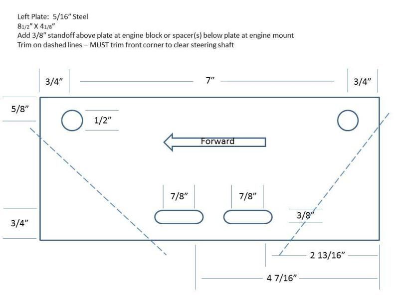

Lastly, you mention a coil spring Ranger and if so, you will need custom plates for the engine block to Ranger engine mounts brackets. Very possible to make your own out of flat steel (no easy cutting, drilling and slotting 5/16" steel, but possible).
If it's a torsion bar front suspension, then the Expo 5.0 mounting plates drop in.

Honestly, the '96/97 Expo/Mounty's make just about the best doner.
No PATS, a usable speed signal and in your case, plug and play fuel supply system.
Buying a complete doner makes the most sense. Odds and ends like accelerator and cruise cables, a/c hoses, trans cooler lines, radiator and such along with the rear axle are all "good things" to have handy.
If you need to make the plates:

post pics!
I will as soon as I get it.. As of right now, I'm gathering parts and info on everything I need.. going to be a minute or two before anything starts coming together. Then it will be an EFI 331 5 speed on the bottle ranger!:icon_hornsup:
