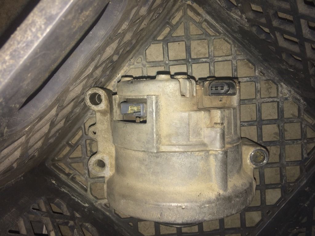

I would love to install an over the counter 130 amp or 110 amp or something alternator from a later explorer. It looks like they would bolt right in but the wiring is different.
Can anyone tell me if there is another alternator that will work without mods or how I can mod the wiring? Here is what the plug looks like.
The black one will fit perfect, but the grey won't. The other plug doesn't at all. I have searched and come up with nothing.

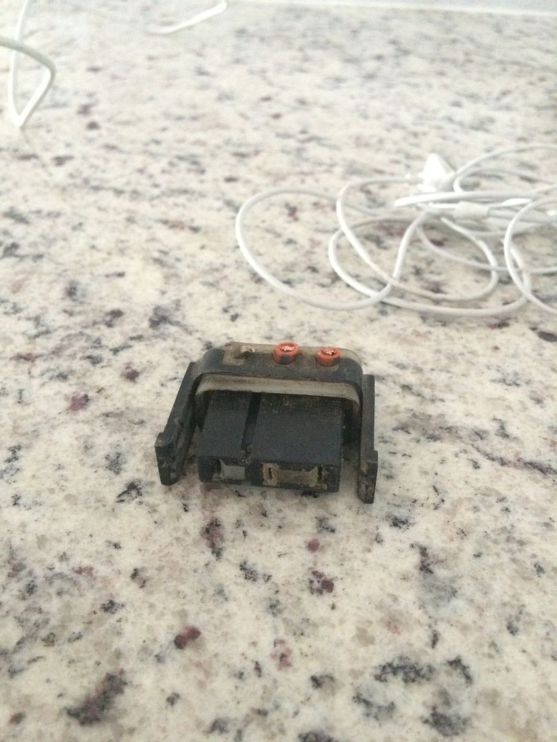

Next, I removed the bigger 3 wire plug:

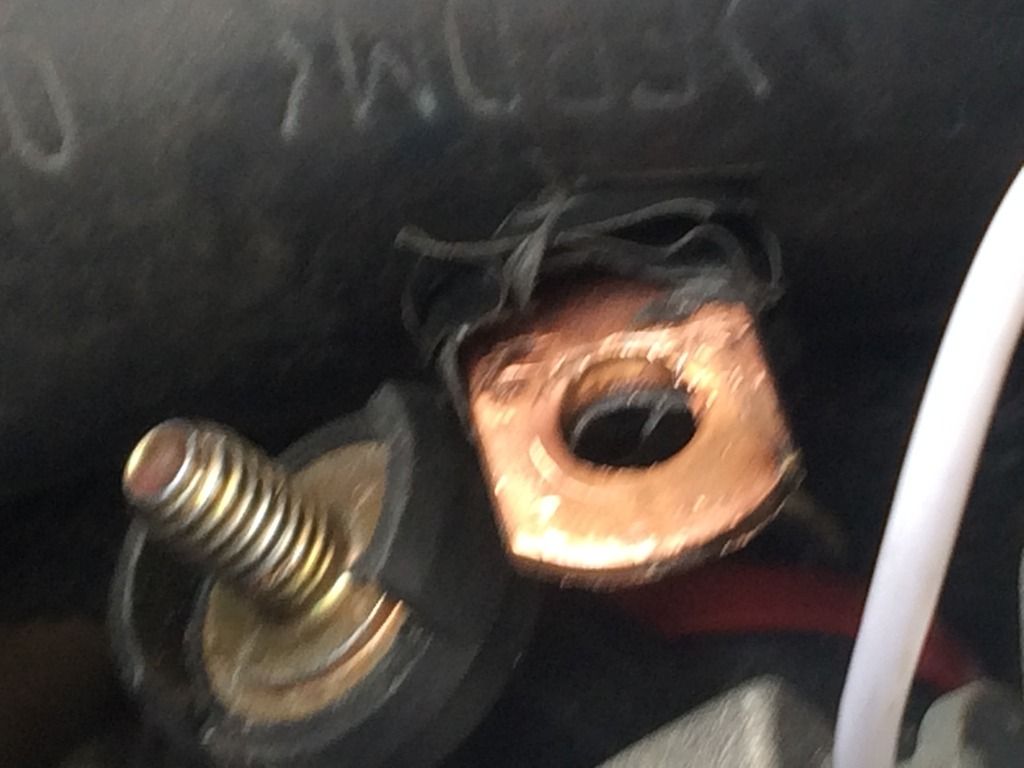

Next I added a terminal to the two red wires out of the plug. 2 wires to the one terminal. I used a copper end and soldiered it. Then shrunk wrapped it.
This fits on the post of the new alternator.

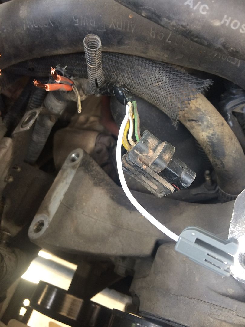

I didn't do anything with the other wire. The rebuilder said it was not needed? I suspect it is for the idiot light, but the idiot light did not come on.
Next I picked up this little plug (these can be purchased at you local auto parts store, I got it at the alternator place) and spliced it into the middle (white with black stripe) in the other plug.
Plugged everything in and boom! I got a cheap 130 amp alternator.
